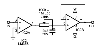

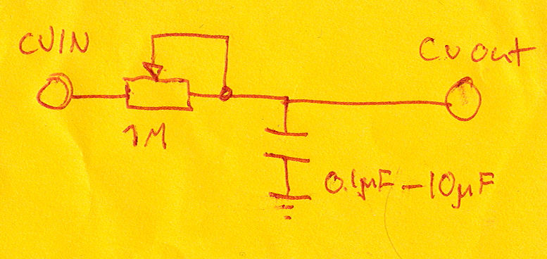

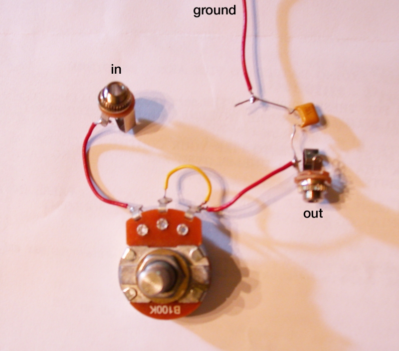

Someone gave me the following schematic for a simple glide circuit.
Should this work?
I tried it and found that while it does add some Lag to a CV signal, it also attenuates it.
I'm using a 100k pot and a 1uF cap just because that's what I had lying around so there's not much lag effect.
I've also attached an image of my attempt to test it.
Any ideas?
 Filesize:  424.11 KB
 Viewed:  680 Time(s)
 Filesize:  300.2 KB
 Viewed:  589 Time(s)
Tim Servo
Joined: Jul 16, 2006
Posts: 924
Location: Silicon Valley
PostPosted: Tue Jun 30, 2009 4:03 pm    Post subject: Simple Glide/Slew/Lag/Portamento... Reply with quote  Mark this post and the followings unread
Hey JD,
Well, that circuit is really close. What you need to do is add an op-amp buffer to the input, and another one to the output. The idea behind the buffers is that they isolate the circuit. Otherwise, the load that the glide circuit places on your CV source changes a lot depending on what the glide setting is.
What you're looking for is a "voltage follower" or "unity gain buffer." The circuits are REALLY simple, and you can get a single 8-pin IC that contains the two op-amps you'll need. Of course, you're going to need a power supply, but that's something you'll need for almost any synth circuit. Do a Google search for those buffers and I bet you'll find a ton of useful info.
Tim (sometimes useful) Servo

I'm not sure how you have your jacks grounded but they don't look like they have wires tied to ground. Don't forget those!

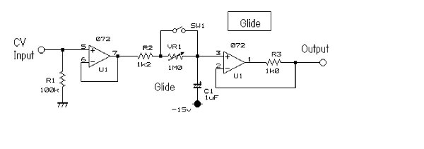

PostPosted: Tue Jun 30, 2009 6:58 pm    Post subject: Reply with quote  Mark this post and the followings unread
ok, thanks,.

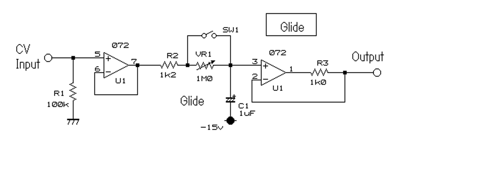

I think I'm going to go with the glide circuit that's attached.
It's taken from Ken Stone's Psycho LFO.
This one makes more sense right?
 Filesize:  27.2 KB
 Viewed:  40117 Time(s)
widdly
Joined: Jun 25, 2007
Posts: 268
Location: singapore
PostPosted: Wed Jul 01, 2009 7:50 am    Post subject: Reply with quote  Mark this post and the followings unread
not quite. The first opamp is non-inverting, and the second opamp is inverting. So you end up with an upside down cv. If you ditch the 100k pot and wire the first opamp like the second you will be in business.
PostPosted: Wed Jul 01, 2009 8:50 am    Post subject: Reply with quote  Mark this post and the followings unread
just the other way around Very Happy
the 1st OpAmp is set as inverting amplifier to enable multiple inputs.
the 2nd OpAmp is set as non-inverting voltage follower.
if you set the 1st like the 2nd, you cannot use multiple inputs (mix). however, i think you are not after mixing multiple inputs anyways.

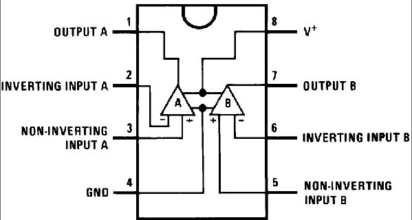

PostPosted: Sat Jul 18, 2009 2:54 pm    Post subject: Reply with quote  Mark this post and the followings unread
I'm having a little trouble getting this to work.
The CV signal I'm feeding it ranges between .5 and 3 volts.
The output from the first op-amp(pin1) is around 10.8V and stays around there for the rest of the path so the output frequency is really high.
I figure there's either something wrong with both of the LM358's I've tried,. or I've most likely made a really dumb mistake with the wiring.
I've attached a picture of the breadboard.
Any suggestions?
 Filesize:  33.88 KB
 Viewed:  39704 Time(s)
 Filesize:  329.93 KB
 Viewed:  523 Time(s)
haxster
Joined: Feb 01, 2006
Posts: 246
PostPosted: Sat Jul 18, 2009 6:23 pm    Post subject: Reply with quote  Mark this post and the followings unread
From looking at the schematic above, you have the inversions wrong. (-)inv should be pin 2, pin 3 is (+)non-inv. Op-amp (B) has the same label error. Also you do not have a freedback resistor or jumper on Op-amp (A).
Tim Servo
Posts: 924
PostPosted: Sat Jul 18, 2009 6:28 pm    Post subject: Simple Glide/Slew/Lag/Portamento.. Reply with quote  Mark this post and the followings unread
Whoops, you've got that first op-amp wired as a comparator. When the input goes just a teeny bit above or below ground, the output will jump between (about) +12 and -12V. No in between for the output of a comparator. If you look at the diagram above, you'll see there's a feedback path on the op amps from the output back to the "-" input. What you want is to have the first op-amp wired as a buffer or "voltage follower."
Tim (just a bit above ground) Servo

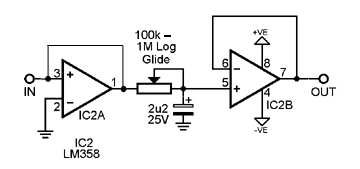

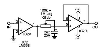

PostPosted: Sat Jul 18, 2009 7:43 pm    Post subject: Reply with quote  Mark this post and the followings unread
Thanks for replying so quickly!
It looks like I forgot to switch the + and - when I switched the numbers on the first op-amp. The second one should already be correct.
So all I'm missing is the feedback jumper.
Which of the following two schematics is right?
Does the jumper always go back to the - or whichever is the input?
 Filesize:  34.67 KB
 Viewed:  39656 Time(s)
 Filesize:  34.96 KB

PostPosted: Sat Jul 18, 2009 7:47 pm    Post subject: Reply with quote  Mark this post and the followings unread
I just noticed that pin 4 is marked as ground on the data sheet.
Should I go by that or does it matter?

PostPosted: Sat Jul 18, 2009 8:42 pm    Post subject: Reply with quote  Mark this post and the followings unread
After some fiddling around I got it working.
I'm using a linear pot right now but it seems like a log pot will make a world of difference in controlling the subtle effects.
One last question..
I'm still getting a slight change in pitch when I turn the glide up.
It seems like the effect is too heavy for the CV and pulls it down about a quarter tone.
Are there any fixes for this?
 Filesize:  34.52 KB
 Viewed:  39646 Time(s)
Tim Servo
Posts: 924
PostPosted: Sat Jul 18, 2009 8:58 pm    Post subject: Simple Glide/Slew/Lag/Portamento.. Reply with quote  Mark this post and the followings unread
Okay, good work, you're really close now. What you need to do is remove that connection to ground on the + input of the first op-amp. My guess is that's what causing the glide circuit to load down whatever is hooked to its input and mess up the output. Also, the LM358 can be powered by +V and Ground or +V and -V. My choice would be +V and -V (or "bipolar supplies") because then the glide circuit will be able to process any negative CVs that come its way.
Tim (wasn't there a dance named "The Glide"?) Servo
