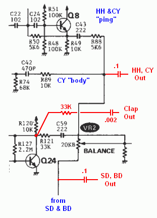

I've collected mods from :
http://www.theninhotline.net/dr110/110mods.html
http://www.haha-fresh.blogspot.com/
confusing terms (tune/pitch, filter/phaser...), strange resistor references, but doable Wink
cool colour schematic from here.
http://sslstudiodesign.free.fr/110/MODS/
I wonder if red spots are good locations for separate outputs (nc jack socket, maybe follow by some att potentiometer ?)

PostPosted: Sun Aug 09, 2009 2:17 pm    Post subject: Reply with quote  Mark this post and the followings unread
i`ve been working on the dr110 quite a lot.
the red spots are indeed where you will connect indy outs, exept for the open hihat, closed hihat and the cymbal.
their circuitry is so intertwined that it is not possible to separate them.
for those, add a volume control after the juncture of R88 / R89.

PostPosted: Sun Feb 14, 2010 2:32 pm    Post subject: Reply with quote  Mark this post and the followings unread
OK, this thread was a while ago but I try anyway.
I'm interested in raising the volume of the Hand Clap.
Looking at the schematis and considering what you're saying about the red dots I'm guessing I shoudl do something with the resistors R120/R121. Maybe lowering R121.

PostPosted: Tue Feb 16, 2010 3:34 pm    Post subject: Reply with quote  Mark this post and the followings unread
Could that be right?
Had a go at this myself, lowering R121 to about 15k (it was 30k) and this raised the volume of clap a bit (not so much) also the clap got a bit more treble. The effect was not very dramatic so there might be a better solution.

PostPosted: Mon Oct 24, 2011 9:37 am    Post subject: Reply with quote  Mark this post and the followings unread
I've also try to boost clap with no much success... but individual outputs is a must-have.
And now my clap is stereo ! (via boss ce-2b)
richardc64
Joined: Jun 01, 2006
Posts: 679
Audio files: 26
PostPosted: Mon Oct 24, 2011 1:01 pm    Post subject: Reply with quote  Mark this post and the followings unread
Try decreasing R114 and R115 and/or increasing R128.

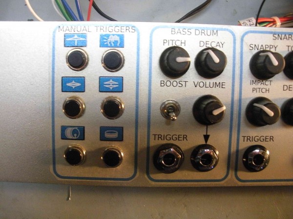

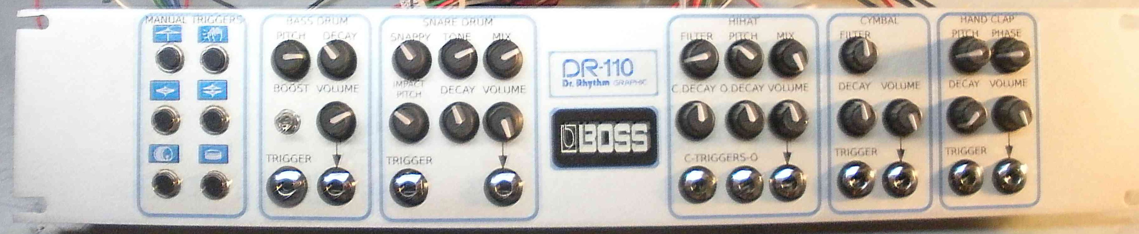

Hi gang! I know it's been a while since I've posted anything worthwhile. For about the past year and a half I've been working on a number analog percussion circuits as a follow up to the TH Quad Bass++ project. While perusing ebay a number of months ago, I found a fairly cheap Boss DR110 in need of some TLC. Since I was only interested in the analog portion of the unit, I removed the analog pcb from the case and created a 2u rack panel. I've saved the case and digital portion for future experimentation.
The end result is similar to a stripped down Roland 808. Now before you think that the DR110 is inferior to the 808 and it's older, bigger brothers, remember the DR110 was designed last, when the Roland engineers were more experienced and at the top of their game. The fully modded DR110 is every bit as good as the 808.....or any analog drum machine IMHO.
The mods I used were a mix of those found at Resonant Frequency, Plutonique9/hyperreal.org and those of Dave Magnuson. I'm sure I messed that all up, so I apologize for missing anyone who deserves some credit here. Anyone who wants to chime in with credit for any of these is appreciated. A lot of these mods have been regurgitated a number of times on the internet and full credit might have been lost. See reference links below.
Anyway, here are the mods I did:
1. replace C50 with a 4.7uF cap (adds more reverb to the clap)
2. replace C52 with a 4.7uF cap (adds more decay to the snare....more 80's sounding)
3. replace R70 with a 1K pot (kick pitch)
4. replace r86 with a 50K pot (kick decay)
5. added a switch with a 4.7uF cap across the kick pitch pot (bass boost)
6. replaced R81 with a 100K pot (snap level)
7. replace R80 with a 50K pot (snap tone)
8. paralleled R75 with a 50K pot (snare mix)
9. replace R76 with a 50K pot (snare impact pitch)
10. replaced R84 with a 50K pot (snare decay)
11. replaced R12 with a 1K pot (hhat filter)
12. replaced R10 with a 100K pot (hhat pitch)
13. replaced R22 with a 50K pot (hhat mix)
14. replaced R53 with a 50K pot (hhat closed decay)
15. replaced R20 with a 1M pot (hhat open decay)
16. replaced R16 with a 1K pot (cymbal filter)
17. replaced R44 with a 1M pot in series with a 1K fixed resistor (cymbal decay)
18. replaced R114 with a 50K pot (clap pitch)
19. replaced R120 with a 50K pot (clap filter)
20. replaced R113 with a 100K pot (clap R113)
As you can see, this adds a ton of wires to the unit. I probably spent more time dealing with broken wires to the pcb than the actual wire-up. Also, be very careful with pcb as it is not a very high quality board and traces are delicate.
I did add 6 pushbutton triggers to the front panel. I find these convenient for troubleshooting on the bench and auditioning the voices without having to hook up the full midi rig.

This is my physical layout so you can appreciate how much wiring is involved. Interface perfboard is to the left and contains the 4050, 4049 and PICAXE clap trigger circuit
 Filesize:  374.16 KB
 Viewed:  1559 Time(s)
Front Panel
 Filesize:  645.67 KB
 Viewed:  1729 Time(s)
Front panel left side showing manual trigger buttons
 Filesize:  442.04 KB
 Viewed:  1176 Time(s)
right side of front panel
 Filesize:  486.33 KB
 Viewed:  1366 Time(s)

remove R88-isolates the hats
remove R89 -isolates the cymbal
either remove VR2 or break the trace between C59 and R126 to isolate the clap
break the trace between R85+R86/c46 junction and break the trace to VR2 to isolate the bass and snare voices.
Use funkyfarm's red dots to attach wires for individual outs.
I was basically just curious as to whether or not the DR functioned normally without the breakout box connected.
I think it could be done but with a lot more monkey business. It would be more complex than what I've done.
I'm not sure how to respond to the timid thing, other than raising one eyebrow like Spock
That's RichardC64's job!
Anyway, the reason I'm interested in the DR, as opposed to the individual drum voice pcbs/kit deal is first and foremost because I really like the sound of the DR (especially the kick and snare)—
Actually, the bass and snare portion would be fairly easy to perfboard up...and a lot cheaper. The bass is particularly easy. In lieu of the Quad Bass++, it would be really easy to make a quad DR110 Bass. Dang! I wish I had thought of that before I approached Thomas Henry and State Machine to do the pcb!
But back to your topic...if you do get a DR110, you may want to just leave the hats, cymbals, clap alone and do the snare/bass mods....those were very clean.
One could, theoretically, add resistors and caps that duplicate the ones at each instument output; for example a second 33k and .0022uF cap at Q24 collector would bring out the Clap to a breakout connector some sort, if you can find space for one. (Or maybe an itty-bitty phone jack. What's the next size smaller that 1/8"?)
Bringing out Bass and Snare would be a little more complicated. Bass is made up of a tone (C45 & R86,) and a click for Impact (C46). THREE signals comprise the Snare: tone, click and noise.
Hi-Hat and Cymbal can only be partly separated, due to the filter formed by Q8 filters both the Hi-hat and the "ping" portion of the Cymbal sound.
So maybe a less thorough separation might be more practical.

I like Richard's solution better than mine for separate outs. I'd still want the SD and BD to be separate. He also brings up a good point about the cymbal. I'm living with them as separate as I have two other cymbal units to help fill those sounds out.

Thank you both for the replies!
The DR arrived today so I'm eager to get started. I will probably leave the hats/cymbal grouped to one output, with the kick, snare and clap getting an individual out each.
I have yet another question though. I have sorta made up my mind that I don't care if the DR doesn't function without the breakout box... so my question is this: is it ok just to follow the red dot spots (per the schematic posted by funkyfarm) for places to break the traces and run lines to individual outs? Do I need to place caps in line like on the little schematic by Richardc64?
Thanks again!
...I have sorta made up my mind that I don't care if the DR doesn't function without the breakout box... so my question is this: is it ok just to follow the red dot spots (per the schematic posted by funkyfarm) for places to break the traces and run lines to individual outs? Do I need to place caps in line like on the little schematic by Richardc64?
In that case, no, you won't need to add any caps or resistors. Follow Dan's directions for separating SD, BD & Clap. (funkyfarm's red dots.) You then can tap the combined HH & CY at the "top" end of the Balance pot. You won't have to cut or desolder anything there if you always keep '110 Volume at zero. Edit: OR use the '110's volume & output as the HH & CY out.

Hello again. I've managed to nearly finish my modded DR-110. Thanks for all the help and input, it's much appreciated.
I shot a little video demo... (audio is straight from the mixer via usb)
http://www.youtube.com/watch?v=r00wV-rh93Y
Not entirely finished yet, as two things need troubleshooting: power from dc jack not working, and the cymbal has disappeared...
But what a fun little machine!
