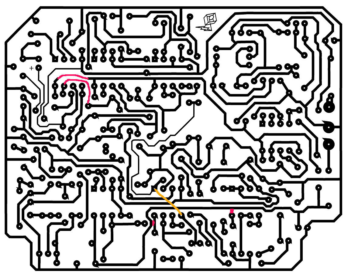

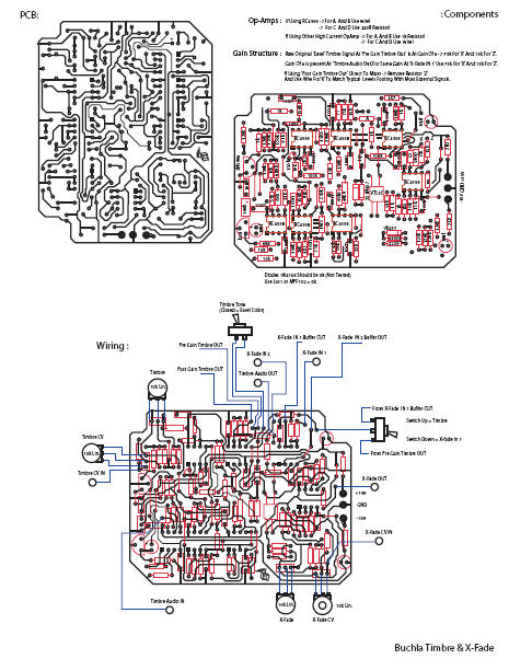

I made a DiY friendly Single Sided PCB redraw with easy readable wiring diagram.
A hell of a work,Not tested,Its Maxed over-checked ,but i cannot exclude an error.
Oh yeah BTW,this is a full fixed version with all modifications done as
explained by Lanterman on his site.

Found a few missing tracks off the PCB... I almost have it going so I will post the final fixes tomorrow afternoon in one go!

OK -- have got the signal from the input to the output! A couple of stuff ups of my own (a short and a wrong resistor value) but by comparing the signal against me LTSpice model at various points have found them. The PCB also needs tweeking at the following places. There are two +ve power pins missing from two of the opamps -- easy fix as the power is in an adjacent track. The signal from the 1st opamp (IC18 in the Lanterman schematic) dosen't make it to the resistor feeds to the subsequent opamps. This should be reasonably easy to fix but one of the tracks close by needs to be push up a bit, that is why i have drawn to lines close to each other to show that. The output from the last stage needs to go to the final gain adjusting opamp -- this one is messy and can probably be fixed with bit of wire on the underside...
I am still messing with the JFET part as I don't have any J201's and I can't find my other JFETS anywhere -- I also haven't fiddled with the Crossfader as I need some more Vactrols -- I will try and put in an LED and a pot to check it tomorrow...
Thanks again to Teknik for the layout -- having done a few layouts of my own I know how much work this would be. Only once you have built it do you really appreciate the amount of stuff he has managed to squeeze on to such a small board with remarkably few jumpers!

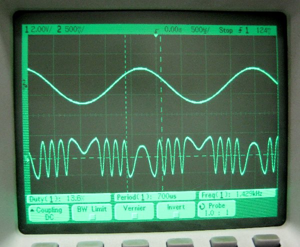

I will try and get some CRO screen captures and even some sound files soon... It certainly does do some interesting wavefolding and is well worth having a bit of a play with...

Forbin,many thanks for the debug,i start the fixes right now and uploud the update asap
TekniK
Joined: Aug 10, 2008
Posts: 1059
PostPosted: Wed May 26, 2010 3:14 am    Post subject: Reply with quote  Mark this post and the followings unread
I fixed the pcb layout,no jumpres where added, one jumper has moved to another trace (place) and 1 resistor is moved to.
The PDF in the first post is Updated: the pcb layout and Components implementation are fixed ,the wiring picture is unchanged note so this means it still has the errors in it but that doesn't matter.

...and some proof of the folding in operation. Top Trace In and the Bottom Trace Out...

ooo,i recognice those waves,looks ok Very Happy
