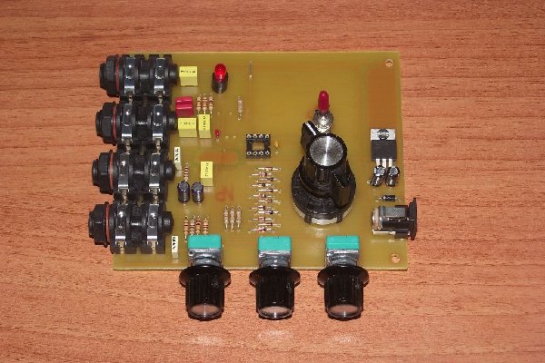

yusynth
Joined: Nov 24, 2005
Posts: 1310
PostPosted: Thu Mar 03, 2011 12:35 pm    Post subject: Reply with quote  Mark this post and the followings unread
Here are two photos of my prototype.
SMD component side
 Filesize:  175.61 KB
 Viewed:  507 Time(s)
Thru-hole component side
 Filesize:  187.3 KB
 Viewed:  400 Time(s)
Yves
elmood
Joined: Sep 05, 2009
Posts: 22
Location: Toronto
PostPosted: Thu Mar 10, 2011 11:33 am    Post subject: Reply with quote  Mark this post and the followings unread
Hey Yves,
Great to see the pictures of your boards! I'm glad to know that my code is getting a workout. The FV-1 is truly a unique part and quite fun to use. I'm only now trying to implement the same kinds of algorithms on other more general purpose processors, and it's not nearly as much fun. Smile
Keep up the good work, and send me bug reports or feature ideas and I'll see about adding them.
