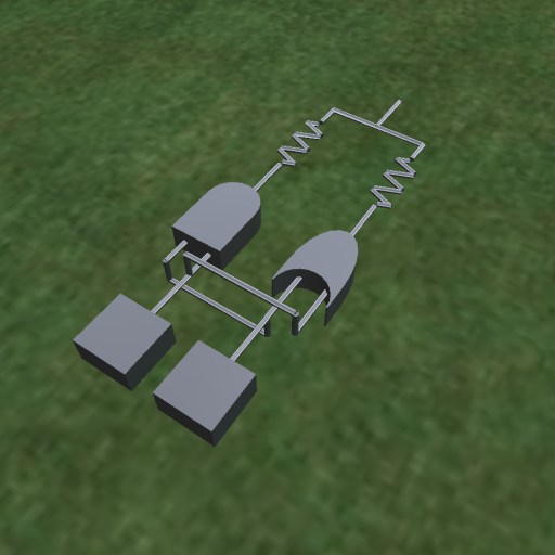

In the illustration below, I have drawn another simple Boolean Sequencer in the virtual world of Second Life and taken a jpeg snapshot for you. Since it is a 3D virtual world, I have taken the liberty of using all three dimensions to make the wiring connections at the inputs of the gates as clear as possible for those who are not familiar with reading 2D schematics.
In the illustration we have our two-bit counter clocked at the music tempo rate as before, and we also have our resistor aggregation network as before to create a CV from the digital signals. What is new is the remaining part of the Boolean Sequencer, which is the logic stage, also called the cloud of logic.
The logic stage is what gives the Boolean Sequencer it's character and musical phrases, which I will describe in a later post. For now let's make a table of the logic levels and the resulting analog output voltages. We will set the resistors to equal values for simplicity.
Code:
A B AND OR out
0 0  0  0  0.0V
0 1  0  1  2.5V
1 0  0  1  2.5V
1 1  1  1 10.0V
OK, well, um, we got that sequence before! Silly example, but trust me it gets a whole lot more interesting when we start adding more bits. In fact, why don't I illustrate just how interesting it can get with one of my favorite pieces of music that i ever created using the Boolean Sequencer. Let's keep it short and sweet so you can listen to a quick brief piece of music and then move on to the next post. I give you: 60x60 Rock!
