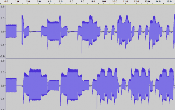

Posts: 378
PostPosted: Mon Aug 01, 2011 10:10 am    Post subject: Reply with quote  Mark this post and the followings unread
OK, perhaps this is interesting to someone... if I can figure out how to attach these examples... I did a little demo using a tone generator putting out a fixed frequency. Perhaps it's just illusion, but the spatializer seems to affect the tone.
The waveform just shows a bit of what the recording looks like... the first second is the original tone, and then the following stuff is what the spatializer does with it.
In the audio file, the first 2 seconds are the original tone, and then the spatializer kicks in at slow clock rates, then i start tweaking them to go faster later on.
