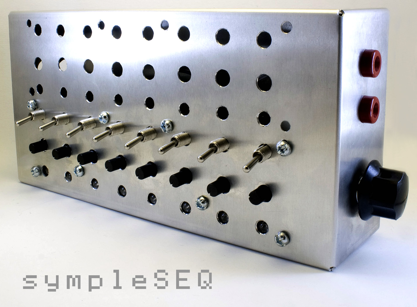

Greetings folks!
I am pleased to offer a PCB/kit design which I have slaved over for the past while for a simple Baby10-esque sequencer. I noticed a huge market hole for a simple to assemble sequencer, and thus sought out to design one that is both easy to build, and does away with all of the unnecessary frills associated with common sequencer designs.
The idea is simple:
BASE FEATURES:
- 8 steps of buffered CV/Gate out
- Actual note end per step (to make use of envelope generators -- the baby10 usually ties gates together)
- Select the length of sequence from 2-8 steps via the same switches used to toggle gate on/off. This does not complicate the assembly process any more than not having it Smile
- CV / Gate out to interface with standard analog gear
- Most importantly: EASY TO BUILD!
OPTIONAL FEATURES:
- The option is there to easily add ext clocking (CMOS level - compatible with the MFOS 16 step and others I am sure)
- The option is there to add external/switch controlled Reset -- external stop is in beta phase and may or may not be included in the final design suggestion.

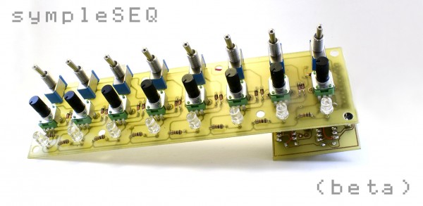

PS: Here are some images of my beta build of it! Note that I had to hand-route the second layer, and mount the headers awkwardly. Thus, my alignment is off. The production PCBs will be perfect, so that is not the case with them.
Also, I did not screw mine into the front panel, so the components are not quite aligned perfectly. I had to hastily get it ready for photos before my girlfriend left out of town (she's the photographer Razz)
Yours will of course be much prettier than mine![img][/img]

Looks nice, Hex! Can you advise the pot/switch/led board dimensions? I could guestimate, but I usually end up wrong when I do that. Smile
Synth DIY since 1977!
HexInverter
Joined: Aug 21, 2010
Posts: 338
PostPosted: Thu Aug 25, 2011 10:21 am    Post subject: Reply with quote  Mark this post and the followings unread
Thanks man! Smile
Oh yes, those are cleverly hidden on the IndieGogo page at the bottom (with all the pretty vector renderings of it) -- GAH! Actually I just realized a chunk of the diagram containing the measurement got goofed up when I copy+pasted Razz Fixing that now...
The board measures 161x41mm, but you also have to select a place for CV/Gate jacks and your clock/tempo knob.
It is extremely small. That is the idea Smile I actually like the look of the pots without knobs -- they have a pointer on them as you can see, and add to the minimalist style.
Were you to use knobs, the maximum comfortable diameter of the knob (on the outside, like the actual SIZE of the knob) should be 19mm. More than that will mean they could be touching each other!

From the pics at the bottom of all the various versions it looks like there's no Start/Stop switch...?
Also, how hard would it be to add a mod to run this off an external clock and/or pass the internal clock out?
I realize you're trying to keep it very simple (no step forward/backward or last step switch), but for most people's needs I'd think a Start/Stop and external/internal clock switch and clock in/out jack would be required to sync this with external modules.
HexInverter
Posts: 338
PostPosted: Thu Aug 25, 2011 1:42 pm    Post subject: Reply with quote  Mark this post and the followings unread
It is already designed to pass clock out or to receive it in, as it is meant to be scalable Smile The slashed out parts on the PCB layout of the smaller logic board are all like that to show to omit them when slaving to another sequencer.
There is no start/stop or forwards/back functionality. That would require an up/down counter which the 4017 is not. It can only count forwards as far as I know Sad It would also further complicate things. It is intended to be programmed live. You could always add an on/off switch if you wish to program it before turning it on.
Clock in/out externally is easily doable, but would be considered a modification. It is designed to chain internally, but externally would require a couple of very minor additions (input protection diode, for instance) which are not included in this design. The pads are already there for it Smile
It is a very basic design and is intended to be a ground for beginners to build upon and learn from.
Anyway, sending clock out is not the issue -- it will output a square wave clock at whatever +VCC you are powering it with, so it will interface with similar clock based sequencers such as the MFOS 16 step out of the box. In fact, the MFOS 16 step uses the same clock generator (CD40106), so as long as they are on the same +V they will interface just fine.

OK had a small epithany while having a coffee once i got home from work
I was struggling with the concept of latching a sequential switch for 8 clock pulses and then moving on to the next seq board, quite difficult for me at least . I then realised we actually dont need to do that.
if the sequential switching occurs on every clock pulse
the first clock pulse can go to the first seq board, the second clock pulse can go to the second seq board, the third clock pulse can go to the third board and so on . the CV output could be polled in the same manner at the same time . from in front of the panel it just means a differant way of numbering your steps.
there would need to be some processing of the clock
pulse width for various parts of the cct ie the output polling but that leads me to another interesting concept that i would need to think more about
concerning variable gate lengths.
doing it this way you could simply use a cd4017 and a few of dg412's similar to foniks sequential switch just expanded out , the switches duplicated and a fair bit of additional clock processing. using a 4017 it should be possible to do up to 64 steps using 8 seq boards, for those that like their projects on the larger size. Shocked
A very simple to build 64 step sequencer with almost no panel wiring involved does sound incredibly interesting even with no extra features Smile

Hmm, maybe I am misunderstanding. Let's just clear up what you are asking. Here's what I can do -- is this right?...
For the "stop": Basically, we can have it so that jacks (or switches) on the front panel will allow you to throw pin 13 of the 4017 high -- that will cause it to pause, until the pin is thrown low once again (or that signal is removed) -- then it will continue to count. It's a pause/stop pin.
"Reset" is actually being implemented (see my post below), and with that, can also be manually reset by a push button switch, or a jack that you send a high signal to to reset it to the first step.
Is this the functionality you desire? If so, it is very easy to implement. It's basically already there. I will include instructions and put the pads on the board to run wires to do so Smile
HexInverter
Posts: 338
PostPosted: Fri Aug 26, 2011 9:14 am    Post subject: Reply with quote  Mark this post and the followings unread
UPDATE!: The design/layout is currently being altered to have selectable reset from steps 2-8 via the toggle switches that you also select gate on/off with! A rather clever friend keyed me in on that idea (I don't know why it hasn't been done before, but it's very clever)
This does not change the complexity of the board or assembly. I will not be doing anything that revokes the "simple" status of this project.
Once it is done I will probably post a schematic for all to reference, and begin formal production of the bill of materials!

Uh-oh, I'm going to eat my words here, emdot_ambient.
Just tried it out on the breadboard and it's not behaving as anticipated.
The reset is definitely a go, but unfortunately with the stop/start, the gate and clock continue to pulse even when the 4017 is paused (d'uh...)
Sorry, I got a little excited Rolling Eyes Hold onto your cash until I've got this 100%, just in case Smile There is PLENTY of time to wait to place your order, as they won't be made until after the funding cut off (60 days from now)
EDIT: pretty sure it just needs a bit of thought. I think I can do it still, I just want it to work perfectly of course. A few bits of logic from the spare 40106 should do the trick Smile
