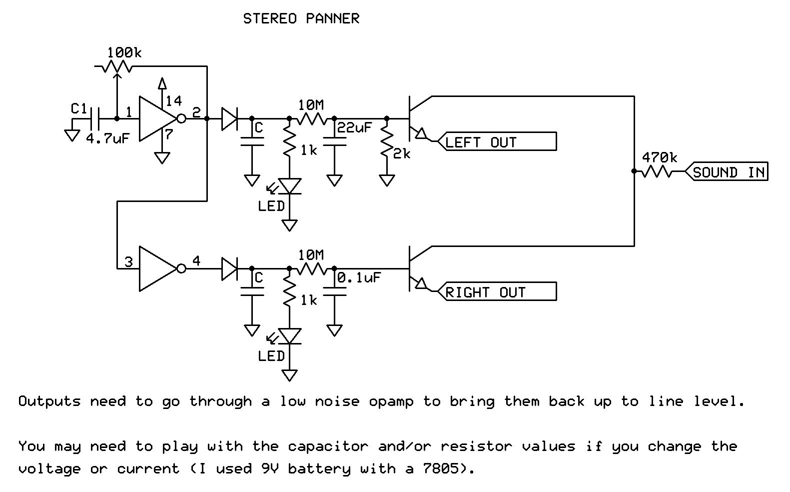

Cynosure
Joined: Dec 11, 2010
Posts: 966
Audio files: 82
PostPosted: Wed Oct 12, 2011 5:46 pm    Post subject: Reply with quote  Mark this post and the followings unread
I solved the clicking problem by using transistors instead of the 4066. I will post the schematic once i get some to to make it.

Cynosure
Posts: 966
Audio files: 82
PostPosted: Thu Oct 13, 2011 7:26 pm    Post subject: Reply with quote  Mark this post and the followings unread
Here is the schematic. The left side seemed to have a stronger pulse for some reason, so I used a large cap to ground near the transistor, and I added a 2k resistor to ground.
I'm going to keep this one on breadboard for as long as I can spare the breadboard, so let me know if you try it and run into any trouble. Sometimes the slightest change in a cap or resistor value either stopped the entire circuit or shut off one side.
 Filesize:  20.08 KB
 Viewed:  684 Time(s)

Cynosure
Posts: 966
Audio files: 82
PostPosted: Tue Jan 03, 2012 6:51 pm    Post subject: Reply with quote  Mark this post and the followings unread
I didn't use the 4066 at all. I used 2N3904 transistors to do the switching instead. The transistor seems to be able to do it slower, and doesn't cause the click.
However, it required lowering the level of the sound a lot and then boosting it up again with an opamp. This makes it ok as a stereo effect with the source sound mixed in the center, but you wouldn't want to run the sound on its own.
There are some schematics floating around for simple crossfading VCA's that do a similar effect and don't have any clicking because they turn down the volume quickly instead of just cutting it off. It might be worth a look if you are up to a slightly more complex build, but it is outside the world of CMOS.
