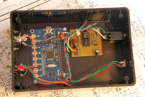

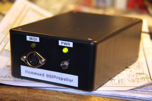

PostPosted: Sat Dec 15, 2012 2:04 pm    Post subject: Boxed up B3 Propeller Reply with quote  Mark this post and the followings unread
I built this several months ago and finally got it in a box today. I'm very impressed with how it sounds. I used the Parallax P8X32A QuickStart board that I purchased at Radio Shack. The enclosed MP3 demo file used a Yamaha MU-50 for all of the instruments except the organ. All of the Hammond B3 organ sounds are coming from the Propeller and DAC chip. You can get the QuickStart board much cheaper directly from Parallax.
Regards,

Awesome Theff. Which version of DAC did you use?
Synth DIY since 1977!

Hi Dan,
Thanks, I used the WM8727 and I could only get the SOIC package, so I mounted it on the bottom of the small PCB. I made a PCB from the original article but have not populated it yet.
Theff

PostPosted: Sun Dec 16, 2012 8:35 am    Post subject: Reply with quote  Mark this post and the followings unread
Thanks Theff! Ok I can see from your pcb photo you used the SMD DAC. Did you need to modify the code to use the QuickStart board? I suspect the troubles I had were related to my construction so maybe the QuickStart board will help me.

Hi Dan,
I didn't have to make any changes to the SW code, it worked as is. I just added the outboard PCB wth the opto isolator, opamp, and DAC and it worked.
Theff
