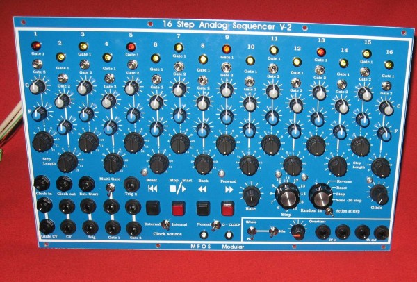

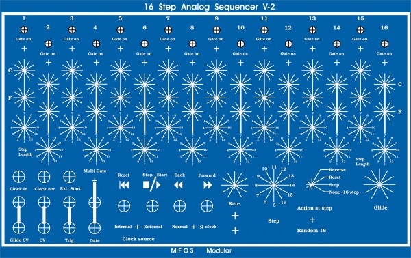

Hi all, ive been designing a panel in corel draw for a blue version of Ray's hot rod modification to the 16 step sequencer (Pontiac 455 super charged) heh Very Happy .
When i order the pcbs & wire everything up , i'll make the final adjustments to the spacings.
Really looking forward to building this one Smile .

As ever a great looking panel and I am sure it will make your music that much more........ Twisted Evil
If I could offer an idea or two? On my sequencer I have added a selectable voltage for the CV output. If I want full control of, say, filter cut off I can use the high voltage, CV of pitch- medium voltage range something like 0-5v etc. I know you can use an attenuator, I just prefer switchable ranges.
Secondly I have taken an alternative gate/trigger out. If I switch a step "off" I just route it to another set of outputs. Waste no want not.

nice panel Smile I like how you have saved some width with the offset vertical spacing
one of rays quantizers in that
space to the lower right might be nice.

updated panel design for new 2nd gate & mfos quantizer in corner Smile
Dave.

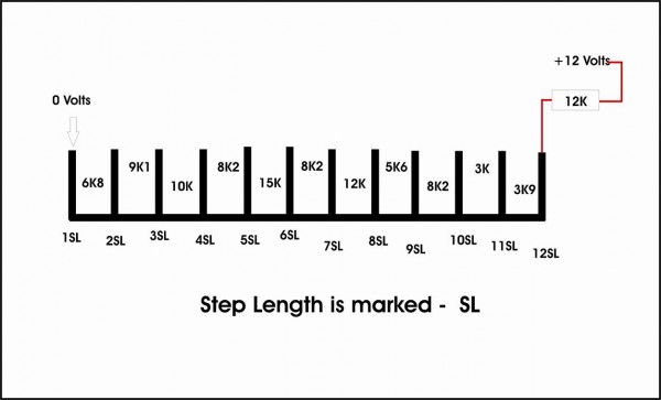

Hi there.
i've been working on the sequencer again Smile.
having temp hooked up the step 1 length pot, i first calibrated the pot action with the on pcb trimmer as Ray describes in the docs, then i turned the pot back to ground or 1 length position and measured the resistance at each change (solid lit led's) .
My pot is a 100K (measured - 102K ) .
At the last or 12th switch pole , my totalled resistance was 90K , i need a 12K resistor between the last position & +12V to make up the rest of the test pot travel.
So here are my results , yours will entirely depend on how you set your trimmer up to begin with.
Diagram of the 12 pole switch laid out flat with resistors between poles & a pic of the 12 way switch ( 1 of 16) to make , the heatshrink covers the 12K res.
more in a week or so , thanks for looking in Smile.

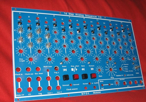

Hullo.
Got the sticker on the panel now and have started to swap the pots & sockets over from the original sequencer to the V2 new one.
Two or three holes still need a bit of a file out to straighten (i snapped a 6mm drill bit half way through piloting with the bench pillar drill , i thought it was getting a bit wobbly Smile ).
This will take a few nights to fill up the panel......
Dave.

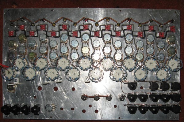

Hi there , still working on this , deciding not to rush it since it's a bit more complicated with my old V1 (2005) seq boards with the mods to upgrade to V2(2008/9).
Here's a quick pic of the back of the panel , progress so far Smile , i had to listen to some early Erasure albums to keep a happy vibe love when soldering those 16 rotary sw's & resistors (the thought of it after work Sad )
On the home straight now, wiring & some toggles to fit.
Dave.

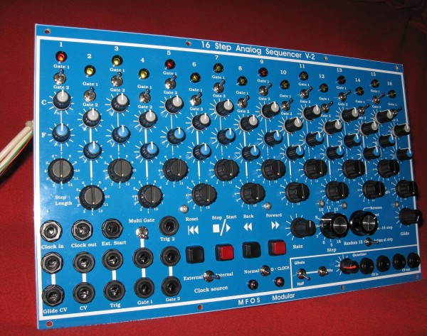

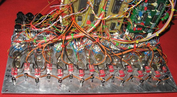

Almost there now , wired up , quick test and found some pots working back to front , heh , those to sort & tidy the cables up with some ties , i'll give it a good test at the weekend when i screw it back into the modular (there has been a draughty space in the modular for 3 months Very Happy )
A pic of the back end and a couple of the front , i'm taking a wee rest from synth wiring for a few weeks after it's all working Smile
Dave.

PostPosted: Wed Oct 17, 2012 1:59 pm    Post subject: Reply with quote  Mark this post and the followings unread
Nice. Nice. Nice
Quite a dense panel but it all looks like it works well.
