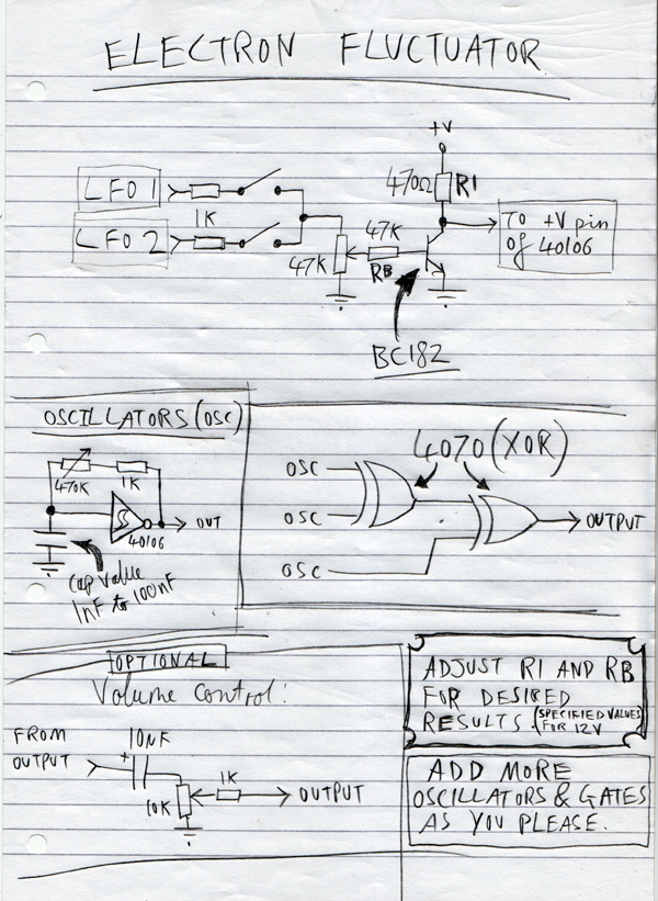

Inspired by Uncle krunkus' device I have made a similar machine.
Attached is a very long sound sample of the first test (once I got it working properly) Things get most interesting in the second half.
Power starving is a much more versatile and interesting technique than I first thought!
I'll get a diagram of my circuit uploaded soon but for now a description should suffice because ti is very simple.
Two LFOs are passively summed/mixed with two resistors (one LFO rising/falling ramp with direction control and the other one, triangle waveform) then via a level control potentiometer they are connected to the base input resistor of a transistor inverter (like this one) the output of which is connected to the +V input of two chips: a 40106 used to make the oscillators and a 4070 EXOR gate which conbines the oscillator signals.
The output is taken through a volume control but other than that, directly from the 4070!

I have named this device: Electron Fluctuator!
Find attached schematics and more demonstrations (but this time shorter).

Good work Joe. But, I don't have any BC182 transistors. Is it possible to substitute a 2N type? Any idea which one? I won't get to breadboard this till tomorrow, but it looks fun.

Any transistor should do really, just check the power and current rating and do some calculations with ohms law to determine current through R1. Make sure everything is within specification, you know? Smile off the top of my head 2N3904 should work as well as BC547 and BC337. BC182 is just a common tranny which I have lots of, different transistors might give different results due to differences in gain. Subsequently one may need different resistor values for RB and R1.

Yes Smile however the impedance is a bit low, I suppose one could just power the circuit directly from the LFOs if you buffer them, but I wanted a level control although the transistor is effectively my buffer here.
If I were to add external inputs to this I would mix them with 100k resistors and buffer them with an op amp voltage follower.

This project is pretty much done and dusted, to solve the impedance issue I'd add an op amp buffer to the output which is powered from the main power rail, not the transistor. A 100k pull down resistor might be useful for it's input to stop it floating when the starved portion of the circuit is un-powered.
However I used up all the op amps in an LM324 for re-combobulating those LFOs so I was reluctant to add another op amp for buffering.

If you wanted to get floaty weird voltages maybe some kind of capacitor power reseviour, a little filter or something on the buffer, between it and the transistor collector, although that may just smooth things out, maybe an LR filter would do interesting things?
