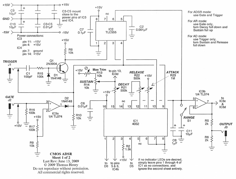

Hello everyone,
Here's the next project. This is a full-featured ADSR with indicator lights. It was really fun to come up with the logic for this---lots and lots of scribbling on scratch paper was required. The hard part, of course, was figuring out how to indicate the Sustain phase. That kept me going for a while.
Note that it can also be used in AR and AD mode with equal ease.
Thomas Henry
Schematic --- Sheet 1
 Filesize:  106.93 KB
 Viewed:  2946 Time(s)
Schematic --- Sheet 2
 Filesize:  60.17 KB
 Viewed:  2065 Time(s)
Parts List
 Filesize:  62.48 KB
 Viewed:  2003 Time(s)

may I ask a noob question to this project regarding the shematics??..
on sheet 1 at the trigger and gate jack there are lines with arrows
near trigger one between the J1 and C1
and near gate between J2 and R16, here the arrow is pointing from +15V
is this a potentiometer, a direct connection or ... ???
Saw the arrows on potentiometers or trimmer, but never like that ...
please could someone explain??

These are switches in the connectors which are opened when a plug is put in.

Thanks TH! Further proof you are the master of functionality and simplicity in design. A few questions. . .
1.) Output is 0 to +5V log response?
2.) The switching jack on the trigger in allows gate only adsr?
3.) What's the range switch do?
4.) Any info on the times of the envelope stages?
If this is too many questions, "build it and see" is an acceptable response Wink
PostPosted: Tue Sep 11, 2012 6:31 am    Post subject: Reply with quote  Mark this post and the followings unread
that's how i understand it, and the gate input is normalled to 15V to aloow trigger only operation.
changes the timing cap value to allow for slower envelopes.
re stage gates and end trigger:
i thought of adding another TL074 to buffer these outputs.
the end trigger would occure as soon as the ADSR goes into the release stage, otherwise one would have to add an additional comparator.
is an end trigger useful when in ADSR mode?
