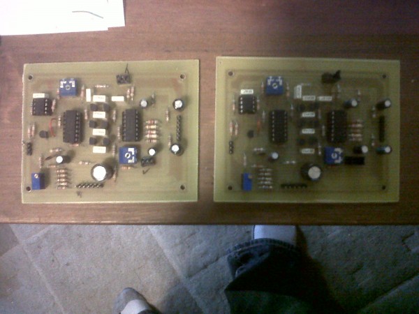

Subject description: Your website inspiring me to built my first modular
thanks for you job and your passion Yves!
I've start one month ago, I've built a couple of Monimoog Vcf and a wave folder.
Here some picture made with a cheap phone ahahahahah.
Just one question if some one can help me, is it normal the VCF is so noisy???
I have a kind of ground noise around 100hz @ -27Dbfs it's a bit huge right????
I've don't matched the 47n capcan be this the problem??????

I think is something to do with resonance if i disconnect the pot, or move the trim the noise drop down.
if i calibrate the trim the noise go up.....

100Hz is probably hum from the PSU, the hum is worst when you turn up the resonance as the circuit consumes more current. Try a better PSU with more current capacity, or try to connect only the VCF to check if the problem goes away.

I've try to connect only the vcf but the problem persist,
If i connect the wavefolder i don't have this problem so i don't think is that but maybe Im'wrong..........
I'm using the 15v psu from curetronic.

PROBLEM SOLVEEEEEEEE!!!!
was one of the 2 capacitor on the power soket
WEEEEEEEEEEEEEEEEEEEEEEEEEEEEEEEEEEEE Razz
