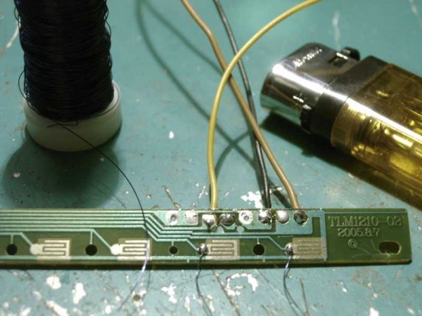

To be able to do all this I did have to solder wires to the PCB afterall, so I used some thin enameled wires and soldered them to a piece of perf
with a printconnector on it. This will make it easy to solder wires to it later. I also added a 3V supply using an LM317L.
I'm currently soldering the main PCB, So more info later.

soldering small wires, lighter for reference

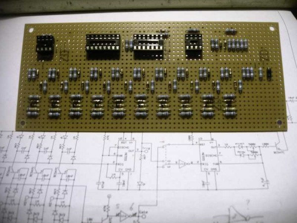

main PCB, under construction
 Filesize:  49.73 KB
 Viewed:  737 Time(s)
some more components added
 Filesize:  48.29 KB
 Viewed:  775 Time(s)
just a couple of transistors and a big capacitor left, but that'll have to wait untill tomorrow.
 Filesize:  48.6 KB
 Viewed:  752 Time(s)

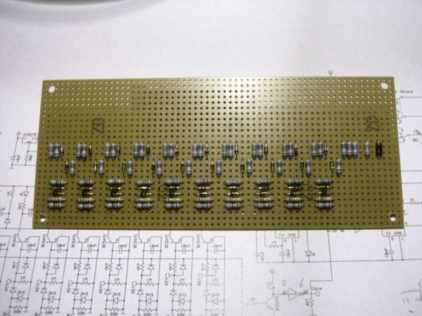

I'm done with soldering the main PCB, but before I can wire it up I first need to design a frontpanel and make a case for it and then order some
switches which should arrive tuesday. Maybe I'll solder a couple of wires to the PCB and do a couple of tests though.
Main PCB done
 Filesize:  47.19 KB
 Viewed:  684 Time(s)

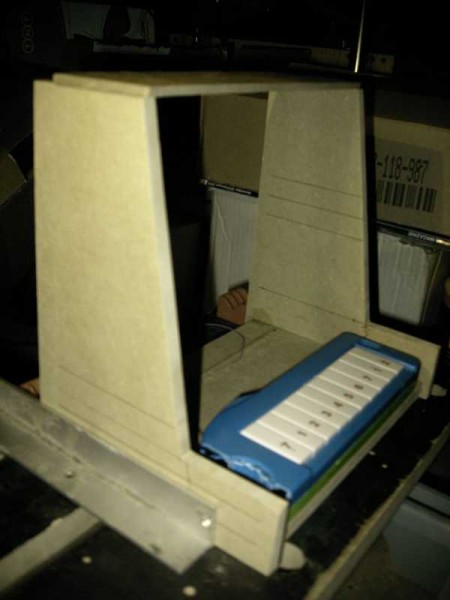

PostPosted: Sun Feb 24, 2013 3:57 pm    Post subject: Reply with quote  Mark this post and the followings unread
not the best picture but It'll give you an idea. the piece on top is just some scrap wood (might be usefull to cover the keyboard).
and an updated cover design Cool
case, under construction
 Filesize:  25.44 KB
 Viewed:  822 Time(s)

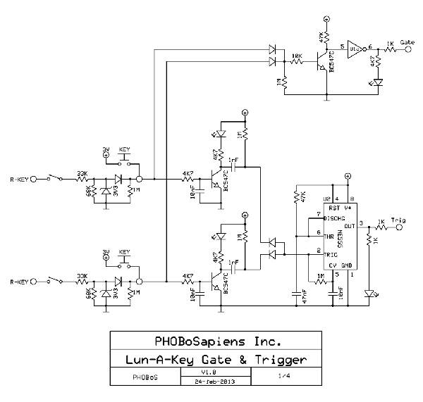

PostPosted: Sun Feb 24, 2013 8:17 pm    Post subject: Lun-A-Key
Subject description: Gate and Trigger circuit
The cat's not dead yet Laughing (I'm thinking of making a full schrödinger synth out of it Shocked ).
I look forward to see what you're working on and it would be great if you could make use of some of the things I've posted Very Happy
ok here's the first schematic (I'll post it in bits, since it's quite large and easier to understand in parts) . The Gate and Trigger circuits aswell
as the external control inputs for the keyboard. I've only drawn it for 2 keys, but in reality there are 10.
starting of with those, the keys of the keyboard are just switches that connect a 'KEY' point to the positive supply of the keyboard (3V),
so it's pretty easy to control these with an external signal. I want to use an input voltage in the range of 5-12V which would probably fry
the circuit in an instant. So I added a voltage divider (33K + 68K resistors) which has an output voltage of 3.3V with an input of 5V.
With the voltagedrop over the diode that's in series, there will be ±2.7V left, which is a safe value and enough to trigger the keyboard.
And if the input voltage is higher then 5V, the zenerdiode will still keep it at that.
next the Gate circuit which is very simple. An OR-gate made with diodes and a resistor, followed by a transistor, because the voltage is too
low to trigger a CMOS gate directly, which is in turn buffered by a schmitt trigger inverter (40106). Because the transistor allsoy inverts,
there is no need to add an extra inverter.
The trigger circuit also includes the LED indicators. The transistor, in combination with the 1nF capacitor and pull up resistors (one in series
with the LED), creates a very short high to low pulse.The pulses of all the keys are then combined, again using the same diode resistor configuration
of the OR gate but inverted, so with a pullup resistor and the diodes reversed (it's an AND Wink). If you're looking for the pull-up resistor it's the
1M attached to pin 5 of the 555 timer. The 555 is used in monostable mode and turns it a into a neat trigger signal. The 10nF caps attached to
the base of the transistors are to debounce the keys of the keyboard.
more next time sleeping
NOTE: the current through the zenerdiodes is too small for them to work, so in the final design I placed 4K7 resistors in parallel
with the 33K resistors.
 Filesize:  52.01 KB
 Viewed:  790 Time(s)

Really boring question PHOBoS. It looks like you're using MDF for your housing(s). How thick is the piece that you're mounting the controls on? I only say this as I tend to use a lot of 3.5mm jack sockets and I usually have to mount them on aluminium, steel or plastic sheeting, as the thread lengths are so short. I think that MDF will be too thick (or so thin that you could put your finger through it Crying or Very sad ).
It looks like it's coming along nicely, by the way.
Gary
Posts: 5581
Audio files: 705
PostPosted: Wed Feb 27, 2013 1:39 pm    Post subject: Reply with quote  Mark this post and the followings unread
Yes it's MDF, the front is 4mm which is indeed too thick for sockets, but I've still managed to use them by using a chisel and carving some
layers away, If you have a completely round 3.5mm jack socket it's easier because you can use a large drillbit, I've done this for those
DC input jacks. But be careful if you do it this way,. don't put it in a drill just turn it carefully by hand. You might be able to use a drillpress
but you would have to be VERY careful, else you just end up with a large hole.
here's an example from my PWM lunetta,.. look at the sockets at the top:
the sides and top are 8mm btw and I used a heavier 12mm piece for the bottom to add some more stability. (I used 18mm for the Bandersnatch).
I now have everything wired up,. so next is going to be the hold-your-breath-and-turn-it-on-and-hope-there-isn't-any-smoke part. Shocked
The painting set me back a bit timewise, I'm doing a duotone but one color kept messing up the other. I think it's ok now just needs some
clear coating. If I can resist I'll let it harden further until tomorrow before I put it together, allthough it will be dry enough to handle.

After I rewired the LED's yesterday there was still one LED that didn't light up. I wondered if I put it in reversed again so desoldered it,
and tested it (couldn't really see what was anode or cathode) and it turned out to be dead. I used some different LED's then usual (waterclear)
of which I had just enough,. I almost went into panic mode, but luckely I did manage to find just one more. After replacing it all the LED's
lit up as they should. Very Happy
So I inserted the 40106 and the 'Gate' and 'Out' LED's worked too. After that I put the 555 for the 'Trigger' output in place and that also
worked as it should.
Next the 4040 (octave switch, sub-octave and modulation). I could see if it worked by looking at the mod.rate LED, which seemed to work
except at one position of the rotary switch. So I checked what it was connected to and it turned out to be the wrong pin of the 4040.
It would actually blink really slow, but because the keyboard only produces short tones it didn't get a chance to turn off.
After I resoldered it to the correct pin I still wasn't really happy with the modulation rate. Originally I planned for a 4 step switch,.
but when I designed the front I changed it to 5 steps (I could have used 12, but the slow modulation is useless). So initially I choose
a larger division of the original squarewave for this 5th step, but in my opinion it was too slow,. so I shifted everything 1 step and
used a smaller division instead.
Finally there was one more chip to insert, the 555 for the AD/AR generator and with this inserted I could actually listen to it. Well,
I got sound but the AD/AR generator didn't seem to work as it should, it did something though. So I compared the schematic with the
PCB layout and noticed I had the timing capacitor in backwards, which of course I also put in the wrong way on the PCB itself. (this probably
happened after making some last minute changes for which I had to move some components around). After I replaced the cap (just to
be sure) the AD/AR generator worked too. Laughing allthough it doesn't always seem to retrigger but that's probably just how I designed it.
I might look into it, but it works well enough.
At this point I thought I had all systems running,. untill I tried the remote inputs. The key LED lit up, Trigger LED blinked, Gate LED lit up,
but no sound
So I measured the voltage going to the 'keypoint' on the keyboard and it was only ±1.2V. which should be 2.7V, hmm. I first removed the
connection between the input resistors and diodes and the rest of the circuit to see what voltage I got, but still the same. So I
removed the zenerdiode (keyboard disconnected) and now I got a voltage of ±6.6V which was correct. Well, what i didn't keep in mind
was that a zenerdiode needs some current flowing through it to work, and I had done just the opposite, that is trying to keep the current
through the diode to a minimum. So I just needed to reduce the input resistor (33K) and to make life easy I didn't remove it from
the PCB but just soldered a 4K7 resistor in parallel. After this modification the remote inputs worked perfect. So at this point it was
finally all working as it should.
One final change I made was change the series resistors of the Gate/Trigger/Out LED's which were not bright enough in my opinion.
The Gate and Trigger LED's are both waterclear which usually are also pretty bright but not these ones. And the Out LED is a blue
one, which can be pretty bright, but because it's actually blinking with a 50% dutycyle it's not as bright as when it's just on.
I'll post some schematics later. I'm still working on the paint now. I put some clear coating on this morning, but I should have put
