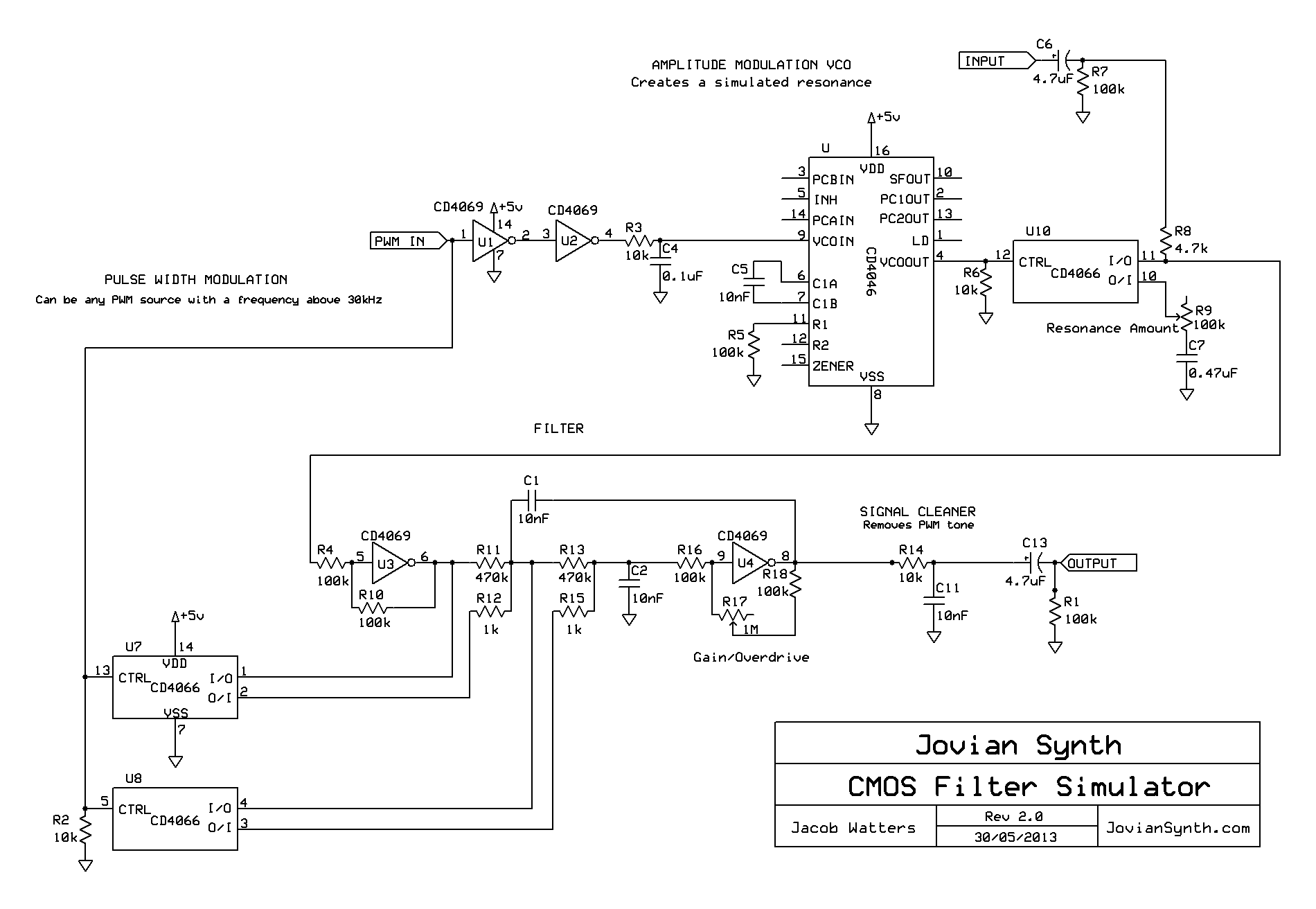

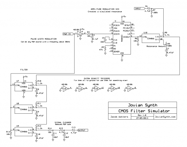

As some of you might already know, I have been sick for the past while and spent a lot of time in bed and not able to do much. This gave me lots of time to think about crazy CMOS ideas. I ended up bringing a breadboard and a little kit of part to bed and testing things out when I felt well enough to plugin chips and parts. Some of my ideas didn't work too well, but here is one that I think turned out ok.
The idea came to me when I read a post by JovianPyx where he mentioned switched capacitors. I came up with the idea of switching the capacitor in a RC filter on and off at a fast rate with a 4066. This would allow the circuit to be controlled by PWM - something that is a lot easier to create and modify in lunetta land than a control voltage. It also means that the PWM control combined with the fact that it can run on a +5/0V power makes it a perfect circuit to pair up with an Arduino.
EXPLANATION OF THE SCHEMATIC
PWM
The filter is controlled by any PWM source that is running above 30kHz. This frequency shouldn't be a problem for most CMOS circuits. I will leave it up to you to create your own way for generating the PWM source, but I used an Arduino that also provides a squarewave sound source using the Tone function. Other options include sending a squarewave through a highpass filter and buffering the output with a schmitt filter, using a boolean sequencer, or sending white noise through a schmitt filter or shift register to create random modulations.
RESONANCE EMULATOR

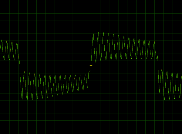

NOTE: This is NOT resonance, but rather an attempt to simulate the effect that resonance has on the wave shape. The attached scope shot shows how it actually looks when applied to a square wave. The little wiggles at the top and bottom of the wave look similar to the wiggles you get from resonance (but are audibly different). It is actually more like a ringmod.
The idea here is that the PWM is inverted, and then filtered to create a control voltage. That control voltage is then used to control a 4046 VCO. Since the PWM was inverted, the VCO tracks in the opposite direction of the PWM. This means that the VCO frequency goes down as the source pulse width is widened. This is important (explained two paragraphs down).
The VCO's output is used to control a 4066 that switches a cap to ground in a low-pass filter configuration. When the switch is open, the level of the sound dips a bit because it is being filtered. When the switch is closed, the level of the sound goes back up. This creates the wiggle in the wave shape.
Since the VCO tracks in the opposite direction of the source PWM, the frequency of the wiggles decreases as the pulse width increases and the frequency increases as the pulse with decreases. This simulates the frequency response of resonance by lowering as the filter is closed, and creates a zappy sound similar to that created by resonance.
FILTER
The sound then passes through three low-pass RC filters. The caps on the filters are switched in and out of the circuit using the three remaining switches from the 4066.
The switching is controlled by the PWM. When the pulse width is increased, more of the high frequencies are filtered to ground.
SIGNAL CLEANER
The final stage of the circuit is two low-pass RC filters with a high cutoff that filter out the noise created by the switching.
CONCLUSION
You can now have a CMOS passive filter that sounds and behaves in a similar fashion to a standard VCF. While it doesn't sound exactly the same (especially the resonance) it does have a unique charm to it. It is also a perfect thing to pair up with an Arduino.
THINGS TO TRY
Here are some things I plan to try when I feel up to it. If you get to it before me, then please post here to let me know how it works out.
1. Change the filter section to a standard switched capacitor configuration with a linear 4069 as a buffer.
2. Change the type of filter that is switched on and off to a simple active filter (maybe one based on a linear 4069).
3. Try to add a simple linear 4069 or darlington pair amp to compensate for the amplitude loss. Maybe control its amplification with the PWM.
4. Experiment with buffer and feedback options that would also add real resonance to the circuit.

I am trying some meds that seem to be helping a bit. I was able to test some more on breadboard today.
This version uses a sallen key filter and switches between two resistor values.
It sounds a lot smoother and also has a gain control to add some nice warm 4069 distortion.

I am feeling like crap again today, but I managed to record a sound demo. To me, it sounds a lot better than the first version. The gain control ads a nice warm distortion.
