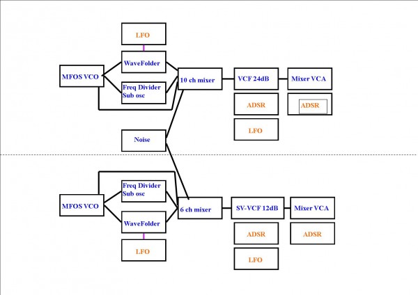

Hello , i'm constantly running out of space on my diy modular Smile
Over the years using the modular i have a common monosynth patch up i regularly use in my music , my idea is to build a hardwired synth using those modules from the main system and house them on a new panel & wooden box , thus freeing up space for more modules in the blue wardrobe.
Here is a rough diagram of what i have in mind.
To be operated as .....
2 separate monosynths.
A 2 vco 24dB monosynth.
A 2 vco 12dB svvcf monosynth.
Parallel & series vcf combinations via multi-pole switches.
Once ive built the wooden box and sourced a alum sheet 600mm X 250mm , the project will gather pace Smile
Dave.

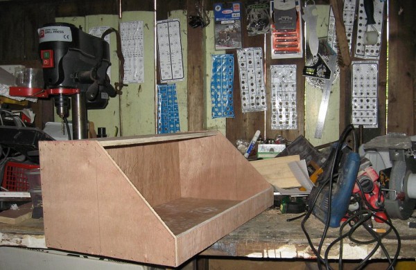

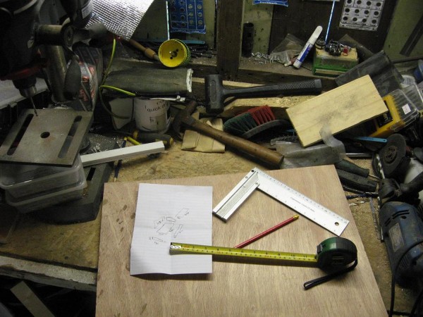

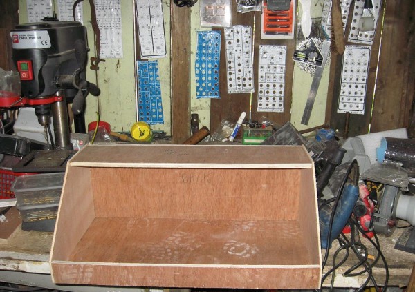

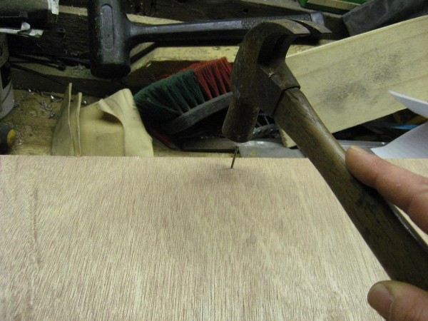

Smile Been in the shed......
I sketched out the design of plywood box to fit in the small space under the ASM-2 synth, then into the shed armed with saw , measuring tape , set square & straight edge & pencil ,pva wood glue , bag of 1" brads / panel pins & hammer. Oh , and nice plywood off cuts from a work skip Smile.
After a couple of swearing incidents and a tea break and this is what i hacked together today.
Dave.

PostPosted: Sun Jun 02, 2013 6:10 pm    Post subject: Reply with quote  Mark this post and the followings unread
Are you very short? I'm just trying to figure out how you got footprints inside the box!
Wink
Posts: 1077
Audio files: 131
PostPosted: Mon Jun 03, 2013 12:00 pm    Post subject: Reply with quote  Mark this post and the followings unread
Laughing My Nord micro mod. done a protest dance in the box when i wasn't looking Wink Smile

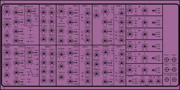

Here is my first draught of my layout for the front panel , i've got it to fit to 250mm high by 500mm wide on 3mm aluminium sheet , leaving a single module space to the right when the panel fits to the box , which is 603mm long inside.
Most of the parts of this synth will come from my main modular , so it's mainly a re- panel / re-wire job with a few extra pcbs to build in the modulation area.
To fill the space on the top right im thinking of using an multi-FX pedal and a distortion / overdrive with ken stone stompbox circuits on veroboard.
I'm going to let this layout simmer for a few weeks until i get an offcut of alum panel from a metal fabricator/engineers workshop.
i've spent a few days with the modulation sources for all the CV attenuators , making sure they are evened out over the destinations, i hope i've covered all my usual patch configurations with this layout Smile
Dave.

PostPosted: Sat Jul 06, 2013 10:34 am    Post subject: Reply with quote  Mark this post and the followings unread
Smile
Not sure which colour of vinyl will go with the dark grey, hmmm Smile
Dave.

PostPosted: Sat Jul 06, 2013 10:41 am    Post subject: Reply with quote  Mark this post and the followings unread
purple, will go nice with the color of the casket and with your blue modular. or go crazy and make it neon pink Twisted Evil

PostPosted: Sat Jul 06, 2013 10:50 am    Post subject: Reply with quote  Mark this post and the followings unread
yes , i like the lilac / purple colour , but the orange is super easy to read the text , but i'll learn it real quick , looking like purple if the print shop has some Smile
Dave.

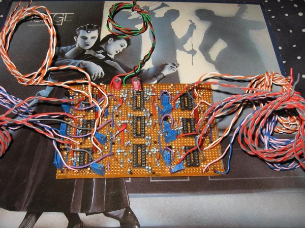

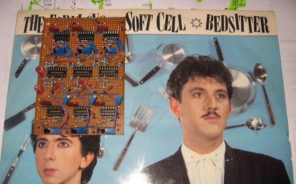

Hi ,
The 6 lfo's i have made on veroboard are from Ray's site under the oldies but goodies section , six of the "variable skew lfo" which outputs 3 main waves... sine / ramp - tri - saw (skew) / square.
I have made a few veroboard circuits and i now just follow the diagram and populate and isolate as i go and give it a good continuity test afterwards before the "no chip" power up test.
I have also started to the mfos micro S & H circuit which will have the lockhart wave folder & dividers on the same strip.
more in a week or so Smile

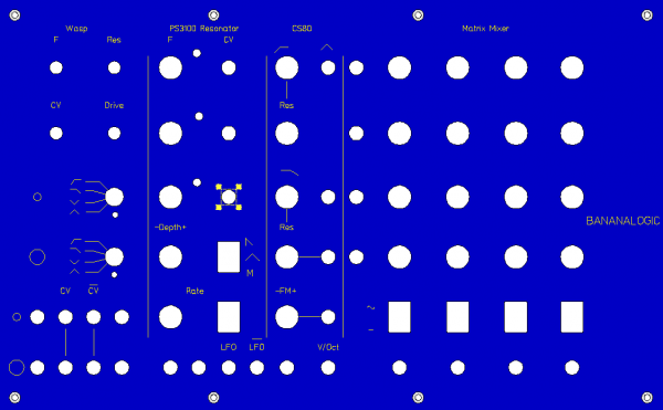

PostPosted: Mon Sep 02, 2013 12:34 pm    Post subject: Reply with quote  Mark this post and the followings unread
Sorry to be late on this.
What filters are you going to use? I like a variation from the standard LPF. A SVF or a combined LP/HP such as the MOTM CS80, Ian Fritz Threeler? I have a CGS CMOS or Wasp style filter on the drawing board. Mine will have dual-concentric pots to control two filters from one(ish) set of controls. I got these from Small Bear.
http://soundcloud.com/for-mash-get-ash

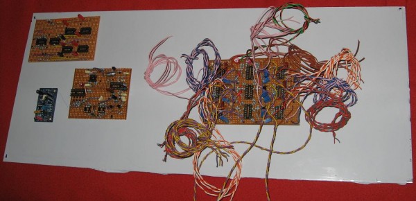

Im slowly taking my time with this build , heh , ive rearranged the panel layout a bit to fit the FX i wanted on the panel, which is now 600mm long Wink , still in the final stage of "what can i put in that space" , i was thinking vc-panner or a externally clocked melodic/random trigger generator of some sort for the 4 ADSR's. Hmmm.
Dave.

PostPosted: Sun Sep 08, 2013 12:03 pm    Post subject: Reply with quote  Mark this post and the followings unread
[/img]
This is just a screen shot of my Shaeffer design. On the left is the Wasp filter. The small circles are for the dual-concentric knobs, below switches for filter type then the banana sockets. I colour co-ordinate; blue for in and yellow for out so I dont need to add any labels. The small and larger circles are to show which part of the control is for which or the 2 filters. I try to eliminate writing and use signs and colours to define functions. I need to work on some graphic icons to add to the layout to reduce the writing even more. Something as corny as a graphic for an envelope of an envelope!!
I hope this helps. or at least explains.

Hi Ash
Nice blue panel Very Happy, i like blue Wink
Mad idea.... ignore this if you have finalised the design...... a double pole switch to swap one of the filters sweep direction on the dual pot , half way turn on the dual pot would be the cross-over point of the 2 filters sweeps.
Dave.
