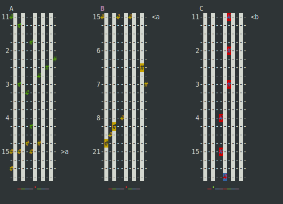

So got this idea stuck in my mind that I needed to do a terminal based midi sequencer frontend in node.js. Not sure how far I will go with this, but I thought I'd post the state of it now, maybe it will give someone crazy ideas if nothing else. Smile
What you see in the screenshot below are three compact, vertical piano rolls. Each displays one octave (C to the left), but you can add notes in different octaves by moving the octave selector below each piano roll. Each octave has its own colour. You can add more than one note on each line. I haven't worked out how to display a note when several of that note (in separate octaves) have been entered.
You can scroll up and down, a bit like a tracker. There is a numbering to the left of each piano roll, which counts from 11 to 88 (omitting zeroes) for every fourth row, and then starts all over again. The first digit is only show on every sixteenth row, to help with measuring bars. This will be configurable.
You can use event signals to stop a track or have it start other tracks. <c to the right of a line in the piano roll means that the track will stop and wait for some track to trigger the "c" event. >c means that the track will trigger the "c" event immediately when it reaches that row.
There is no mouse support - everything is done using the computer keyboard. You create or switch to a track using <shift>-<letter> (e.g. <shift>-c switches to the c track, or creates it if it didn't exist). You move up and down a piano roll using cursor keys or page up/down. You add notes using keys a,w,s,e,d,f,t,g,y,h,u,j (laid out like a piano keyboard). You add events by typing &lt; or &gt; followed by an event character.

Actually sending midi notes! I'm not planning to do this in my node.js program since (though I haven't really checked around) I don't expect it to have good enough timing. My plan is to make a backend in ChucK, and use its solid timing to generate MIDI, communicating with my node.js frontend using OSC. Obviously this is a huge project in itself.
Also, I haven't really implemented any kind of actually running the sequencers yet, I've focussed on the editing. Still, how hard can that be? Wink
Handling more tracks than the terminal width can manage. I'll probably add some kind of horizontal scrolling mechanism.
Hm there's probably loads more. Maybe that can do for a first version (in the utopian future where I actually finish this thing).
This currently runs in linux. I started out in Windows, but all the junk I needed to install (Visual Studio, .net crap) put me off. Node.js started out as a linux thing, and it works fine there. A big reason for this project is that I wanted to mess around with node.js, which seems to be a fine platform.
