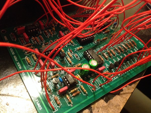

Alright pictures speak a thousand words I hope this will help....
Will post AC results ASAP..
But here are some pictures I hope will help trouble shoot this.
I also have a parts requisition list from Jameco and Mouser.
This is what I am working with as far as tools go.....

The board in question
 Filesize:  1.94 MB
 Viewed:  108 Time(s)
Another of the board
 Filesize:  1.98 MB
 Viewed:  95 Time(s)
