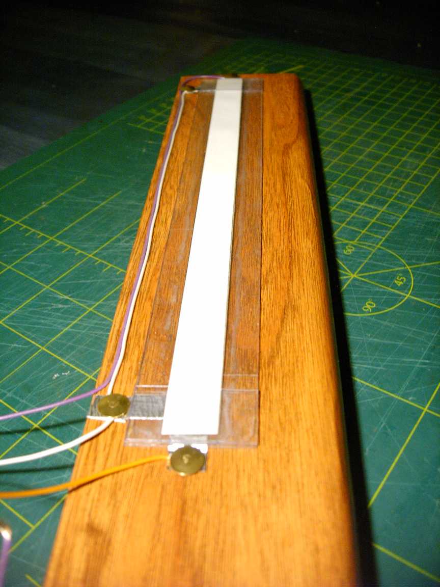

I put it all together and it seems to work Very Happy
it's mostly made up of the thicker plastic held together with double sided adhesive tape. I'll post some construction pics and more info later.
I think I also have a large piece of the conductive foam somewhere so I might give that one a try aswell.
But I doubt PHOBoS would start a fire with his experiments Wink
actually I was thinking of something,.. if you wire it up as a voltage divider and press it down on both ends (2 fingers) you could fry it. Shocked
(has nothing to do with oxidation ofcourse).
But the measured resistance is 400K on my version with a length over 200mm. so that's almost 2K for 1mm, and the way it's constructed you
can't even get that close to the end points.

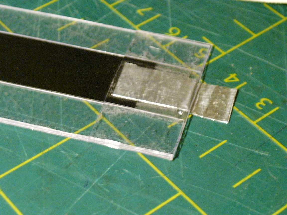

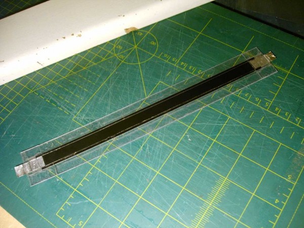

Some info on how I constructed my ribbon. I actually made it the other way around so the resistive track is on the bottom and the ribbon has the
aluminium conductor. I think that this way there is less change of damaging the black plastic resistivestuff and if used as the ribbon the
flexing might change the total resistance slightly. Also if the ribbon get's damaged it's easier to make a new one with aluminum tape and you'll still
have the same total resistance.
I started with putting some double sided adhesive tape (I'll refer to it as dsat) on the thicker plastic, stuck a strip of the plastic bag on to it and
then cut a 15mm wide strip from that. I put some more dsat on a larger piece of the plastic and stuck the strip on it with two strips of plastic next
to it on both sides, which I then cut to size. So that gave me two layers of plastic with the resistive strip centered on top. I made contacts by folding
some pieces of the aluminium tape in half with the sticky stuff on the inside (this side does not conduct). The resistive strip is shorter then the
bottom piece of plastic so the dsat on that holds the contacts in place.
I cut two small pieces of plastic which I stuck on both ends which act as a spacer and insulator between the contacts and the ribbon on top. They
also provide enough pressure to get a connection between the contacts and the resistive track. I cut two more strip of plastic that fitted between
the two ends and stuck them on leaving a gap that's smaller then the ribbon. This will prevent the ribbon from touching the track when not pressed.
like the black spacer on this but made up of 4 pieces:
I then put some more dsat on both ends, stuck the contact and the ribbon on it and covered it with two small pieces of plastic (one on each side).
The ribbon was made by sticking the aluminium tape on the thin plastic sheet and cutting a 15mm strip from it. I used the white border on the
side so I got a nice white ribbon Very Happy The whole thing was then stuck to the wooden base (which I covered first with some self adhesive plastic that
has a woodprint on it) and I used thumbtacks to connect wires to the aluminium tape contacts.

So now I got a question for DUBmatze about the foam version that started the thread. Does the PCB (if that's what it is) between the two pieces of
foam have copper on one side to connect the +5V, or did you tape a wire along side of it (or through it) ?
DUBmatze
Joined: Feb 18, 2013
Posts: 150
PostPosted: Thu Mar 20, 2014 11:45 am    Post subject: Reply with quote  Mark this post and the followings unread
hehe,
looks a bit like ribbon is the thing ... ,) thanks for the credits.
in my version there are just 2 parts of foam ... the lower foam i just sew with a solid wire. the bright thing in the pic between the uper an lower part is just a pencil as spacer. if you put more fingers on it you get a lower resist. one foam never toch the other the conection are just the fingers. if you use more fingers or press more left or right you get other resistance. its not realy a ribbon .... its more like a tochpad.
I found a broken plastic breadboard with some glitter effect in it (not the electroc one just for cutting tomatos or bread on it). i thested this also and this is nice ..... kids playing it with a cucumber like a violin... (hint clean up after evry session this is going fast disgusting... baah)
Posts: 5825
PostPosted: Thu Mar 20, 2014 12:23 pm    Post subject: Reply with quote  Mark this post and the followings unread
thank you that made it perfectly clear Very Happy
cucumbers, hmm never though of that Shocked
Posts: 428
PostPosted: Sat Mar 22, 2014 4:12 am    Post subject: Reply with quote  Mark this post and the followings unread
I might as well join in the fun. A few months ago, I had built a makeshift ribbon controller for testing out my Pulse Witch 23 box. I had found some broadcast-format videotape in the trash that's about 15K / cm. So I mounted that floating above a flat strip of copper sheet.
In this video, I wired it as a voltage divider with a power source and a pot to control the range, so as to produce a CV I could use with my box. It's not that great with this box, i.e. in terms of precise control, but that's mainly because of how I handled the CV for this particular input (it goes straight into an LED/LDR pair... so there's the slow response of the LDR that's affecting it).
James.
