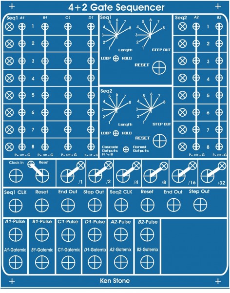

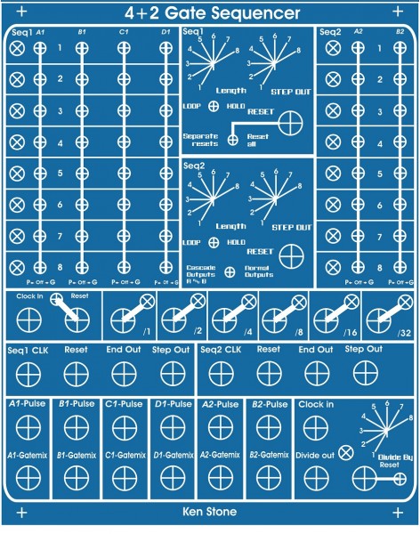

Hi there Smile
Recently I've been patching Gates from 4 of my diy sequencers through a sequential switch for some changing patterns for 1 bass line Smile , I really like the changing patterns but I'd also like to free up 3 sequencers Smile.
While browsing the net for diy solutions , a popular search return was the CGS89 Gate sequencer with a couple of add on switch banks/ buffers (like Thomas White's 4 channel CGS89).
Smile spent the last few weekends trying ideas for my panel, I think I'm close now Smile , Ordered some boards from Ken and I need to knock together a couple of veroboard divider circuits , one is on the test layout panel already , the space at the lower right is for a rotary selectable/ single out divider.
I'm going for a 4 channel for sequencer 1 and a 2 channel for sequencer 2 , I'm limited by a panel of 250mm high by 200mm wide for this module , I would have made Seq2 a 4 channel too but I will be tight for space , also there are no individual step outs , I had a long hard think about them and decided I'd be using probably just 1 out per cycle , so I went for a rotary to select the desired step & 1 out socket (to trigger my burst generator Smile ) .
Here is the blue test panel layout so far ....
Dave.

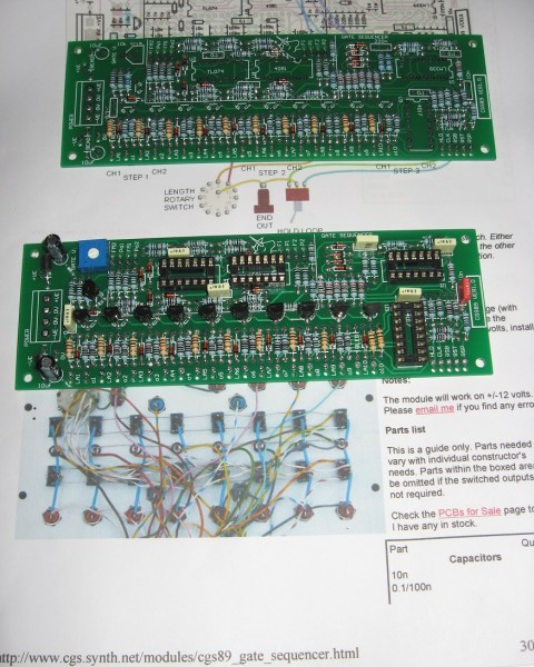

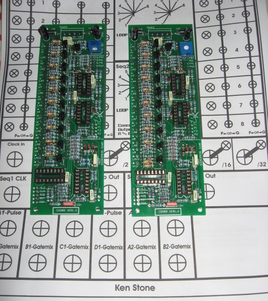

CGS boards arrived yesterday , Smile , decided to stuff the sequencer boards with components this afternoon & make an order to Rapid electronics for some panel switches & sockets etc.
Hope to get panel finalised through the week and get drilling next week Smile .

Hullo .
I've finished the panel layout with the 2nd divider & final checked washer / nut spacings for text fouling , all seems good so far , going to start the vero-board stuff later (extra buffers for channel C & D / and the 2 dividers).
Need to order about 50 led bezels 5mm with recessed slope in black plastic for this and other projects , I usually get them from Rapid http://www.rapidonline.com/Electronic-Components/LED-Bezel-5mm-29304 ..... then I noticed ESR components near Whitley bay are doing a better rate http://www.esr.co.uk/components/products/frame-leds.htm
Dave.

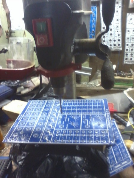

Got the stickers done , 2 sets one drill template & one clean finish .
Raced to the shed after work and centre punched the panel(s) , started with the 4mm drill and piloted all crosshairs , then went over the switches / sockets with 6.5mm bit , then 8mm bit for led bezels , and finally 11mm for the 1/4" sockets , I give the face of the template sticker a good spray with cutting oil, messy , but the drills glide through the 3mm alum plate , there are burrs on the exit side but easy to take off , I use a very sharp old wood chisel to plane them off , then the back side of the panel gets a quick rub with wet n dry sandpaper , finally a spray all over with automotive carburettor cleaning spray , great for getting fine grit & swarf off the front surface , don't light a cigarette after spraying Very Happy Very Happy , a final wash with soapy warm water and the plate is good for the final finish sticker application .
More at the weekend Smile .
Dave.

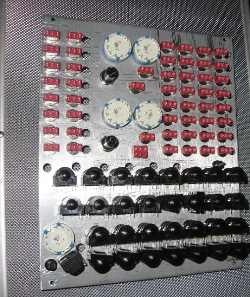

PostPosted: Fri Apr 25, 2014 12:46 pm    Post subject: Reply with quote  Mark this post and the followings unread
Hi.
Finished fixing the hardware to the panel (apart from the led's & fixing brackets) , next job fix brackets & run a solid 1mm sq bare copper ground wire round the sockets ground tags & a few more bits of solid conductor for the pulse / gate switches common wires which will run down L1 and L2 of the toggle switch rows.
Dave.

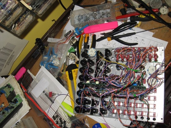

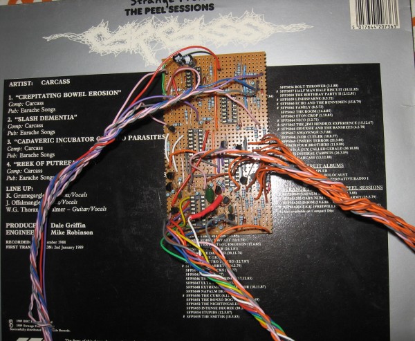

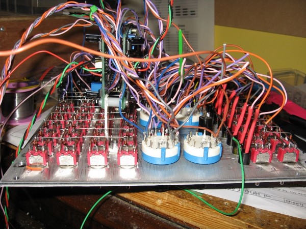

Wires..............
The tedious but necessary part of overtly switchy & sockety projects . a few pics of the wiring stage.

Yessss.
On the home stretch now , tested & powered up the CGS boards last night , both working a treat , yay Very Happy ,Quick test set up as 2 X 8 step sequencers, after testing both, I tried patching end out to reset in on each sequencer (1 to 2 / 2 to 1) + setting both the switches to hold and it works great as a 16 step with the outs "or" switched to A1 & B1, fab Smile .
Now to connect up & test / debug my veroboard then cable tidy with some ties and give final checks / tests .
pics & some sounds of it working the modular in next post over the weekend.

PostPosted: Sat May 03, 2014 10:03 am    Post subject: Reply with quote  Mark this post and the followings unread
Cable tying done and testing of whole unit finished Smile phew , nothing bad during final tests , I love it when projects work first time , heheheh Smile .
To the modular system.......
to get audio recording for next post.....

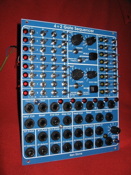

Quick pic of the finished front panel of the dual CGS89 sequencer (Ken Stone)
Middle divider (Fonik) and the lower right single divider (Yusynth).
Before installation into the modular, a pic of it relaxing on the couch Smile

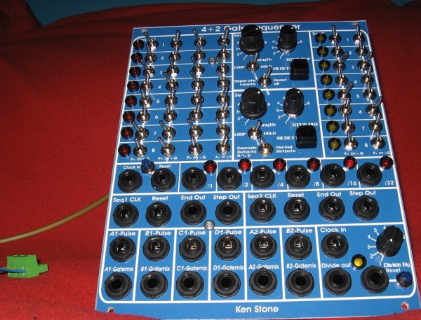

Hi There Smile
I now have a nice wee Epicyclus track I made today with the new dual CGS89 gate sequencer & many more modules , this may find it's way on to the new Epicyclus album Smile.
Patched up I have 3 sequencers (Fonik vcps8 / mfos 16step / mfos 16 varistep) working 3 dual vco's which go to Ken Stone simple wave folders then into 3 vcf's and 3 vca's.
The new 4+2 gate sequencer module is giving patterns (via a sequential switch module) for the 2 mfos sequencers , the vcps8 works a highpass sound (about 2mins into the track).
Added for decoration I played some juno60 high pad notes (about 3 mins in)
This module will be used a lot in my set up, I'm finding it great for spicing up 8 step standard sequences , fantastic Very Happy Very Happy Very Happy
Thanks for looking in to check the progress , cheers guys , and thanks to Ken Stone for speedy posting & great pcb's & also Fonik for divider 1 and Yusynth for divider 2.
