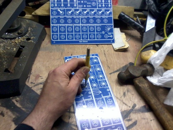

PostPosted: Sat May 10, 2014 6:15 pm    Post subject: Reply with quote  Mark this post and the followings unread
Hi , Tackled a bit more of this module last night Smile .
Panel is now drilled / stickered / pots 'n' sockets on , boards wired .
I just need a couple of 1K pots for the res. controls , I'll order them while i'm at the wiring stage Smile .
Dave.
