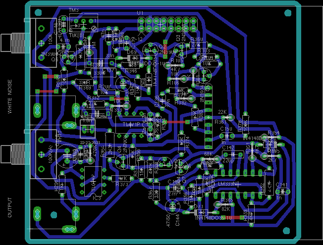

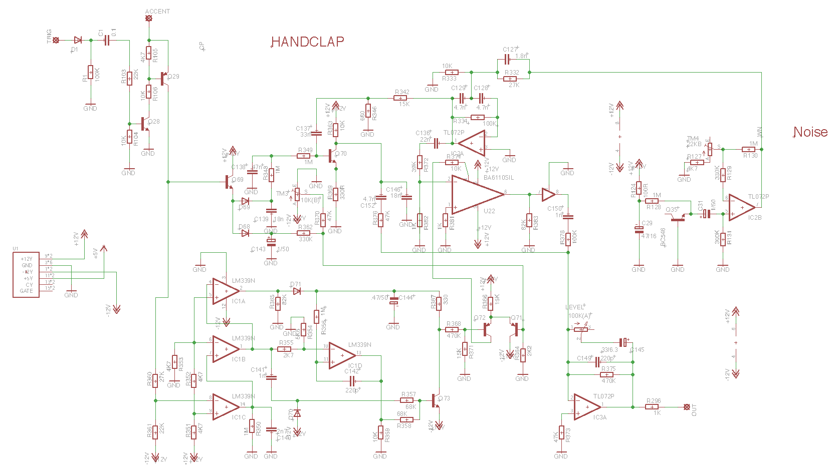

The simple noise envelope is working but the clackity clack is not happening. Help me debug!
I substituted the BA6110 but did not build the current mirror as suggested here: http://www.firstpr.com.au/rwi/dfish/TT-303/click-fix/
Could that be the problem?
Eagle files are here:
https://github.com/jbeuckm/808-Handclap

Started to have a look at this one in Eagle, I used your schematic, but started to reroute to have all resistors lying down, a bit more compact, and adjustments for parts which I have in my bin.
I'll try to spot mistakes before committing this to an iTEAD order Very Happy
Did you see these?

@LFLab Any luck? I have restarted this layout from the Yocto eagle file. I probably had a bad connection or wrong value on my first version. Also, I am moving to 2N390x transistors this time to avoid any pinout variations. I'm doing the reverb mod too.

CA3080, usually I'd replace this with 13700, but for the life of me I couldn't figure out what to do with the other section, and I do have quite a few of them around.
It only exists in Eagle now though Smile I used hexinverters neinohnein schematic, so that should be good.

PostPosted: Wed Apr 27, 2016 8:55 pm    Post subject: Reply with quote  Mark this post and the followings unread
Woohoo - verified! I had to change C140 to 27n to get separated hits (2n7 in the service manual). This has reverb level on a 16mm edge pot. Requires separate noise source.
https://github.com/jbeuckm/808-Handclap/releases/tag/v0.1
