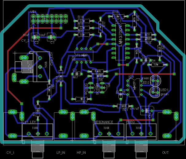

This is almost the SchmitzBits schematic but I didn't have a log pot for resonance so the sample is with a linear resonance pot.
Eagle files and a panel layout here: https://github.com/jbeuckm/MS20-VCF
CV2 with attenuator is available inboard and could also be installed.

Because of the LEDs, I noticed that I can make the filter self oscillate at very low frequencies UNTIL I plug a cable into the output - then the lights go dark. I wonder if an output buffer would help maintain whatever is going on there when audio is connected?
What scheme did you used?

It's this with 13700 directly subbed for ca3080:
http://www.schmitzbits.de/ms20.html
Does anyone know where to get an Eagle library for the LM4250? I'm working on Polyvoks Smile
Update: I found the package here: https://github.com/pichenettes/shruthi-1/blob/master/shruthi/hardware_design/pcb/Shruthi-Analog-Polivoks-v01.sch
