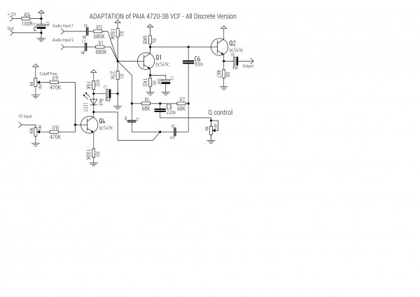

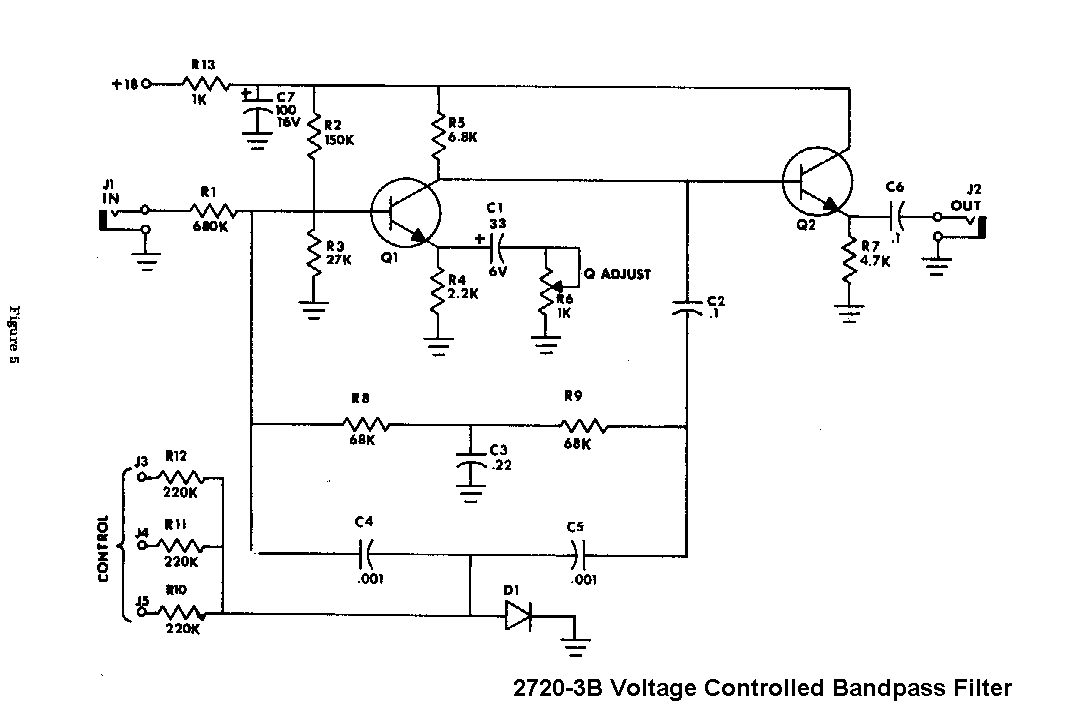

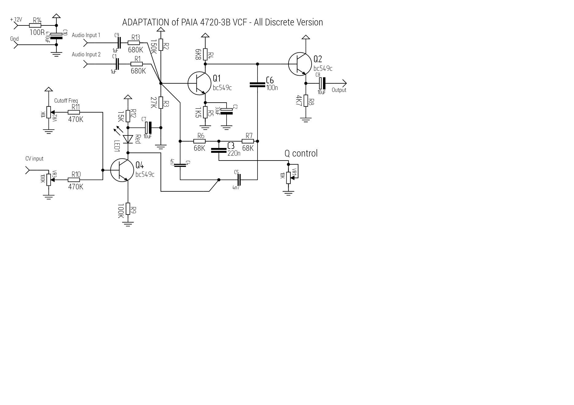

I tried out the PAIA 2720-3B VC Bandpass Filter on the breadboard. I wasn't initially that impressed with its range. However I swapped the diode for a red led and drove it from an exponential current source, the result was a great increase in the range of the filter. I also changed the way in which the Q control was implemented, resulting in, in my opinion a more natural control contour.
I also made a second version with a simpler current source using just one NPN transistor. The results were still very impressive.
The most interesting characteristic of these filters is the way they behave when overdriven. With high Q settings, the LED becomes modulated by the very signal that it is controlling and things freak out somewhat, the LED flickers too in response to the large signal swing!
The original is included for comparison.

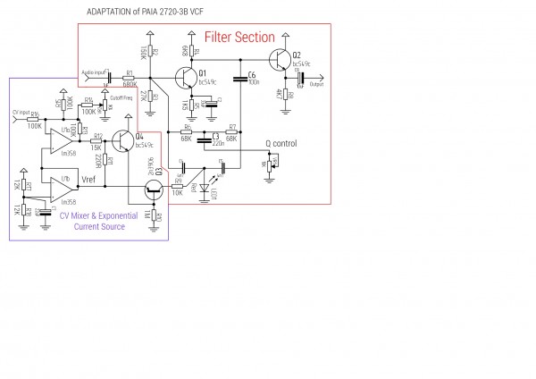

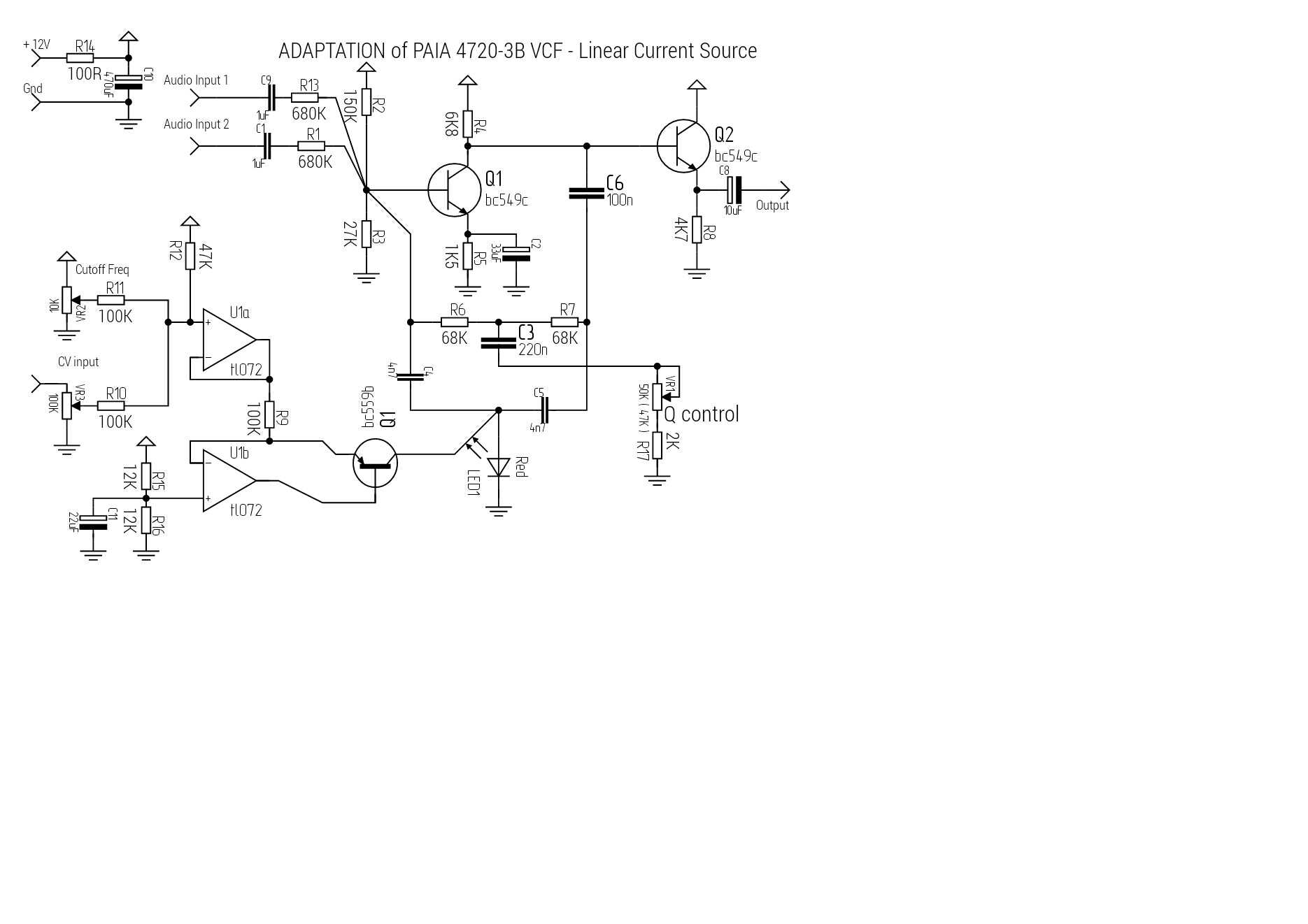

PostPosted: Sat May 20, 2017 5:20 am    Post subject: Better Current Source Version Reply with quote  Mark this post and the followings unread
This version of the 2720-3B bandpass filter has a linear current source that doesn't have any tempco problems.

PostPosted: Sun May 21, 2017 3:39 am    Post subject: Reply with quote  Mark this post and the followings unread
I was just trying out the circuit from my last post again and it would seem that 68K is a better choice for R12 as it allows the filter to be completely closed.
I suspect that there might need to be a bit of experimentation with some of the resistor values to accommodate different LED's. Specifically, R9 & R12.

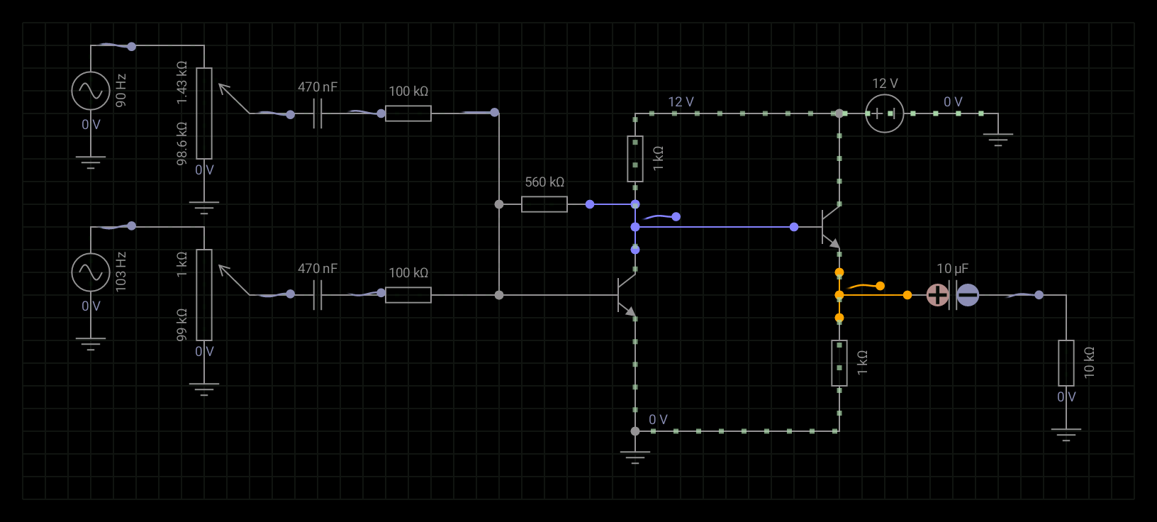

I built 2 of the PAiA 2720-3B bandpass VCFs and designed a little two transistor mixer and output stage with 10 V peak to peak maximum output.
The sinewave generators represent the 2 filters, the 10K resistor on the right represents the output load.

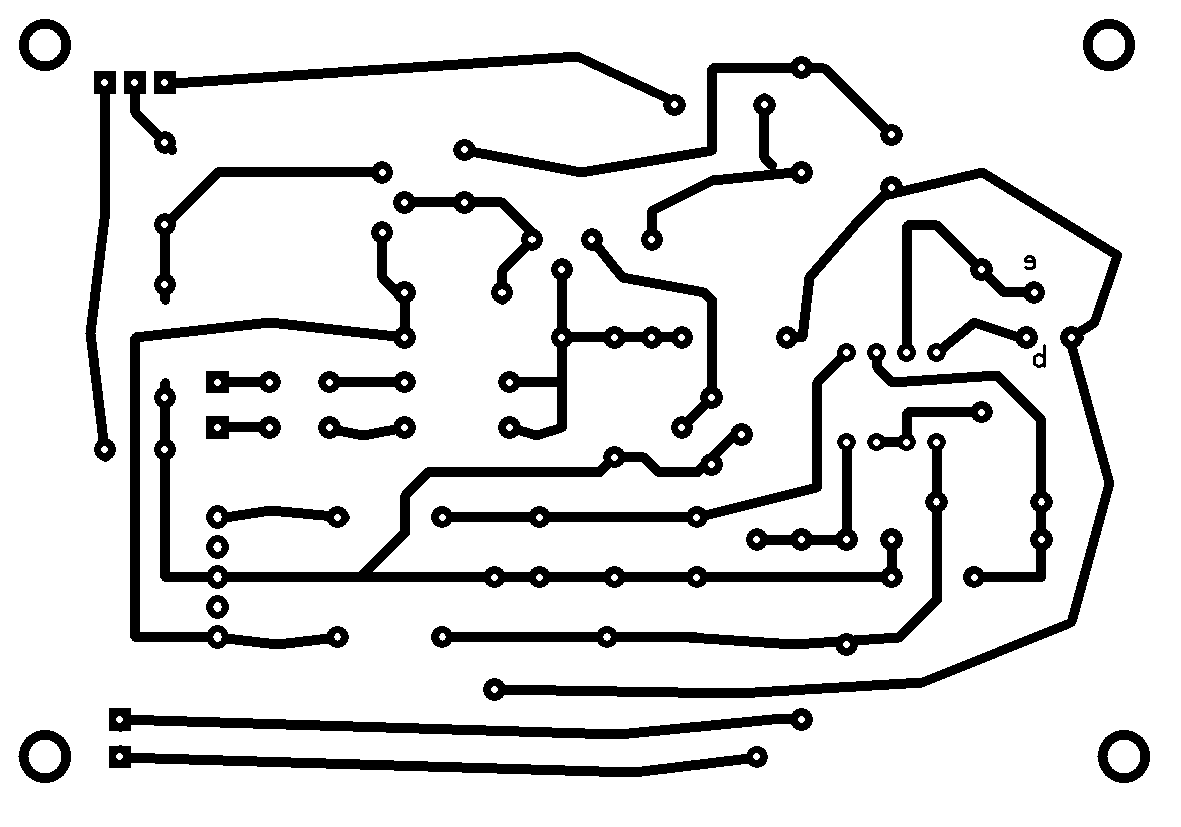

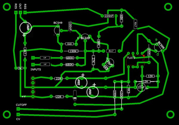

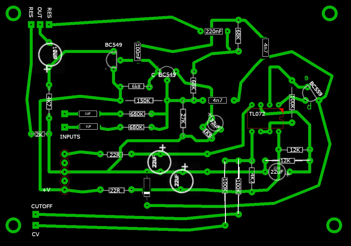

PostPosted: Fri Dec 07, 2018 11:33 am    Post subject: Reply with quote  Mark this post and the followings unread
Here's some PCB layout for this ,if that's ok . I didn't made the add-on mixer ,just the last linear response version ,wanna try this version , have built this filter once earlier as the original on 18V ,PCB is 70x100mm

PostPosted: Wed Dec 25, 2019 2:13 am    Post subject: Reply with quote  Mark this post and the followings unread
really like how this filter sounds ,however i replaced that 47K resistor with 62K and it wouldn't close all the way , it's powered with 15V so thinking to try 82K and see how that goes i even wonder if connecting the freq pot to -V via 47K resistor is better ,nice resonance

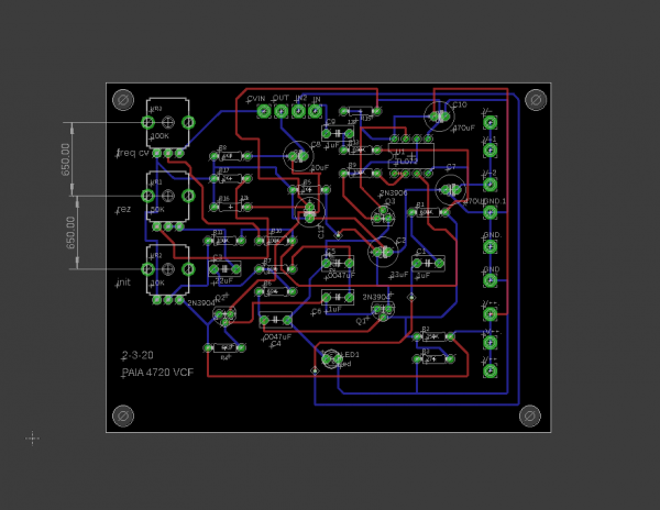

PostPosted: Mon Feb 03, 2020 5:18 pm    Post subject: Reply with quote  Mark this post and the followings unread
I am terrible at breadboarding/stripboarding as well.
I have created BRD and SCM in eagle, posting it here in zip along w/ gerber
I'll send it off on my next fab and let you know what happens.
Relatively Big board, not a lot of vias, room for jumpers, kludge wires etc.
No ground pour, no fancy stuff.
Warning: doing this while at work--checked it once, think i got it right, but may be mistakes. Passes DRC and ERD checks.
