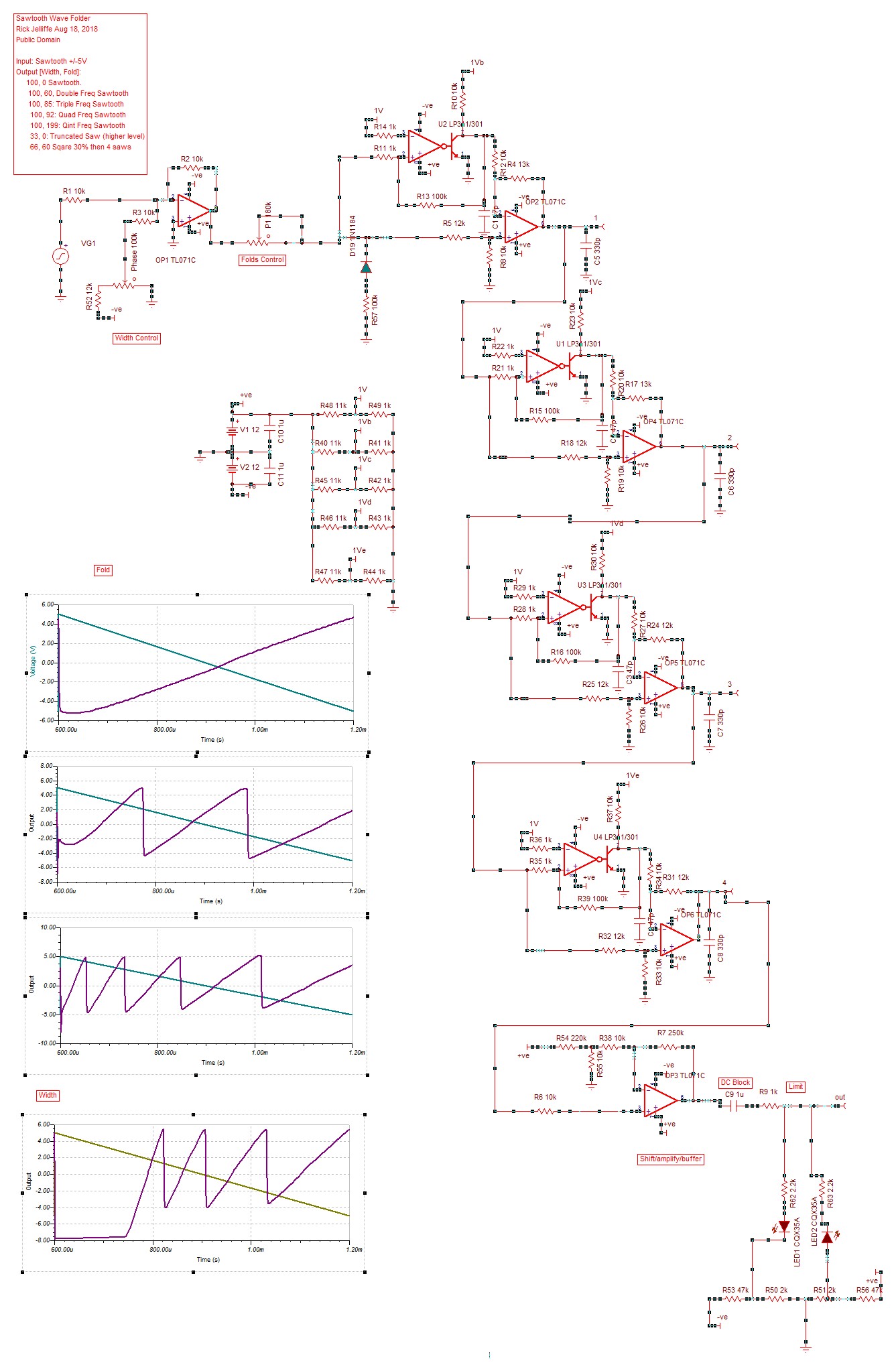

Here is a circuit idea. Wavefolders are now pretty well-known kind of waveshaper. They are often made from a chain of circuits that fold the wave back on itself, after it has reached a certain level. The effect can be like a sweep up harmonics or hard sync. It tends to work best for sine/triangle waves, not so good with sawtooth (too much variation in strength of harmonics) and pulse (not much effect).
So I wanted to make one for sawtooths. I am not sure whether the idea is really mine: probably not. It can be built with a quad comparator, & 3 dual op-amps, all vanilla components.
This version here does not use a folder, it uses a chain of fairly standard sawtooth doublers: once the sawtooth is over a threshold, each subtracts the PP amount. So increasing the level causes more folds: first the first doubler, then the second and so on.
So this circuit has four doublers that act to allow sweeping up to 5 x the frequency. You can see example waveshapes in the image below. The green is the input, the purple is the output.
As a bonus, there is a kind of pulse-width option too. It is an offset, so it could be a CV quite readily.

this looks interesting i built similar but fixed version from electronotes ,second thought this idea with stages can be useful musically ,thanks for sharing _________________ http://synthacks.blogspot.com/ шематикс |

Yes, to be clear, this isnt four fixed outputs, it is an output that varies from saw to quintuple saw as you turn the fold pot.
And if you replaced the fold pot with some vca thing, it would be under voltage control. (The width pot is a bias effect no different from adding a cv offset to the input saw, like you can do with normal wave multipluers.) |
