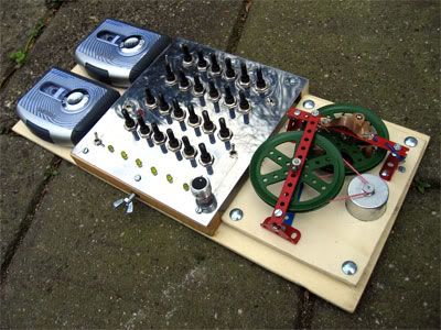

ok so since i saw this tape sequencers made by Gijs Gieskes
the one whit logic sequencing
and the one whit mecanical sequencing
i have wanted to make my own - and because Gijs has no information on those beasts.
( Gijs page)
finaly i choosed to go my own way . . . but i need some help
first i got this cheap portable casette player "unisef z-50". opend it up and tryed the motor - but i found out that on low voltage (slow playback) the motor doasent have the strenght to roll. so i savaged and old VCR. and found nice powerfull DC motors for the job - the problem whit the bigger motor is that it draws more current so i can´t draw the voltage straight from the chip as i planed in the first place - this is my first plan :
so now i have CV of about 0 to 7V
i have one of thease KEMO B 184 kits (adjustable PSU) that looks like this :
it gives the suffisent voltage to my new motor (0 - 14V)
so the final question is how to make this power supply controlled whit the controll voltage i get from my sequencer unit (0-7V)?
thanks in advance and sorry for this confusing post.

You're almost there, just multiply the control signal by a factor of two and add some 1.2 .. 1.4 Volts and then connect the output of that straight to the base of the darlington, deleting 220 R, 15 Volt zener, etc.
This multiplication by a constant and addition of an offset is standard opamp stuff as you've seen it in the soundlab already, probably.
When you want me to beam up a proposal just let me know & I'll photograph what I just sketched here.

PostPosted: Sat Oct 01, 2005 7:06 am    Post subject: Reply with quote  Mark this post and the followings unread
Something like this I was thinking.
The first opamp amplifies the signal by a factor of minus two and it adds some offset that can be set by the pot (which I specified as R, but the 100 k pot of the original PSU will work as well).
The 2nd opamp makes the signal go positive again, a plain invertor.
The two capacitors tame the thing a bit. You might want to add a capacitor of something like 470 nF between the wiper of the offset pot and ground to make it less jumpy in case it's quality is not too good.
The opamp can be almost anything, I think the good old TL071 series is still in fashion these days - I saw it used in the soundlab I think ?
The only thing is it needs a dual power supply of about +/- 15 Volt, which might be a bit clumsy for this partiular purpose. But to get around that it goes beyond just a bit of sketching for me - I'd need to breadboard it.
Ideally for motor control you'd want to have some feedback involving the actual RPM's the motor makes, or the current that flows through it. A circuit without feedback will only get you sofar, but when the motor has enough power and the flywheel is big enough it might work.

PostPosted: Sat Oct 15, 2005 3:50 am    Post subject: Reply with quote  Mark this post and the followings unread
thanks Blue Hell
i think thats too complicated and hi-end for me - i need something
lo-fi and simple.
i have thought to use light dependent resistor or light dependent transistor to feed the power supply darlington transistors base (shown on the pic as red spot) and have the CV from the sequencer unit to light up a LED that is coupled whit the light sensing component on the power circuit.
so the component should go between the pot and the base of the darlington tranny (the pot would function as master speed)
