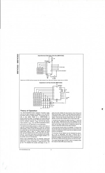

Hi
I've been looking at CGS10 mini pedalboard/keyboard schematics using (MM)74c922 that gives a sixteen key keyboard with CV and gate outputs. According to the data sheet the 74c922 can be expanded to 32 key input using a four input NAND gate, diodes and pull up resistors. However, I can't see how the second keypad switches or more precisely what it switches between.
There is probably a simple answer that I am unaware of but there seems to be nothing to switch between on the second keypad shown in the datasheet unless they connect to X1 to X4, which is not shown. It may be that that connection is implied but I don't know enough to be certain.

This is the schematic from the datasheet that I want to use but there appear to be connections missing.

..unless they connect to X1 to X4, which is not shown. It may be that that connection is implied but I don't know enough to be certain.
without really looking into it that would be my guess. I think I have some of those chips too, maybe I can do some experiments.

The X outputs are definitely meant to be extended down to the bottom grid of 16 switches. It is very annoying when things like this are assumed ( by the writer ) to be implicit. Causes a lot of grief during the earlier stages of the learning process and sometimes even to those of us longer in the tooth with our hobby.

OK> The chips arrived all ten of them. I've munged together a switch matrix of 27 switches on a board. I've used a CD4012 for my four input NAND gate for the extended schematic.
I beadboarded the CGS 10 as shown in Ken's schematic with just 16 switches/keys and it worked beautifully even apart from I don't have a multi turn 100k trim pot just a single turn and I made the R2R from 5% 100k resistors soldered together to give the 200ks. I have 1% 100k's but didn't want to waste them prototyping. I also had to solder two 1uF together to give me something close to 2.2uF for the keybounce cap. I'm very pleased with the way this just worked first time on the breadboard. I can already see several uses for these chips for me in future, one being single octave keyboards to control the note of drone oscillators in a tanpura/shruti type instrument and of course Kens suggestion of having it control the root note of a sequencer. Plus you're not dependant on a cap in a sample and hold which will eventually drain - I like my notes looooooooong!
One thing to be aware of is that you cannot play legato(?). Press a second switch and the tone doesn't change until you release the first key. And I haven't tried the data available pin yet for gate.
Moving on to the extended version - I can't get it to work. The first sixteen notes are there and scalable with the trim but once you go beyond the first sixteen it behaves oddly. You press a switch and you hear a note but release the switch and the tone drops to the value of one of the first sixteen notes. I'll put up some video and the schem of my switch matrix to see if anyone can spot an obvious fault but it may be as GASBOSS says these chips from China might not be up to spec or possibly this wasn't going to work anyway. I don't know enough to know at the moment.

The first is just the CGS10 with a sixteen switch matrix as shown in the original CGS schematic. If you wince at what I describe as a scale remember the R2R is made from 5% 100K resistors exclusively. It will probably sound sweeter when I break out the 1% and invest in some 1% 200K and get a multi turn trim for the span control.
The second demonstrates the behaviour with the expansion suggested in the MM74C922 data sheet. I'll post schems of what I did to realise this but this video is to demonstrate the behaviour. Basically keys pressed in rows Y1 to Y4 generate voltage which stays at that level after key release. Keys played in the rows Y1+ to Y3+ - which are connected to Y1 to Y3 by diodes and to Vs by 100Ks - put out voltage but that voltage drops after key release. If I play key 16 which is column X1 switching to Y1+ after release the voltage/tone drops to that put out by key 0 which is X1 switched to Y1. In my head this appears significant behaviour but don't know signifying what!
In the extended version scaling doesn't appear to be an option, even keeping the keys pressed down and twirling that trim to destruction. Oh well.
