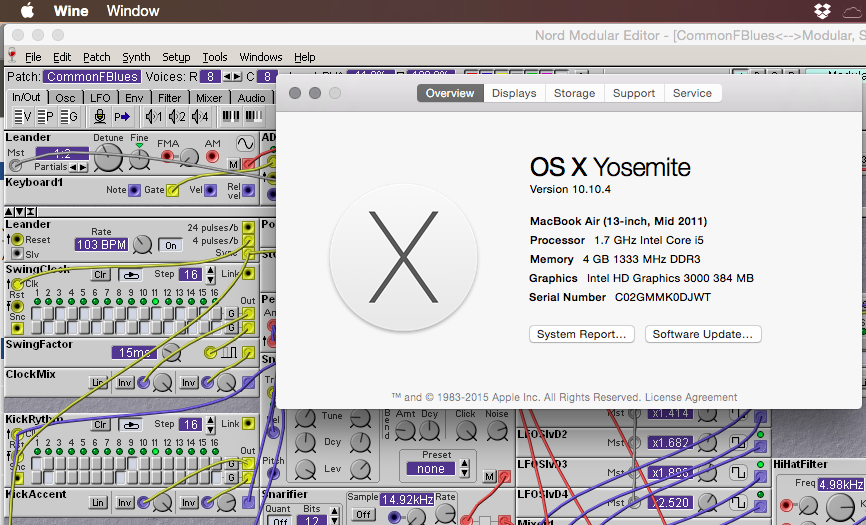

Well I can confirm IT'S WORKING! Laughing Cool
Editing a ProCussion w. SoundDiver v3.0.5.4 (not available through any legal means as far as I can tell) on 10.6.8 at the very moment!
Setting up (installing homebrew, git and building wine) takes some time - follow the instructions carefully and it'll be ok.

OK, just went to the installation steps and the editor launches perfectly. I can load and save patches, all looking perfectly normal. Now only my MM needs to arrive Wink
If anyone needs help getting this to work, I'd be happy to answer questions within my capacity.

tinez wrote:
Hi everyrone. Since this is my first post - a short introduction. I play bass, piano and have a lot of love for synths. Professionally i'm a software developer.
I'm also a very happy owner of G1 since about 3 months. I used to run NMEditor using wine on linux. If you're not familiar with wine you can check their website http://winehq.org. It's not a virtual machine and it's not emulation - it's rewriting of win$ libraries on different operating systems. That means when you run NME on wine, you run it like a native OS X app.
I was pretty angry to find out that running NME on wine on OS X didn't work. It turned out, there was no sysex message handlers implemented in wines coreaudio driver. Two evenings later i have a patch and successfully run NME on wine on OS X Wink I'm pretty sure that G2 editor will also work - I need some brave volunteers to check that Very Happy
Ok, here's what you gotta do to make things work:
1. install brew (http://brew.sh/), remember to run brew doctor and brew update afterwards
2. edit /usr/local/Library/Formula/wine.rb file in your favorite text editor (or you can just run "brew edit wine" in terminal)
3. find section that looks like this:
Code:
stable do
    resource 'mono' do:
    end
end
and append url to my patch like this:
Code:
stable do
    resource 'mono' do:
    end
    patch do
        url "https://raw.githubusercontent.com/tinez/patches/master/wine/winecoreaudio_sysex.patch"
        sha256 'a4a91359ecce2a3fbaf559c692f374e9c6bcdbec50b75c01868dd26f6214fa33'
    end
end
4. brew install --build-from-source wine
5. download win$ version of NMEditor
6. run it by typing "wine Nord Modular Editor File Name.exe" (i can't remember the exact filename... ;P)
If you don't trust me, you can take a look at the patch. Just go ahead and open it in your browser. If you want to try this solution out, but something doesn't work for you, write me a PM, i'll be glad to help. Finally - happy patch editing!

PostPosted: Fri Oct 09, 2015 7:15 pm    Post subject: Re: Nord Modular Editor on OS X using wine
Subject description: NMEditor running on OSX 10.10.4
This is great, Tinez. Nord Modular Editor running on a MacBook Air with 10.10.4!
Thank you very much!
