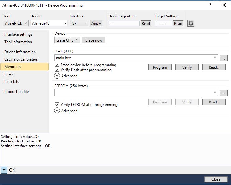

There are two ways to compile and transfer the data, since I only have studio 7 I will upload some screenshots from this version, but I think they are quite similar.
Ok, once you have your project ready you can either click on Build >> Build Dredrum
Now the code is compiled, now click on the icon with the flash:
and a menu is opened:
Where you can set your processor, isp clock frequency etc.
If you read your device signature right you may proceed to clicking on Memories:
Just click on Program and that is it.
Another way of compiling and flashing is to click on the play button:

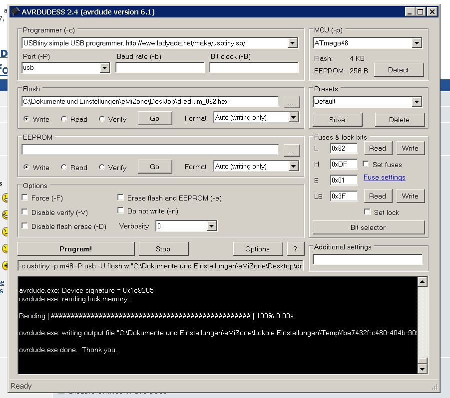

PostPosted: Fri Sep 07, 2018 6:14 pm    Post subject: Reply with quote  Mark this post and the followings unread
Grumble wrote:
you could try to use one of the hex files I provided Cool
yeah your hex file worked. i used a program called avrdudess 2.4
[img][/img]
i´ve tried it without setting the baud rate and bit clock.
the interface seems to work the leds light up when i push buttons
but the sound is very distortet it seems like it where totaly pitched down.
i think it must have something to do with the external oscillator.
dredrum uses a 20mhz quarz oscillator. do i have to set the baudrate or the fuse bits correspondending to this?
i have a very high very loud beep tone all the time on the output and the voice from the module is pretty quiet.
or is there a difference between atmega48 and atmega 48p? i have atmega 48 without p.
 Filesize:  42.19 KB
 Viewed:  412 Time(s)
Posts: 1319
PostPosted: Sat Sep 08, 2018 2:34 am    Post subject: Reply with quote  Mark this post and the followings unread
I have compiled it using the settings for an atmega48 (without the p)
But I don't know the meaning of your fuse settings:
So I can't tell really, could you make a screenshot of the fuse for the clock generation?
You should choose something like "external full swing crystal" and uncheck the fuse for low.ckdiv8, but make sure you leave high.spien CHECKED!!
HERE you could look at the calculation for the fuse settings.

Joined: May 16, 2018
Posts: 20
Location: germany
PostPosted: Sun Sep 09, 2018 2:07 am    Post subject: Reply with quote  Mark this post and the followings unread
yeahah Smile it finally works. thanks for your help . Very Happy
used the fuse calcutor tried some values for full swing oscillator and unchecked clock divide by 8 and disabled internal oscillator output.
HUGE THANKS
