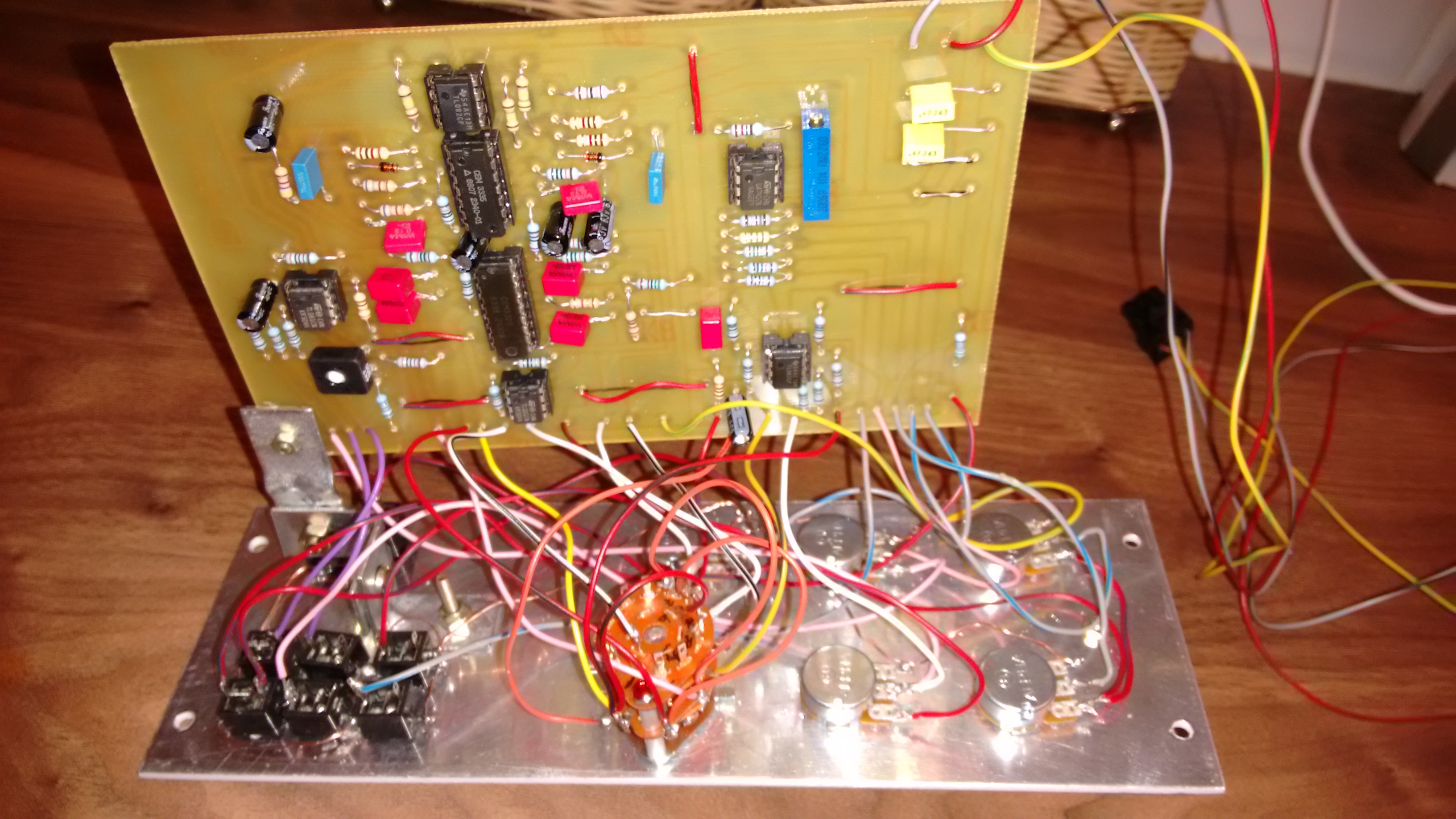

Hi
Need some help with my latest module a Digisound 80-7a
I cant get this one to work so would any one like to help me by taking a photo of the pcb off a working module so I can compare with mine
I have used the one off http://www.digisound80.co.uk/digisound/modules/80-7.htm
and have found some errors but still cant get the damn thing to work and dont want to risk blowing the CEMS
Thanks

Are the PSU voltages ok (when measured on the module)? Maybe pull the CEMs and check the voltages first.
With the module unplugged can you check whether there is a short from each rail to ground?

Have all the correct voltages at each chip now but when I first powered up I was getting +29/-2.7 volts on areas of the board so I turned off quick and checked the pcb. Found a pcb fault and his has been has been corrected.
I can get sound through the circuit but sounds like its being overloaded by the signal in if that makes sense also the pitch of the VCO is being affected when the cut off pot is moved , I have checked and rechecked the pcb and wiring but as yet can find no other faults I have 2 more 3320s but am loath to fit them in case I blow them as I suspect the original 3320 fitted has died.
I will post some pictures soon
Thanks

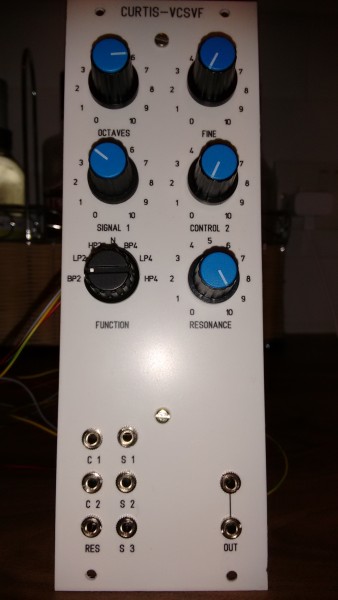

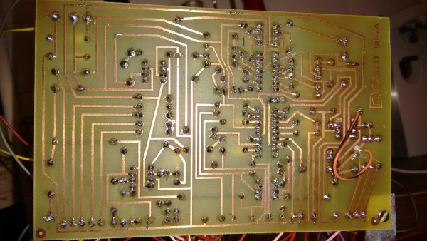

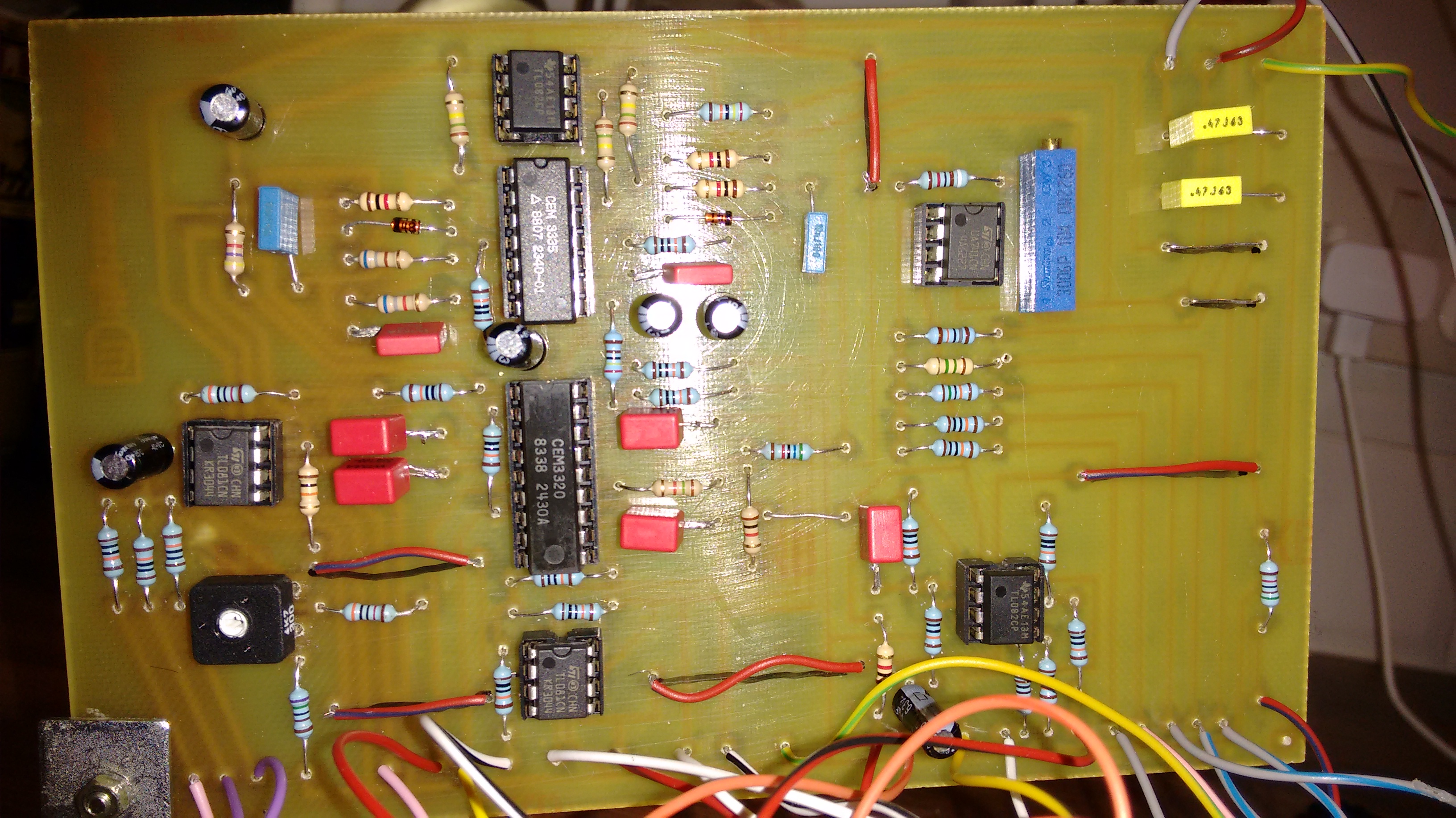

PostPosted: Sun Mar 20, 2016 12:32 am    Post subject: Reply with quote  Mark this post and the followings unread
F*** F*** F***
Lost my 0v on my connectors strange how it happens just when I plug in a new module.
Any way tried again and still no luck can get a signal through it on some switch settings resonance seems to work but in a strange and reversed way[[/img]

That sucks, did you etch the board yourself? Did you check for shorts?
Troubleshooting sucks man, but in the end it usually is a "doh" moment.

PostPosted: Sun Mar 20, 2016 6:28 am    Post subject: Reply with quote  Mark this post and the followings unread
Hi
Yeah etched myself did check for shorts before I put the ics in all metered out ok
I have been playing with my scope and seem to get signals where I am supposed to just unable to get a good output
Think the CEMS may be dead!!

But with no IC's inserted, the voltages are all OK right? No short on the output pins of the IC's?
Should be OK to plonk in new IC's then.

Ive got one of those, sadly not reachable without much trouble (stacked PCBs behind fastened large panels of even more stacked pcbs) but the digisound documentation was spot on for me, only the switch wiring was a bit hard to follow and I seem to remember using a common points instead of assigned ones for ground and maybe another.
The only odd behavior is the notch, but they do explain thats its an unusual approach. Attenuator before is bypassed when notched.
Maybe list what errors youve found in case its an misunderstanding?
