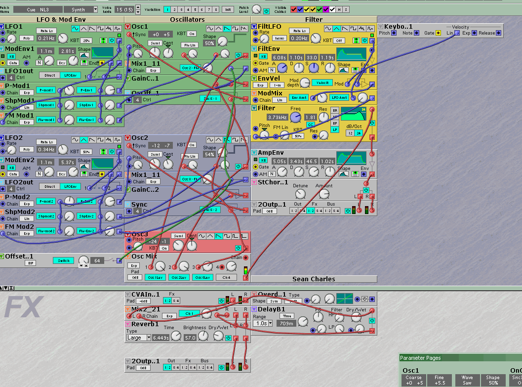

Here's a partial screen shot for an NL3 emulator from the G2 factory set. This gives 15 voice polyphony on my expanded G2.
Screen shot from NL3 factory patch
