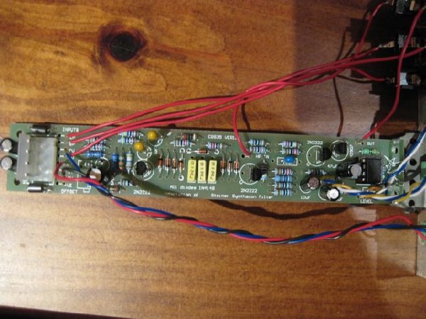

Hi, I seem to have a problem with my build and have tried everything I can to fix it, without success..
The issue is that both the frequency pot and the cv in do absolutely nothing. A saw wave into each input gets the expected result - lp in is definitely passing low freq signal and cutting the highs; bp gives midrange; hp in attenuates low frequencies nicely - but there is no modulation with cv! Also, I initially thought that the res pot was doing the right thing but on reading Ken Stone's info again it seems that it's supposed to boost signal - mine is attenuating it slightly as I turn up the the pot.
I checked the dc voltages per Ken's previous post and the points I can find easily seem within range - although my testing was less than comprehensive - are there critical voltages I can check to see what the problem might be?
I have checked every solder joint and reflowed a few. I have tried replacing the IC (twice). Shorting the +15 to either cv pad does nothing. I turned the trim pot all the way both ways - nothing. I removed the trim pot - no change (does the trim pot need to be there for the circuit to work - as far a I can see it doesn't but I am relatively new to this so..?)
My next plan is to replace all the transistors. Any other suggestions would be greatly appreciated.

PostPosted: Tue Dec 14, 2010 5:26 am    Post subject: Reply with quote  Mark this post and the followings unread
Check all your diodes are facing the right way. Adjusting the CV will make the collector of one of the two NPNs at the ends of the diode strings rise, while the collector of the other will fall.
There WILL be a construction error somewhere. It is very rare for there to be component failure.

Ok, so I checked the orientation of the transistors and confirmed that I was measuring the collectors - so they aren't changing as expected with cv. Still behaving the same as the measurements from my above post.
I double checked that the cv from the freq pot is going into the board and is modulated from 0 to +15V as I turn up the pot.
Does this point to a wrong resistor somewhere? I checked them all with a DMM before placing them, but if the symptoms point to that..

Increase the value of the 1k that is connected between 0V and the base of the first NPN. Go to 4k7. Also remove the 1uF across it.
If that still doesn't give you any voltage control, start looking elsewhere.

Done, and no change - still the same voltages as before at the collectors, and no audible change in frequency as I turn the pot.

Upload photos of both sides of the board if you can. I'll try to see if anything looks odd.

A minor breakthrough.. on a whim I swapped 2222A on the left of the diode chain to a bc547, and lo and behold, the frequency cv works! Although all is not right - the lp in sounds a lot like a bp filter and the bp gives a fairly convincing impression of a low pass filter. The hp in sounds right. And yes, the jacks are connected to the correct pads.
Also, the resonance pot attenuates the signal as I turn up the pot and there is no evidence of ringing/self oscillation at any point, even driven with a pretty powerful saw wave.
Intriguing? or just plain wrong? Confused

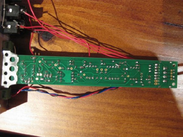

Yes well I know it looks like a pretty bad job, and it is (my first build since I was about 14.. since this build I have successfully put together about half a dozen modules) - the resistors are in either way (I didn't realise the convention of keeping them left to right) and I was probably a bit heavy on the solder.
Also, one of the pads lifted when I gave it too much heat so there is a blobby direct solder link between the leads of a resistor and a diode. Embarassed The multimeter says it's ok, and I have gone over the rest of the board thoroughly to check for bad joints or bridges. None found.
Also, since I wired it from the top it might be a bit hard to see all the components. Anyway..
Also note that I have taken out the trim pot and made the changes you suggested earlier.

There is a limit to what I can tell with these photos, but considering that, I can't see any problems. If you want to, you could substitute 2N3904 and 2N3906 for the transistors, though they would need to be installed backwards to the ones you have there (though I would check the transistors in a meter before installing , because there are some that have reversed pinouts).
If you have a friend that knows anything about electronics, have them give it a look-over. They may see something that you miss every time you look.
Did that, and.. Great Success!!
Sounds just like it should! Very nice! Just needs a minor mod as you have previously suggested, to get oscillation with the new transistors.
So I guess there was something up with the 2222As I originally had in there..? Whatever the case, I'm just glad it's working now!
