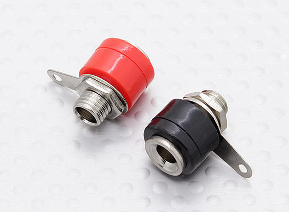

PostPosted: Thu Mar 19, 2015 4:35 am    Post subject: Reply with quote  Mark this post and the followings unread
I like this kind of jack because they are very inexpensive and the metal sleeve goes all the way out to the front of the plastic:
And then I use Aligator clip cables because a dozen of them are very inexpensive compared to premade bananna cables.

PostPosted: Thu Mar 19, 2015 6:32 pm    Post subject: Reply with quote  Mark this post and the followings unread
Those are the ones I use too! I have a supplier here in China that does them in lots of colours (even purple and brown!). I particularly like that you can route higher frequency signals through your skin by touching two points!
