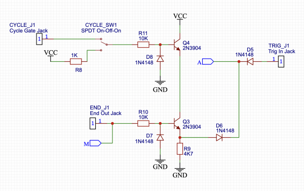

Here is the schematics for the CGS Universal Slope: https://sdiy.info/wiki/File:Cgs_schem_cgs114_dusg.gif
I was wandering if someone has added (and can share the way he does it) a cycle input to it that will cycle as long the cycle input is high (similar to the Make Noise MATHS)

Have a look at the schematic for the CGS 75. It's a modified USG with a cycle switch Smile

This was my solution - there's probably a simpler way, but this works. The "A" and "M" are as per the CGS114 schematic.
