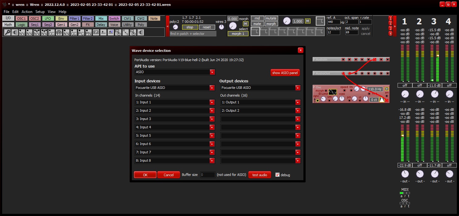

Hello @BlueHell and everyone else.
I tried my best to make external audio input work but I can’t get it done. Is it possible or am I missing something here?
Input itself is working as I can see the level meter inside Wren, but I cannot get a connection to actually hear anything. I tried patching the input module directly into the output module but even then… nothing happens.
What can I do and how can I solve this?
Thanks a lot for your hard work programming all this, it is so amazing.
Edit: I of course did assign the ASIO driver‘s in- and outputs to each in- and output to the individual ones in the menu. I use a Focusrite Scarlett and I use their ASIO. Even if I change the order nothing happens. What I forgot to tell is that the program crashes as soon as I start the audio test. Happens with any configuration and driver. But as I can hear the patches I thought that might be a tiny bug not too important for working inside the synth. Smile

PostPosted: Sun Feb 05, 2023 4:17 pm    Post subject: Reply with quote  Mark this post and the followings unread
Cheers Smile
First of all: Thanks for your reply to that absolutely noob-question.
Indeed as soon as I press "run" the input-meter shows that there is input on channel x (in my case input channel is 6, it wont work on 5 either.)
I took a screenshot, I hope it speaks for itself. I can hear the oscillator on channel 1 but i cannot hear any input audio from channel x (6) on output 1 or 2 as it is patched.
help
I feel dumb and a bit lost here Embarassed

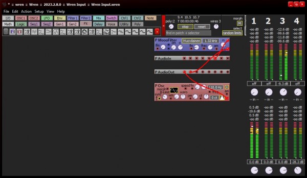

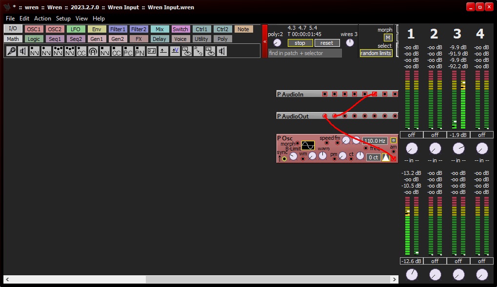

PostPosted: Tue Feb 07, 2023 6:03 pm    Post subject: Reply with quote  Mark this post and the followings unread
Hey again Smile cheers
You caused no confusion after all - I am happy to 'help' and test - I almost feel sorry for the inconvenience. Embarassed
After installing the full update (thanky for even revisioning without any delay at all - you really don't have to do that so quick btw) I tried to open the patch I took the screenshot of and I can say it works - partially.
Here's what I encountered: Directly after initial reopening and hitting run it works but as soon as I repatch the input cable (or add another module) it suddenly won't anymore. Even if I reconnect it to the same output again there won't be any sound at all. All I can do is completely reopen the pre-saved patch.
I provided you two more screenshots (I only shrunk the screen width for the shot)
PS: One single time I could (somehow) manage to make the oscillator go nuts, sine being way too low in volume, saw being too high and square running even at a different frequency drunken

Just made another new release (2023.2.8.0) to fix the rewiring issue.
These were artifacts intruduced the new (a tiny bit more efficient) way of signal propagation in patches that i did a while ago.
It used to be that all modules needed a fixup after the patch changed ... forgot that such is still needed for the input modules in a patch and that such is also needed after rewiring and not just after module addition / removal.
As to the oscillator going soft : with a voice count greater than one this can happen as the oscillator phase is random and the different voice signals will be summed before sent to a physical output.
When the phase difference happens to be 180 degrees there will be no output at all.
With a little random modulation of the phase or frequency of the oscillator this will be gone (and it will make the sound more lively too Cool ).
For the saw and square remarks, as well as for the non-crashing of audio testing : I have no idea what could cause that or how i could try to reproduce the issues (I do not have proper ASIO anymore since my RME interface broke down, using a cheap Behringer thingie for now).
