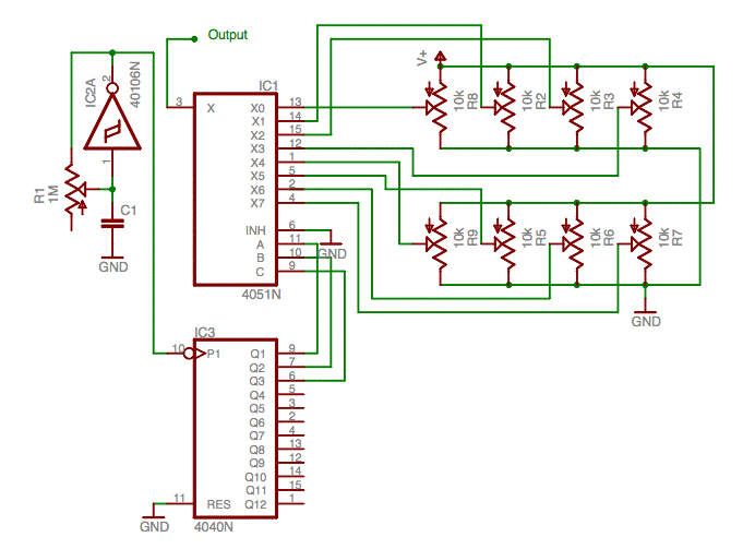

So i ran accross an Eight Stage Custom Waveform Generator and liked the sample posted on their site... http://milkcrate.com.au/_other/sea-moss/#sound.
I decided i wanted to use my 4017 step sequencer to control the 40106 based Waveform Generator, but need some help doing so. Any suggestions?
Here's the schematic i'm working with.

check the lunetta forum for my 40106 vco

Should i put the trigger out to the 4040 or the falling ramp out? I haven't had time to test this out yet (i'm at work). Thanks for the reply!

trigger will work fine.

peep this:
http://electro-music.com/forum/viewtopic.php?highlight=wave+form&t=29742
it's an old custom wave form generator that clocks a 4017 really fast with a 555. It also uses 4066 i believe
if your experiments with trying to swap the 4051 with the 4017 dont work, i'd suggest giving it a try.
