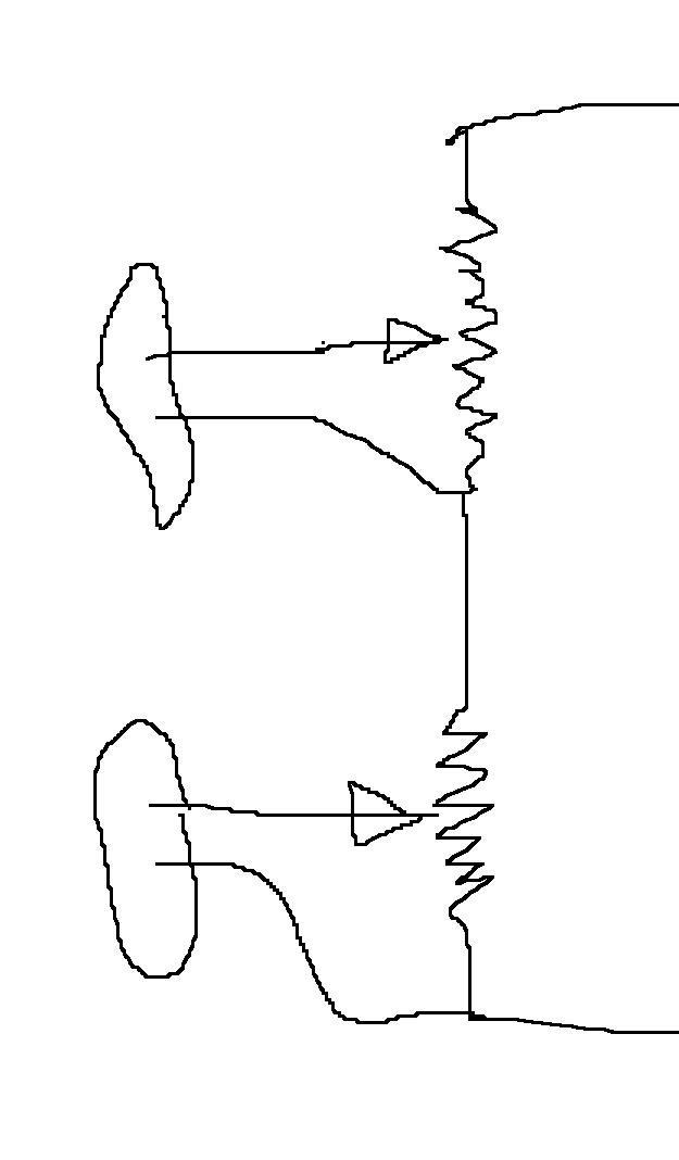

What about two parallel-pickup/pot combinations in series?
Using 500K log pots. When they were both wound out it would almost be like the pickups alone across the output. I hope. Smile
Looks like this,...
 Filesize:  6.14 KB
 Viewed:  213 Time(s)
PostPosted: Sat Jan 31, 2009 10:55 pm    Post subject: Reply with quote  Mark this post and the followings unread
Filling in a broken wire, and inverting one of the pots, this is what I found out from the original wiring. I must admit that there doesn't seem to be alot wrong with this configuration. The only thing I don't like is that you can't get both on full. There's always a compromise between the two pickups. Is this a bad thing though?
What do you dudes think? Stick with this?
 Filesize:  4.03 KB
 Viewed:  250 Time(s)

PostPosted: Mon Feb 02, 2009 3:44 pm    Post subject: Reply with quote  Mark this post and the followings unread
Here's the same pic with more details.
I'm fairly sure the 10K Log pot needs to be a linear one.
What do you guys think?
Should I check the DC resistance of the pickups? Yeah, I think I will JIC.
 Filesize:  7.24 KB
 Viewed:  206 Time(s)
PostPosted: Mon Feb 02, 2009 8:16 pm    Post subject: Reply with quote  Mark this post and the followings unread
Okay, I've changed my mind again. It should be a Log pot.
I've dicovered a bigger problem though. The main reason he wanted it re-wired is that the 10K pot "seems" back to front. Because,... he's got those gold hat type knobs which show "10" when the pot is fully counterclockwise.
So,... short of finding a 10K antilog pot (I don't like my chances there!) I think I should sub a linear 20K with a 20K resistor around one side to simulate an antilog pot. This actually could result in a far smoother log response than you can get from any "log" pot anyway.
Does that make sense to anyone else? I hope it does.

PostPosted: Tue Feb 03, 2009 7:50 pm    Post subject: Reply with quote  Mark this post and the followings unread
I just found out (from a guitar site) that the reverse pot concept (pickup to wiper, full value across the output) is fine, and is the way jazz bass wiring is done. When the volume is up you have a much smaller impedance (the pickup) across the output, and you want the pot to be in the region of 250K-500K anyway so that you don't lose too much top end to ground.
So now I'm thinking of trying that with two 500K linear pots. A fixed resistor (about 680K) between the wiper and the top should logarise(?) the control.
Man,... I never thought getting this stuff right would be so fraught with hard decisions! Laughing
