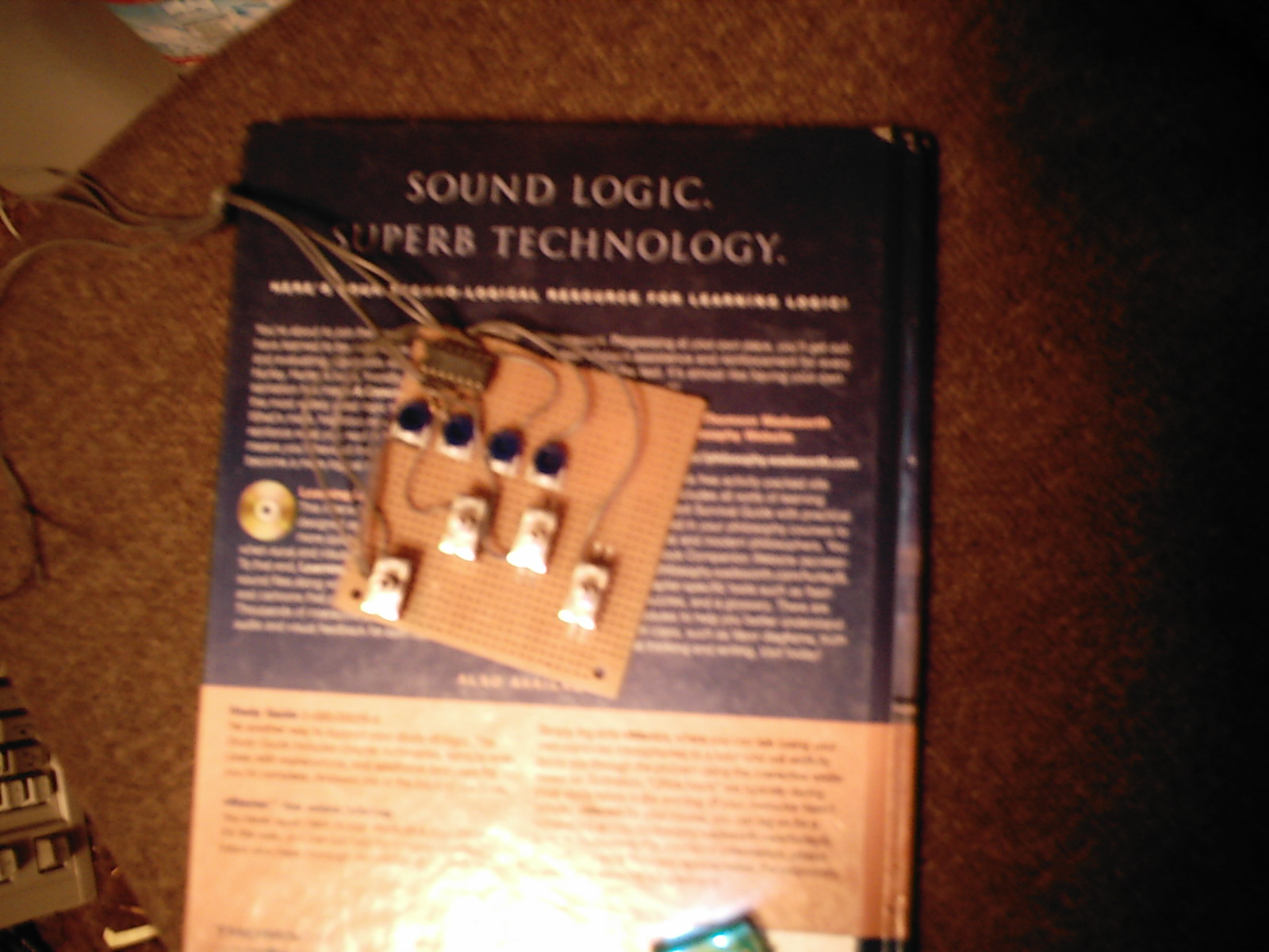

Here's my voltage summing setup. Has a few advantages, it's dirt cheap, mindlessly easy to build and requires a minimum of components. It's also very compact, you get a little more than an octave (15 notes) using just four switches (theoretically it could be doubled, giving you 255 notes with 8 switches). With decent trimmers (I only had some garbage one-turn ones to experiment with) and some tweaking on the summing/inverting opamp stages it should be possible to get fairly accurate 12 tet tuning out of if. I call it The Left Hand of Creation after a line from Doom Patrol.
Also a pic of what it looks like assembled on perfboard minus the opamp.
