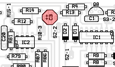

radfaraf wrote:
I can tell off of the schematics but I'm wondering if the PC Board layout is made in way that also easily tells this, since it's much easier constructing from this.
Hi radfaraf
the following caps are polarization critical
C16 & C18 those are most likely the soda can shaped ones rated at 100uF
and C3 tantalum cap rated at 2uF
in the Printed Circuit Parts Legend positive lead are indicated.
hope this helps
daniel
