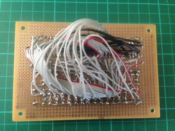

4067 16-step sequencer
The four-bit binary count top left determines which channel is active. Next to it is an inhibit pin, and then the common input/output. The top row of each double row of 16 pins is connected to the mux channels so can be used as a standard mux. The main usage I envisage, though, is as a drum sequencer: you set up your pattern with jumpers and feed a trigger into the common input, then you can get four different trigger patterns at the single pins on the end of each row.
Stupidly I did not realise I would need the diodes to prevent the four patterns interacting until I had built it, so I'll need to fix this when I get some more 1N4148s. Alternatively the pattern rows could be female headers and I could use diodes instead of jumpers...
 Filesize:  17.82 KB
 Viewed:  462 Time(s)
 Filesize:  145.86 KB
 Viewed:  418 Time(s)
 Filesize:  151.87 KB
 Viewed:  394 Time(s)
