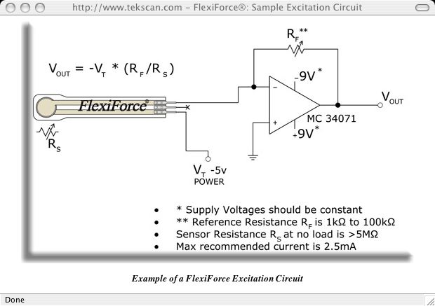

Instead, I can just hook the sensor up as the lower branch of a voltage divider and use a 470 k Ohm resistor for the other. These sensors require no parallel resistor as they begin sensing at 1 M Ohm and decrease to 50 k Ohms at full load, or lower for higher force than 100 lbs. The conductivity is linear with force, so the resistance has a 1/F shape to it. The divider approach produces output signal from 1V to 3V in a mostly linear transfer function (OK, kind of curved but good enough).
So far that's the circuitry plan, so one sensor at the "ball", or "toe" of each shoe, got the sensor model number (A-201-100), got recommendations for mounting the sensor, got interface, wiring is simple... I think the system is fairly well described, now I'll just think about it and determine a connector/wire harness and see if anyone offers more comments.
Joined: Oct 13, 2007
Posts: 6221
Audio files: 267
PostPosted: Sun Apr 13, 2008 11:55 am    Post subject: Reply with quote  Mark this post and the followings unread
The attached image shows FlexiForce's recommended driver circuit. It linearizes the response by varying the input current, and therefore the output voltage, with sensor conductivity. Really, this would be the best way to go for an interface.
I could hook the output up to a VCA such as my amplitude modulated sine wave oscillator that I posted a few months ago. That or any other sine-wave VCA would do. (I wouldn't want to introduce square waves into the system in case of any crosstalk.) Then I could set the different sensors for different frequencies and track them in ChucK.
This approach would eliminate the USB interface and instead would come into the computer as a combined signal on a second analog input channel. That way there would be a custom opamp circuit that replaces the USB interface.
In ChucK I could separate the signals with band-pass filters and rectify/LPF them to get a control value out of them (and put a time constant on their adjustment to absorb transients).
Just another way to go. Gee, I've got a lot of the parts for that approach, it may save $$. Interesting... Comments?

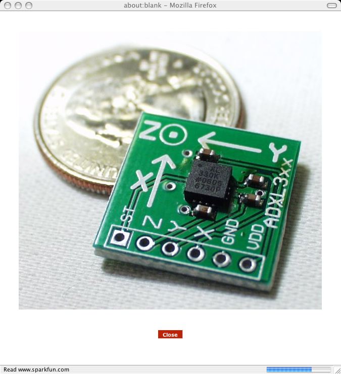

I've been thinking about accelerometers this evening, and I looked up what Digi-Key has to offer. Analog Devices makes an ADXL330 chip that sells for $12 and does three-axis sensing. It only requires four capacitors plus a voltage regulator to step down the +5V from the USB interface. It's very accurate and linear and all that jazz - the perfect little "point sensor" of acceleration.
Now here's the application. I mount one sensor at either end of the guitar, run a 5-pin cable between them, and connect to (all) the inputs of an Ultimarc A-PAC Version 2 USB interface. Then, run it to the PC with a USB cable. This clean, simple HID has no wires except those directly on the guitar so there is no "suiting up" of the performer - just grab your guitar and play.
We can then have a complete description of linear and angular guitar motion by integrating acceleration into velocity and then distance, and subtracting the two sensors to get pitch, roll, and yaw. Imagine a window with active MAUI pong elements representing the giutar in 3D space, and that image moving as the performer moves around on the stage, tracking the motion on the screen.

I've been studying the ADXL330 this morning. That chip is so small that I cannot possibly solder it. Fortunately, SparkFun Electronics sells a board for $35 each that has an ADXL330, the four capacitors, and a 0.1" header interface. That's a bit pricey for a $12 part on a mini board, but it is kind of specialized and necessary for the project.
The rest of the circuitry would consist of buffer amplifiers (if any) and a +5V to +3V regulator. Aside from that, it just wires up to the Ultimarc A-PAC Version 2 ($39), which plugs into a USB cable to the computer. Oh, and a button circuit is necessary for the two self-tests (well, optional actually).
I think the best place for the neck sensor is on the back side of the headstock in the center, and for the A-PAC a top-mount position behind the bridge where there is some open space on the front of the guitar. Same spot for the second ADXL330 and the regulator. Optionally, I could mount the far sensor on the back of the guitar body where the neck joins, just next to the bolt-on neck plate. There would still be enough distance to do the sensing properly and I wouldn't have wires running down the back of the neck. For that matter, it could be on a stick-shaped PCB on the front of the guitar. Just a few inches should be enough separation to make it work.
There is the possibility that the subtraction and double integration to get a distance and angle output could be done in analog circuitry on the front board. That may be necessary if the computer (and ChucK) can't keep up with the 50 Hz bandwidth of these sensors at 12 bits resolution. That could be an issue and will have to be worked out by trial and error.
Gee, this project gets simpler and simpler the more I think about it.
ADXL330 Accelerometer PCB, $35 each
 Filesize:  60.78 KB
 Viewed:  259 Time(s)
