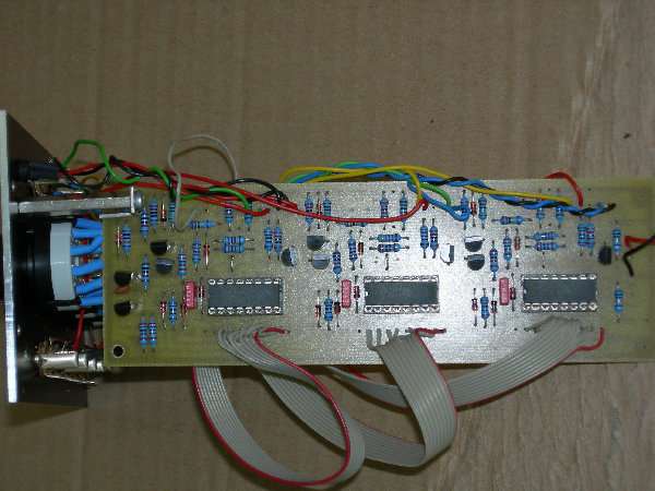

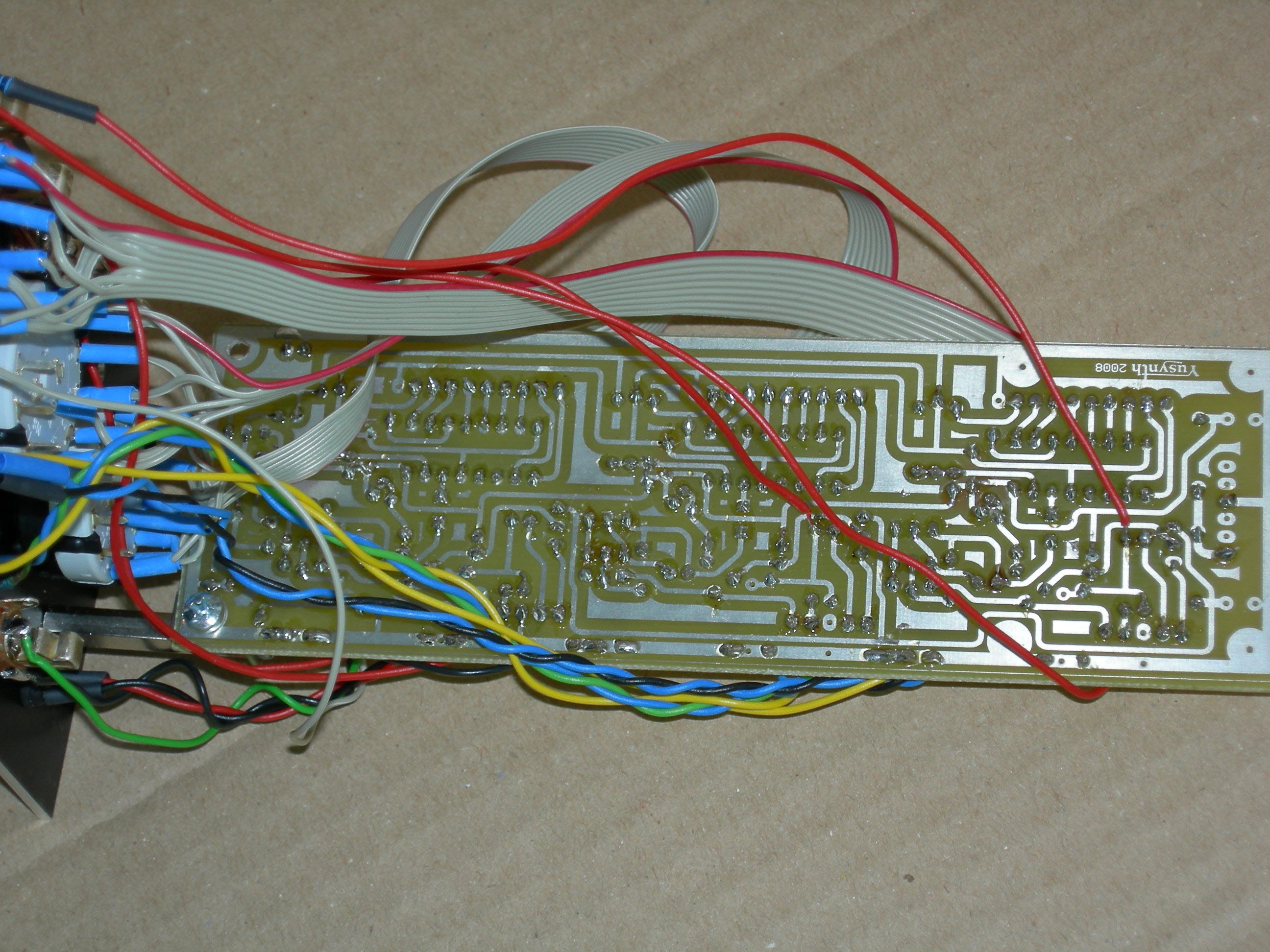

PostPosted: Sun Apr 19, 2009 9:43 am    Post subject: Reply with quote  Mark this post and the followings unread

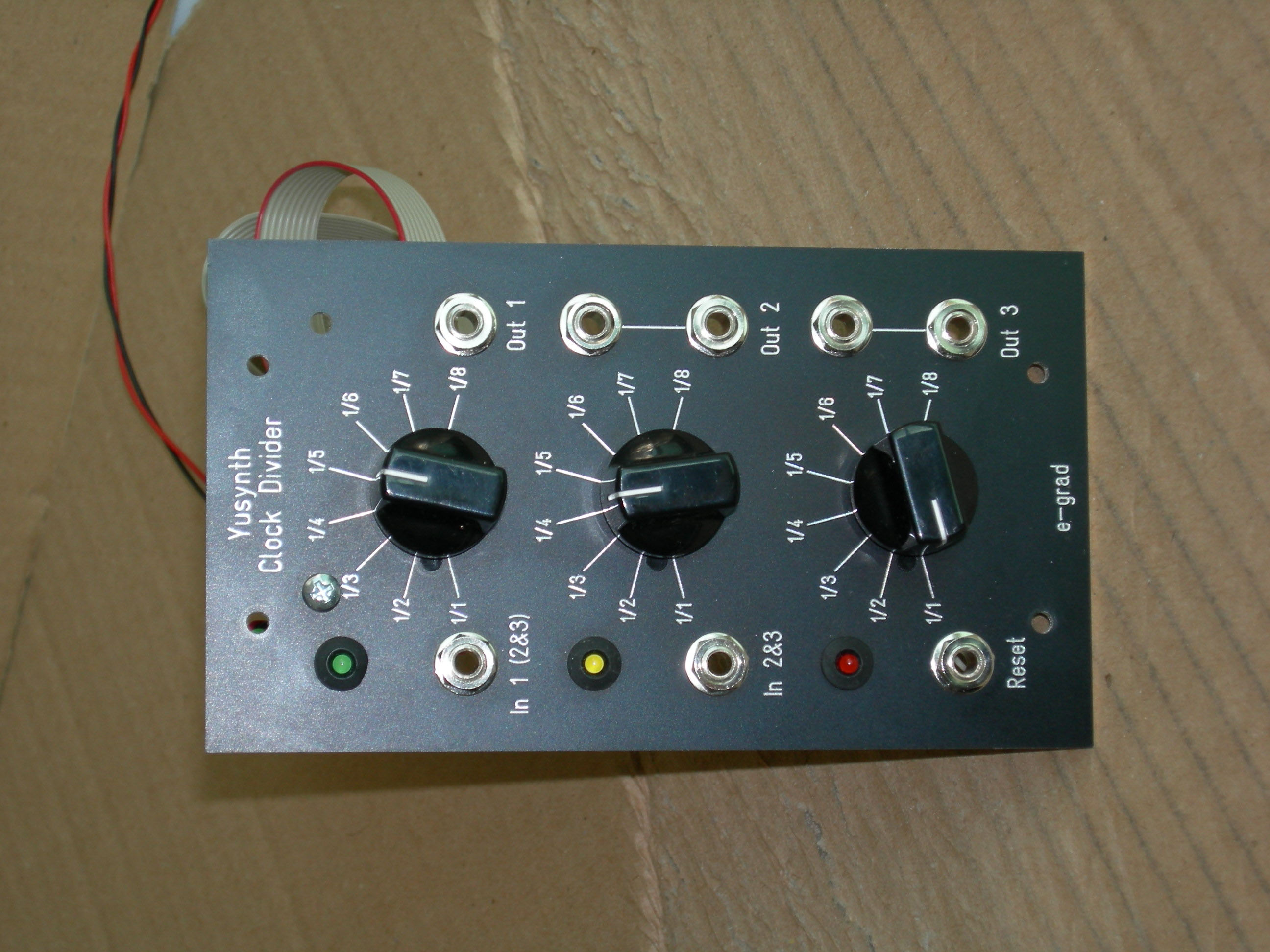

Salut Yves, I've managend to take some pics. Hope you like my frontpanel and if you can spot the mistake even better.

yusynth
Joined: Nov 24, 2005
Posts: 1314
PostPosted: Sun Apr 19, 2009 9:49 am    Post subject: Reply with quote  Mark this post and the followings unread
HI
I'll check your PCB ...
By the way the link on your panel (3rd image) is broken... Crying or Very sad
Yves
e-grad
Joined: Sep 12, 2008
Posts: 142
Location: Berlin
PostPosted: Sun Apr 19, 2009 9:56 am    Post subject: Reply with quote  Mark this post and the followings unread
On the first attempt I'd uploaded 4 pics which I changed the next moment. By now the panel should be visible.
