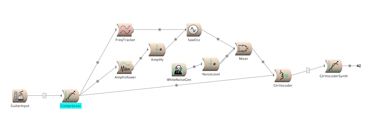

Well I have modified one of the samples slightly and come up with this.
Currently just working from a normal guitar 6 channel one from RMC to follow sometime.
Pitch and amplitude controlling saw osc wave and then vocoded with original guitar audio.
Sounds quite weird.
I think this Kyma malarky is going to be fun.
Andy

Got a screen capture of the patch? Interested in where the pitch and amplitude come from...

Pitch and amplitude are coming from the guitar via an Amplitude Follower and a Frequency Tracker. So the sound is being played by the guitar.
A Saw Oscillator is then mixed with some white noise and this is the input to a Vocoder which is then modulated by the original audio from the guitar.
Final stage is another compressor in the images this is called GtrVocoderSynth due to my misunderstanding of how to name Kyma patches.
Andy

Cool, thanks! Looks a lot like modules found in the Nord. I'd move the input to the amplitude envelope to the initial input, as some of those dynamics are probably lost in the compressor (I have that problem with my bass using env. filters).

Thanks for the tip, I will give it a go.

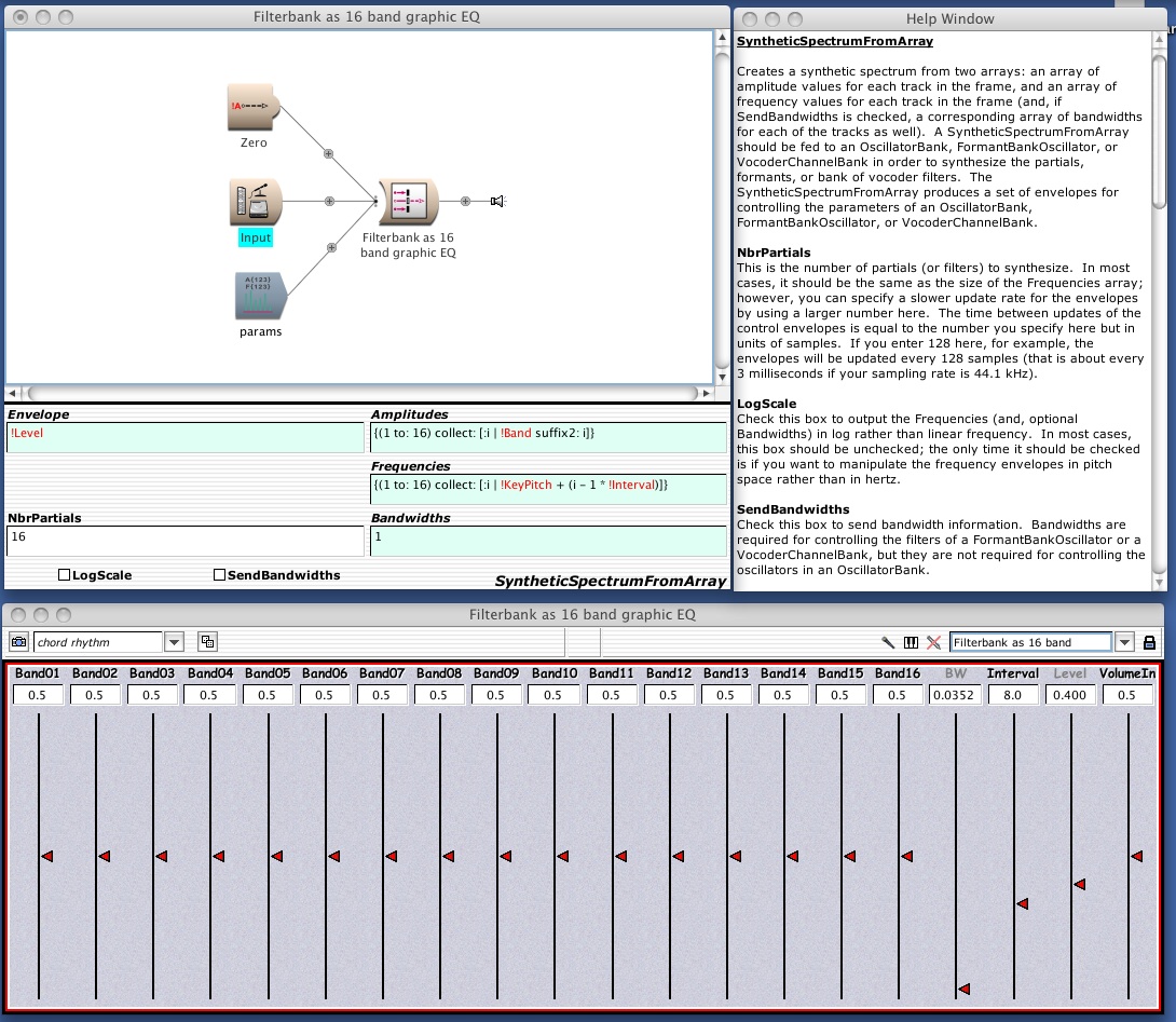

Well there is a lot to learn but I am not finding it hard going.
It makes more sense to me than the G2 does, much more than Reaktor and a huge amount more than MAX/MSP!
I think this is probably because it is more algorithmic in the way it works.
You can use SmallTalk scripts to set up sounds and parameters and even to create sounds, SmallTalk cannot run on the Pacarana.
CapyTalk is a way of having complex expressions that run on the Pacarana. This is used with "Hot" params that you can change via a gui or with midi. Hot params start with a !
SmallTalk and CapyTalk can be combined.
For instance the following could be used for an amplitudes parameter which expects an array, for example a 16 band EQ:
{(1 to: 16) collect: [:i | !Band suffix2: i]}
What this does in create 16 hot parameters, !Band01, !Band02, !Band03 .. !Band16 and place them in an array.
So the gui would have 16 controls (faders by default) which we can change via the mouse or midi to affect the values in the array on the Pacarana.
Staying with the 16 band EQ example we could set the frequency of each band as follows:
{(1 to: 16) collect: [:i | !FreqLow hz nn + (i * 4 nn)]}
!FreqLow is the start frequency and is a hot parameter that can be controlled via midi or a gui.
16 pitch values are generated from this, each one 4 half steps higher than the previous.
Or if we wanted to have each band of the eq seperated by a user defined interval with the base freq being defined via a midi keyboard note we could do this:
{(1 to: 16) collect: [:i | !KeyPitch + (i - 1 * !Interval)]}
!KeyPitch is set from midi and is a combination of the last note played and pitchbend.
!Interval is a hot param that can be set via a midi message or using a gui.
Now this sort of thing makes sense to me, but I come from a Software background, others may find it confusing.
So this 16 band Eq, with user defined intervals which can be "played" from a keyboard took a couple of minutes to knock together, image included.
Andy
