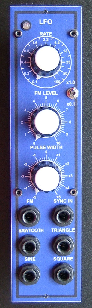

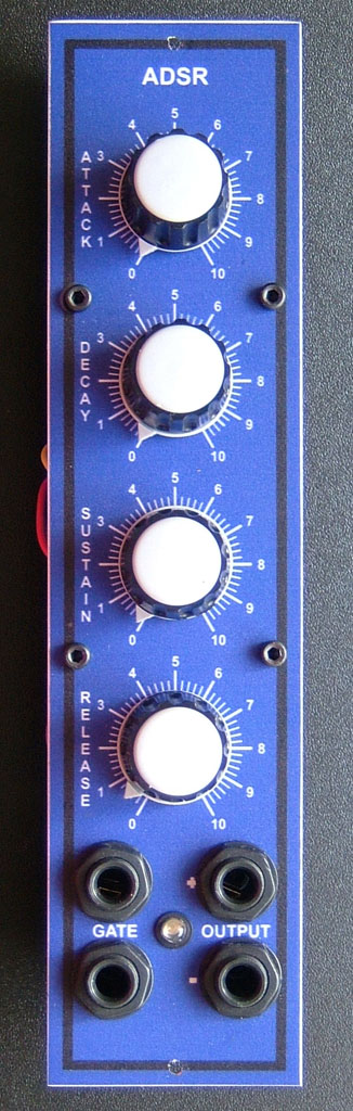

PostPosted: Sat Apr 04, 2009 1:22 pm    Post subject: Reply with quote  Mark this post and the followings unread
Some more modules finished...
ADSR
 Filesize:  133.43 KB
 Viewed:  382 Time(s)
ADSR
 Filesize:  123.05 KB
 Viewed:  340 Time(s)
LFO
 Filesize:  123.63 KB
 Viewed:  345 Time(s)
LFO
 Filesize:  118.43 KB
 Viewed:  337 Time(s)

yusynth
Joined: Nov 24, 2005
Posts: 1314
PostPosted: Sun Apr 05, 2009 12:42 am    Post subject: Reply with quote  Mark this post and the followings unread
I will add these ASAP in the modules' gallery of my web site. Thanks a lot !
Yves
