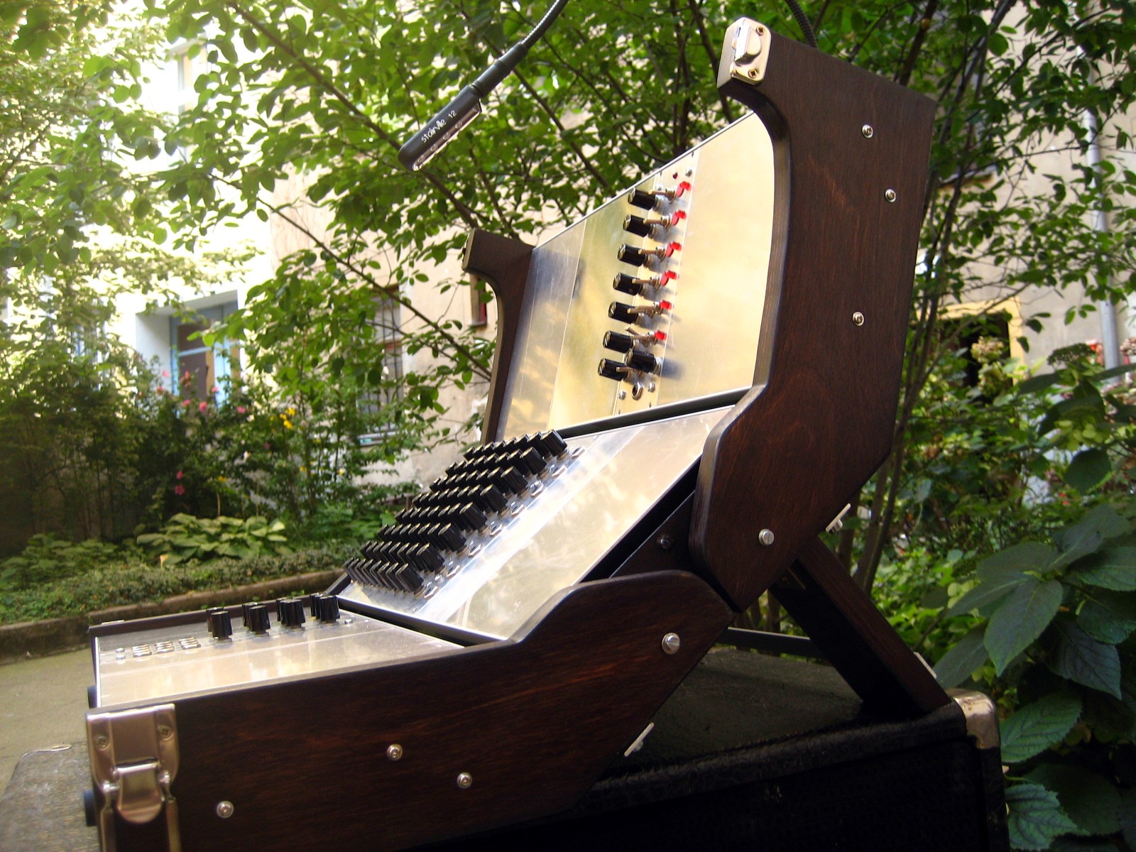

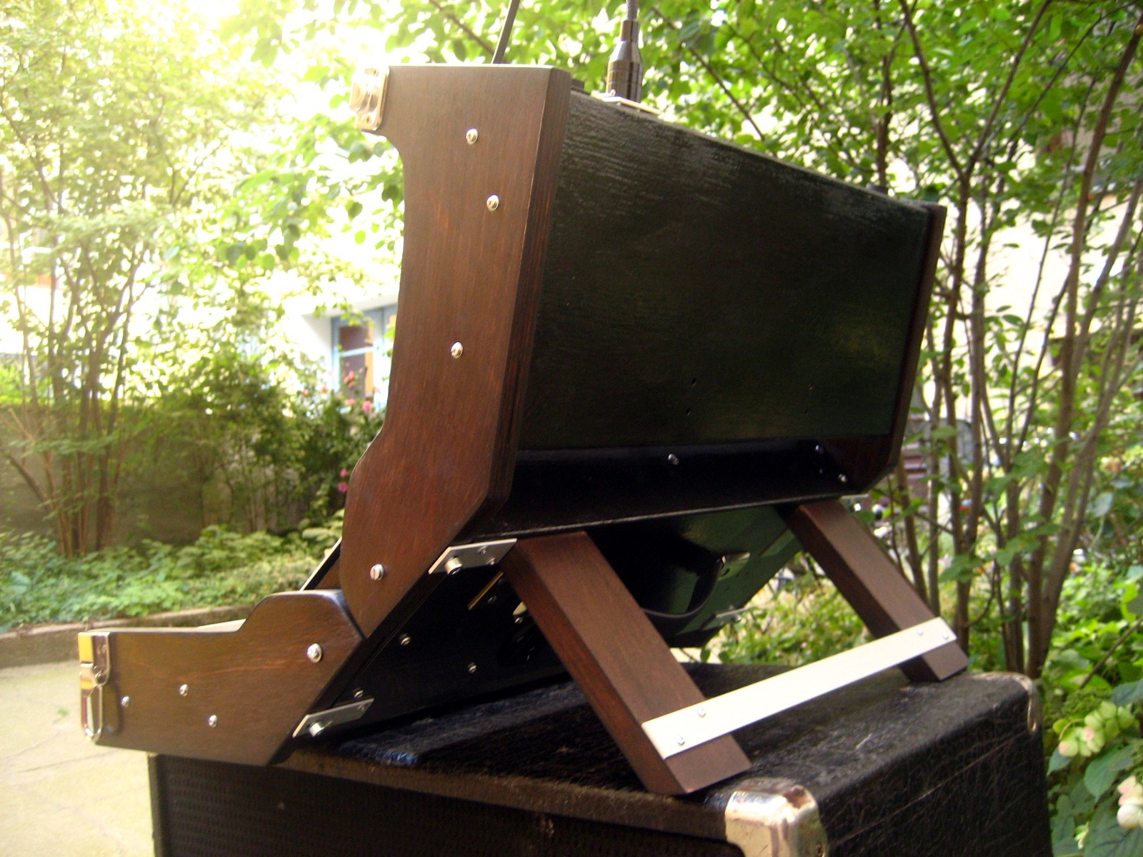

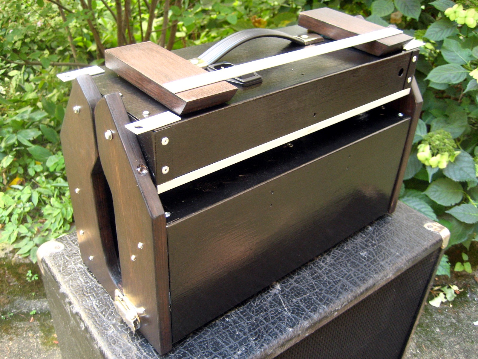

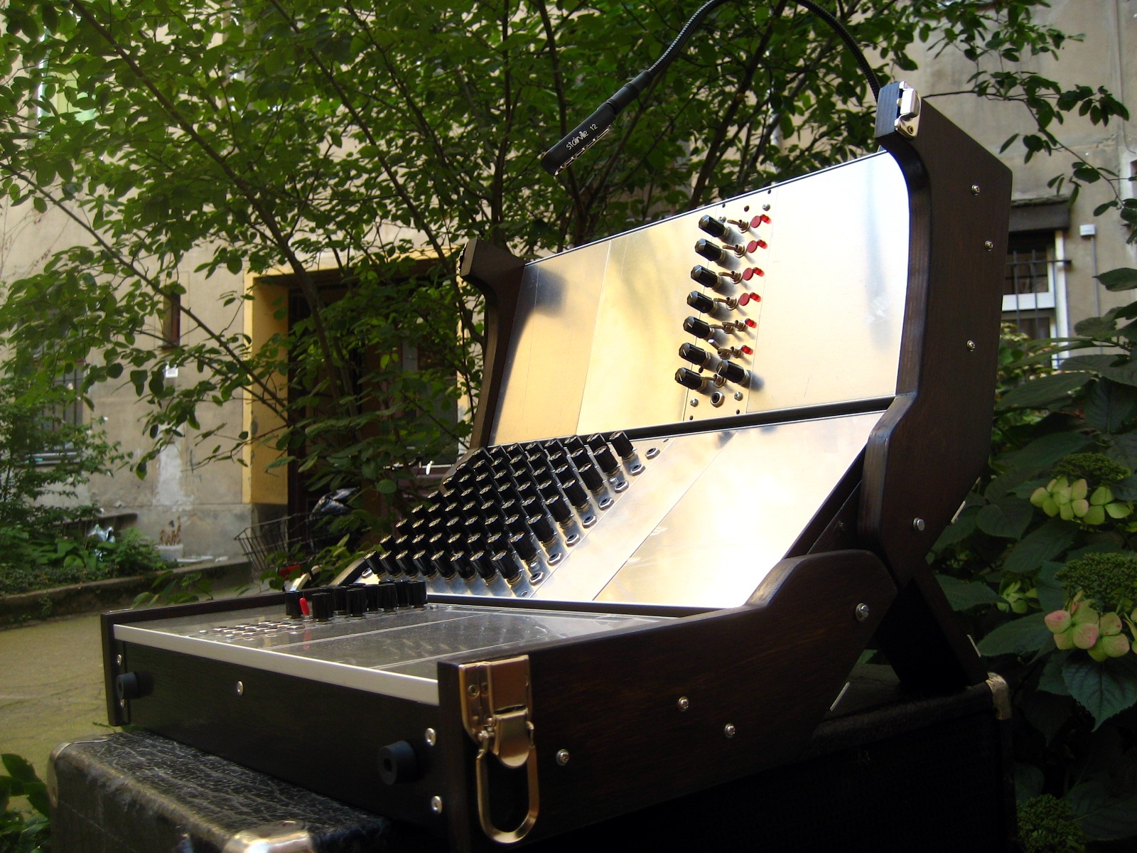

New photos! Still have a bit of internal wiring to do here, and I discovered that painting metal isn't really my forté, but that's life in the DIY world. Enjoy...

PostPosted: Sat Aug 29, 2009 5:07 pm    Post subject: Reply with quote  Mark this post and the followings unread
Uau, you artist Very Happy

PostPosted: Sun Aug 30, 2009 10:53 pm    Post subject: Reply with quote  Mark this post and the followings unread
Wow! This is the best DIY cabinet I've seen yet. Just outstanding--It looks perfect! What did you use for the boats? What product did you use for the hammered black paint on the boats?

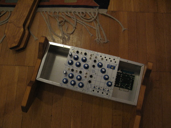

Here's a picture of my unassembled cabinet:
 Filesize:  1.2 MB
 Viewed:  604 Time(s)

PostPosted: Sun Aug 30, 2009 11:20 pm    Post subject: Reply with quote  Mark this post and the followings unread
@ ericcoleridge: Thanks thanks thanks. You're much too kind Wink I didn't even think that there might be ready-made boats actually...
I guess I should just go over the process of how I did this in steps:
    1--Calculated boat sizes on paper.
    2--Sheet steel purchased, cut and bent at Modulor in Berlin. Boats are made from 1 C-shaped section for the length and two smaller C sections for the end-caps.
    3--Ordered power supply from Curetronic.
    4--Drilled holes for screws/rivets, XLR gooseneck lamp and power supply.
    5--Designed wooden side panels on the computer in Inkscape (this was probably the most complex part, and I made a few different prototypes before I got the thickness and angle I wanted).
    6--Printed side panel design on A4 paper and redrew onto wood with carbon-copy paper.
    7--Cut wooden panels with electric scroll/decoupier saw. Cut wooden legs.
    8--Drilled holes and screwed in the locking mechanism in the side of the wooden panels (small set screws to keep the boats in place when the case is open).
    9--Sanded/stained wood panels + legs.
    10--Painted metal boats with Hammerite brand "Hammerschlag" black. I gave it several heavy coats with a brush, so the paint job is very rough. I kind of like that handmade feel, but if you wanted it to look more "pro" I'd recommend spraying. I would have liked to bake the finish to harden it, but I didn't want all my cookies to taste like paint afterwards Wink
    11--Assembled metal boats with Pro-forma rails. The boats and rails are riveted, however the handle, legs, latches, power supply, gooseneck XLR and side panels are all screwed/bolted.
I'll try to answer any other questions here when I have time for it...

Also, curious to know what material you used for the boats... you mentioned the boats themselves are pre-fab. Aluminum? How much does your whole case weigh (minus modules)? I'm wondering if I'll be able to keep mine within the 20kg (including Pelicase) allowed by most European airlines....
macumbista.net
lanxe
Joined: Feb 24, 2005
Posts: 102
Location: Columbus, OH - Now Carson City NV
PostPosted: Mon Nov 02, 2009 1:53 pm    Post subject: Reply with quote  Mark this post and the followings unread
yes, in the open position there are straps that bolt into the wood (actually into wood anchors made of steel....I tried brass, but it was too soft). Without these straps the case would stay open, but wanted to close if pressure was put on certain portions of the face. The downside is it requires one to bolt the straps in when in the open position, the upside is its rock stable.
The boats are the ones I think ericcoleridge was referring to from mouser. They are the 7"x17"x3" BUD prefab boats. They are great. The total weight is very manageable, I cant say the exact weight as I dont have a scale. But I will say that it is rather light and I dont think there would be any issues with taking it on a plane.
I may build another one with the knowledge that I have gained from this one. Some mistakes were made, and I am not completely satisfied with a few things. I never routed power between the boats either.
