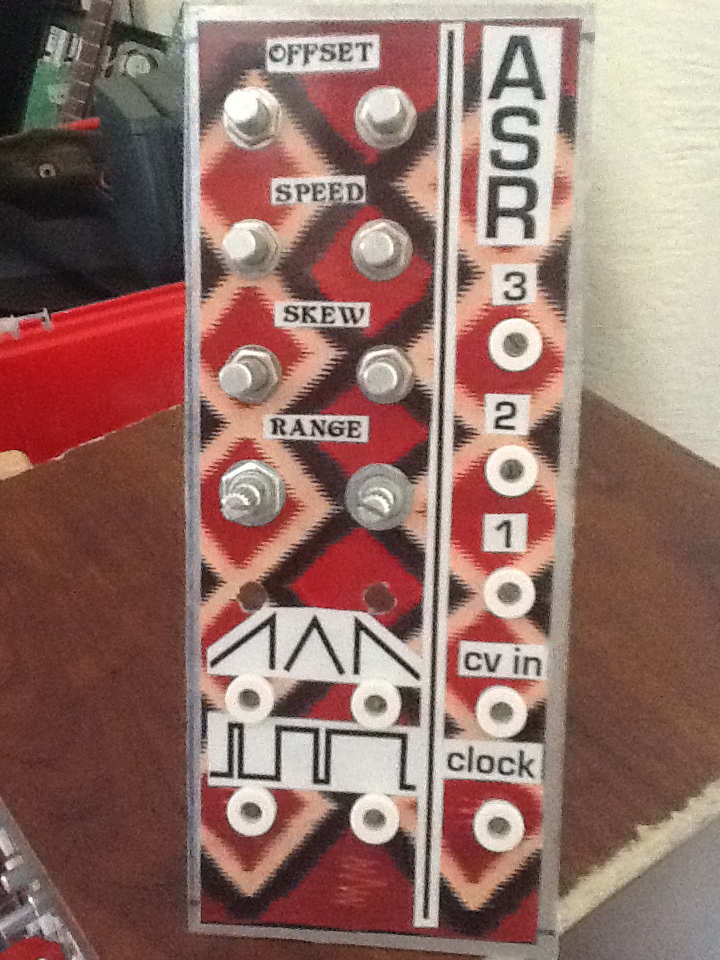

PostPosted: Tue May 22, 2012 1:14 pm    Post subject: Reply with quote  Mark this post and the followings unread
just finished a CGS ASR in the same panel as a Dual LFO (Peter Lutz's design from EN-89) and I love it! here's a pic and a video.

Another amazing build Phobos! Looks great.
And yours sounds awesome inlifeindeath.

PostPosted: Wed May 23, 2012 12:00 pm    Post subject: Reply with quote  Mark this post and the followings unread
I love it too. Beautiful sounds...

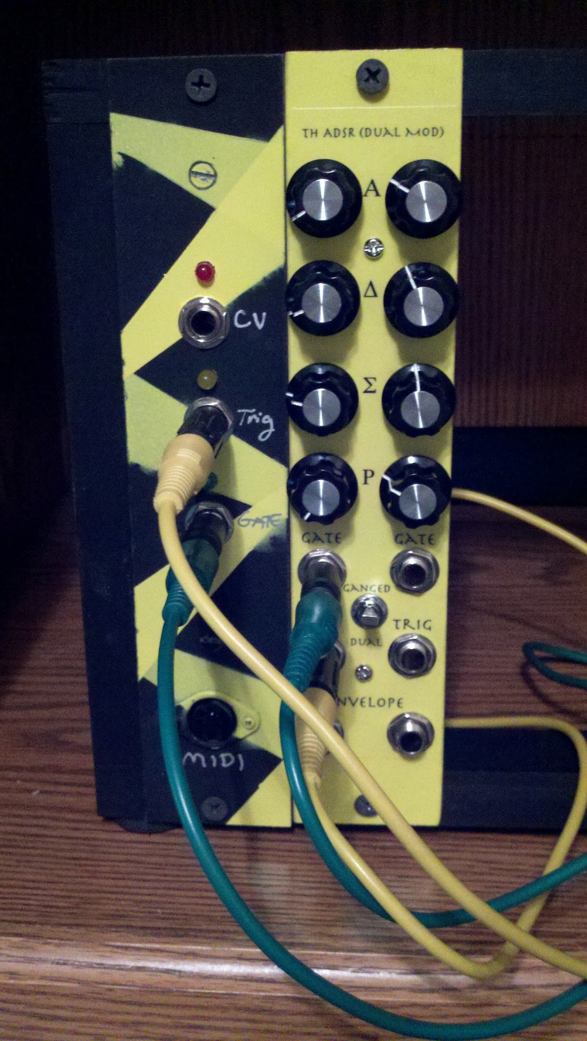

PostPosted: Wed May 23, 2012 10:11 pm    Post subject: TH Dual EG Reply with quote  Mark this post and the followings unread
Not quite so spiffy looking as several other recent entries (I *really* love the look of the jabberwock box; then again I'm not that good at drawing/painting), but a step forward nonetheless...you can compare the MTS-100 with the ADSR and see the steps forward. And plenty of learning for what not to do next time Smile
(I like to think this is the modular version of JingleJoe's ramshackles... Wink )

In the "rack" such as it is

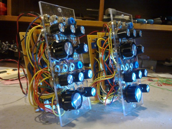

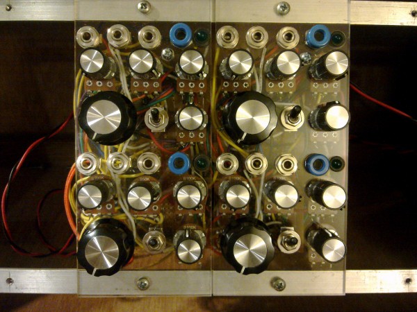

PostPosted: Tue May 29, 2012 8:09 am    Post subject: Reply with quote  Mark this post and the followings unread
I had twins (oscillators that is...)!
My first proper oscillator: a dual, variable pulse/ramp variety with plenty of in's and out's.
The core is based off of Ray Wilson's 'variable skew lfo' and was then completely bastardized for audio rate use, +/-4.5V rail power, and adapted for my control scheme (current control). I tacked on a cross fader to mix between the pulse and ramp waveforms and added an amplifier before the output (basically a vca...).
Controls row by row:
Row 1: Control signal out, Frequency control input, Amp. control input, Audio out
Row 2: Control out level/depth, Amp. gain, Waveform mix
Row 3: Frequency control, Frequency range (low, med, high), Wave tilt/pulse width
I was shooting for something along the lines of a buchla 258, and was happy with the way this design came out; lots of great fm and cross-mod opportunities!
Fun fact: there are four vactrols (hand rolled) per oscillator, so eight per module, or 16 between the two!

PostPosted: Tue May 29, 2012 2:13 pm    Post subject: Reply with quote  Mark this post and the followings unread
Adam, congrats on having proper VCOs and they look great. Cool

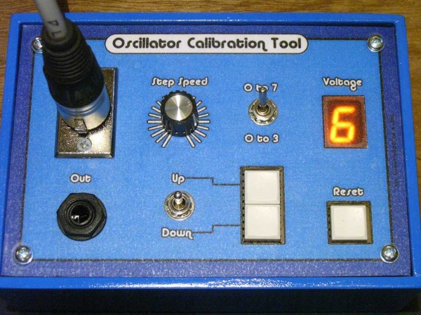

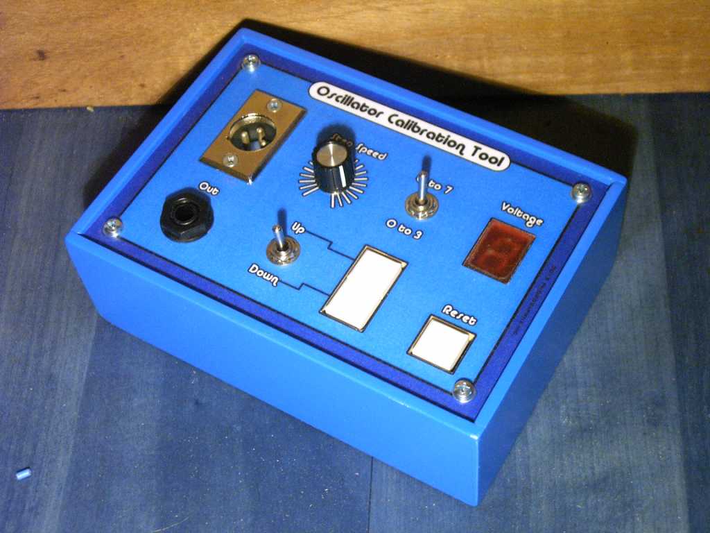

PostPosted: Sun Jun 03, 2012 12:29 pm    Post subject: MFOS Oscillator Calibration Tool
Subject description: PHOBoS mod
Dave Kendall wrote:
Of such rare and beautiful things are a wondrous childhood made......
Smile Lewis Carroll could have written that himself.
I just finished my modded version of the "MFOS Oscillator Calibration Tool". schematic can be found here

PostPosted: Sun Jun 03, 2012 1:26 pm    Post subject: Reply with quote  Mark this post and the followings unread
That's beautiful, Phobos...
I assume the DIN is power?

PostPosted: Sun Jun 03, 2012 2:15 pm    Post subject: Reply with quote  Mark this post and the followings unread
thanks Smile
and yes, the DIN or rather XLR input is for power and takes raw DC. there are two regulators inside. I use
the same system for my synths which have in and out to chain the power supply.

PostPosted: Tue Jun 05, 2012 11:16 am    Post subject: Reply with quote  Mark this post and the followings unread
PHOBOS....
That's a ravishing shade of blue you have there on the vco tuner Smile .
very nice build , i love the jabberwokky too , great design.
it's about time i started making some blue modules again , heh Smile
