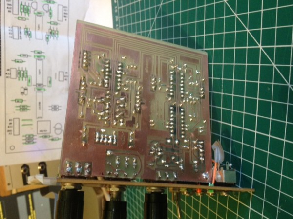

Posted: Fri Sep 06, 2013 4:19 am Post subject:
| Can you confirm if there a 3 or 4 wire links in the design?. There are 4 in the diagram but the text says 3 |
littlem4tt
Joined: Jun 30, 2013 Posts: 44 Location: uk
Posted: Fri Sep 06, 2013 6:23 am Post subject:
I have connected all 4 and all is good.
I have adapted the original design for eurorack 12v. (no modifications!)
Because the board is so long i used photoshop to cut the design in half and placed each half next to each other. And then re connected the breaks.
I also added solder pads for the pots so i could mount the board easily.
Thank you so much Yves for sharing. This is my second yusynth module and i have already made a clock divider pcb.

yusynth
Joined: Nov 24, 2005 Posts: 1314 Location: France
Posted: Fri Sep 06, 2013 7:07 am Post subject:
Nice eurorack adaptation  _________________ Yves |
