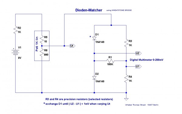

PostPosted: Fri Sep 11, 2015 4:16 am    Post subject: Matcher Reply with quote  Mark this post and the followings unread
Hello,
i built a diode matcher using the well known Wheatstone bridge. The circuit needs following parts:
9V battery, 1X 1K, 2 X 1K precision, 1X 100K, 1X Poti 1K lin, a pair of silicon diodes to be matched and a digital multimeter.
I have tested the circuit with LTspice and on a breadboard.
Matching here means turning the knob on the 1K-Pot and looking at the multimeter. If the diodes are equal, the multimeter always shows 0mV, otherwise not.
