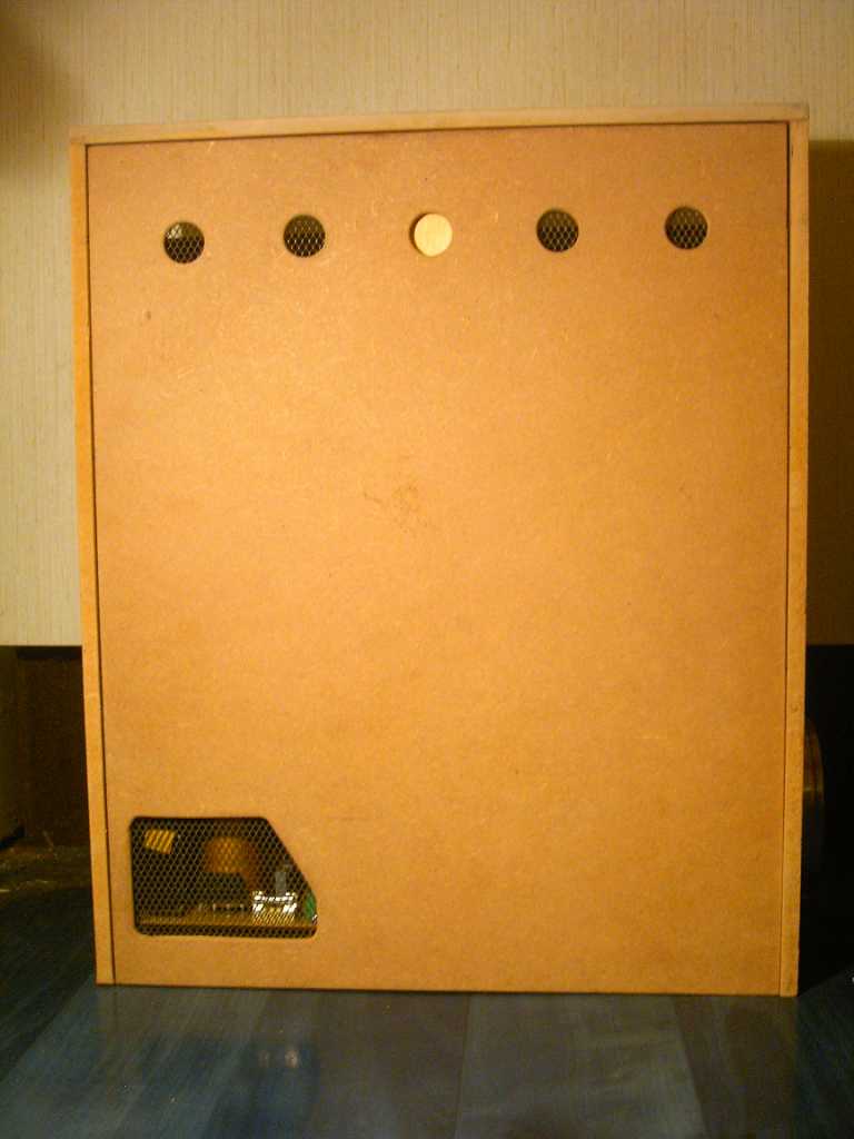

The Moon Base Xplorer Subject description: photos |
thanks isak
It is slowly starting to look like a synth but there's still a lot to do. I'm figuring out how to mount all the PCB's and how to wire the panels
together. The case is almost done except for a paintjob, and I installed a PSU.
I also needed something to store the connectors for the patch matrix and I was thinking about making a drawer of some kind of box in the case. But
then I noticed the magnetic storage containers (IKEA GRUNDTAL series) I got from my sister. The magnetic part isn't so interesting for my use since
it's not magnetic on the inside, but it has a transparent lid which is perfect for the logo I've designed earlier. So I drilled a large round hole in the side of the
case for that. (I happened to have a saw that was just the right size for a snug fit,. probably have to sand it a bit else it might not fit after painting).
here are some pics.
(can you spot my stupid mistake ?)

| RingMad wrote: | | I'm sure you'll figure out something for the patch matrix. Sometimes I wonder why patch matrices are not more plentiful... but's it probably because they are a pain to make! |
I think it'll work if not I could use the cheaper connectors I have that do fit. But those are made out of soft plastic and probably break fast. besides
that they don't look so nice as the other ones I have. (I could combine them if I'm a bit creative with some glue I think).
As of being a pain to make it depends on how you make them. I made mine a bit more complex by adding AND gates for the inputs and I'm
soldering the diodes directly to the sockets. And using those RCA jacks probably isn't the best idea. 1/4"jacks would be better but would make it
too large and from my personal experience 1/8"jacks are either expensive (you need a bunch) or suck.
| Quote: | | That "My god" image made me think of the monolith in 2001: A Space Odyssey a bit. |
I didn't call it my god (it's full of stars) for nothing
| Quote: | Nice "mise en scene" for your photos . Do you ever put little men inside your boxes, like Tim Hunkin? |
Those little men in the video are brilliant!
Muied Lumens actually mentioned putting an explorer behind one of the ventilation holes, which reminded me that I have that LEGO astronaut.
So I thought about it but the holes are too small and you can't really see it. (it's on the backside anyway) If I thought of it before I would have had
a nice space for it in the top panel. _________________ "My perf, it's full of holes!"
