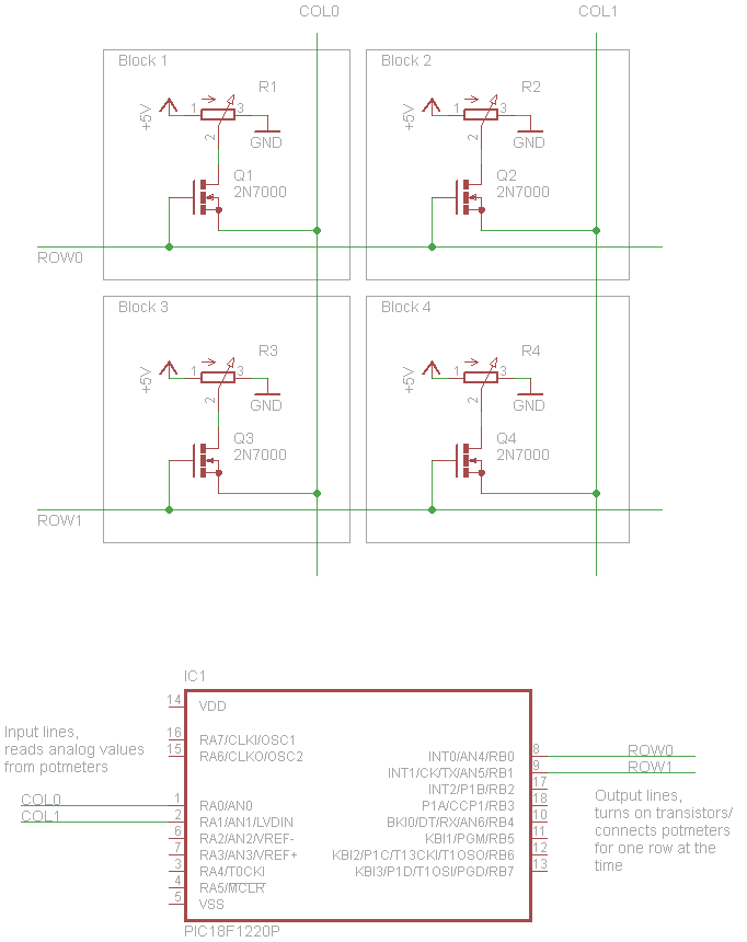

I am working on a little project, trying to build a module-based midi controller. The basic concept is that one can connect small blocks containing single controls (buttons, potentiometers etc) into a larger grid. Have a look at it here: www.controllerblocks.com
However - how does one make a scanning matrix for analog input devices?
The grid is scanned/time multiplexed by a microcontroller. This is easy for buttons, but seems to be conciderably harder for analog input devices such as potentiometers.
Had the pots all been connected to a single board, one could use a multiplexer such as the 4051 to select column to read at the time (using one 4051 per row). However, since the modules in my case only contain a single controller, there is no natural place to put the 4051 without having to run separate data lines to each module.
Instead, I am hoping to approach this in a manner more similar to the key scanning, where each module is self contained. My problem is that I am not very good at ANALOG design, so to get this thing off the ground I am in desperate need of some help
My idea is this: On each module, use a transistor as a switch to connect/disconnect the potentiometer viper from the 'column' data lines. Let the 'row' data lines turn the switch on/off. This way, one can turn on all the columns of a row with a single row data line, much the same way as one would scan the key matrix. Here is my initial design:
While this works _somewhat_, it does not work as well as I hoped.

- The row control signal (logical 0 and 1 from the mcu) reach about 4.7V when the supply voltage is 4.9V. This may be a problem because it is lower than the maximum voltage one wants to pass through the transistor
- I am hoping to use the supply voltage (+5V) elsewhere in the final circuit, so it should preferrably not be any lower than this. (But this may be changed if we have no other option - it could possibly be reduced to 3.3V).
Here is what I am seeing when I'm testing the circuit:
- When testing a single block, with potentiometer R1 is at the far left, input to the 2N7000 is about 4.9V. When row0 is 4.7V (logical 1 from the mcu), the output on COL0 is about 3.6V. I assume that this is because the transistor is not 'fully on'?
- When connecting two blocks (Block 1 and 3) and time multiplexing them, I can read two values on COL0.
- However, setting row0 to ON and row1 to Off (0V), gives me a reading of about 3.1V on COL0. In other words, the block that is turned off (Block 3) still affects the result.

I've googled a lot more and realized that the way the 2N7000 is mostly used is to connect any load at D to ground at the S, clearly not the way I've connected it in my schematics above.
I am still no wiser though. Really, what I want to achieve is a single cell / switch similar to that in a CD4066 (but with 0-5V supplies and the ability to pass close to 0 and close to 5V DC signals - is it at all possible)? |
